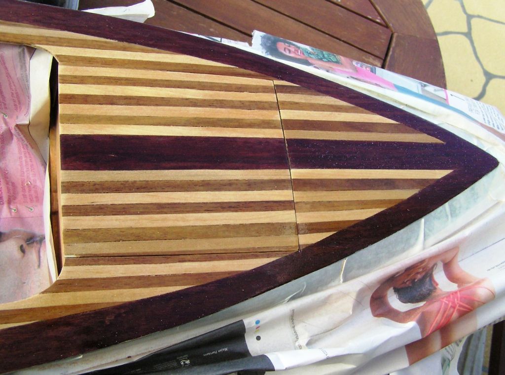

              #72844

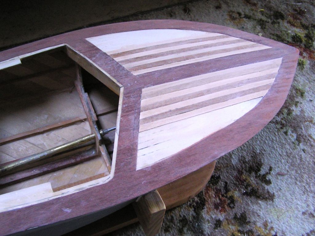

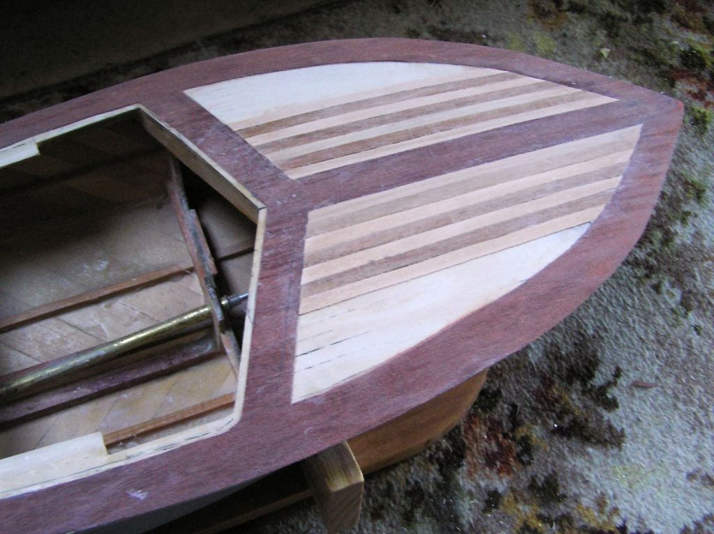

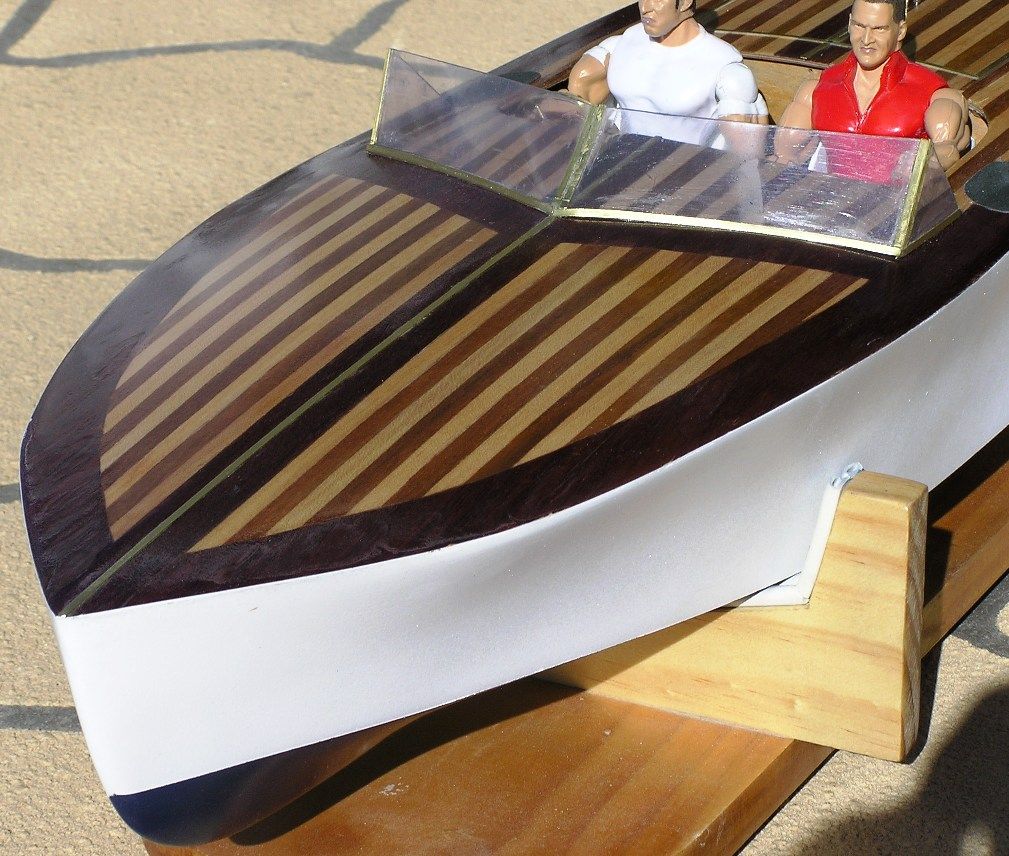

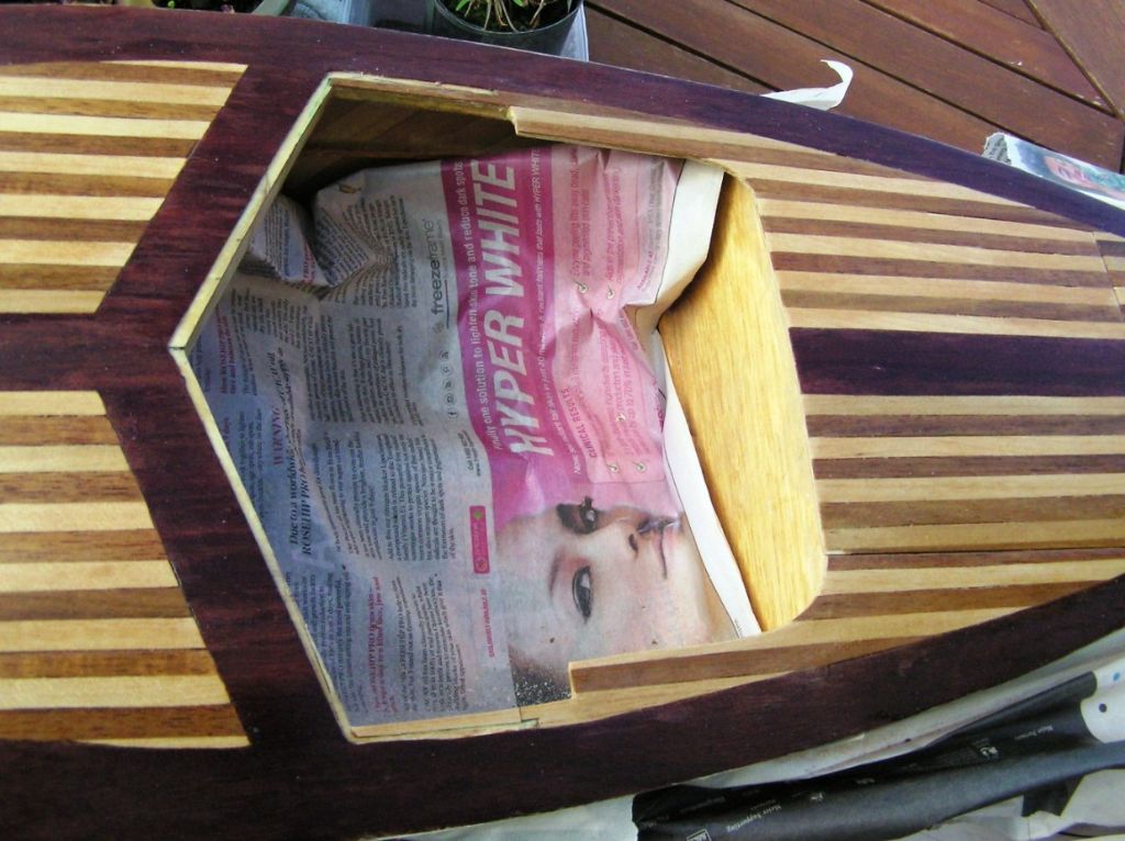

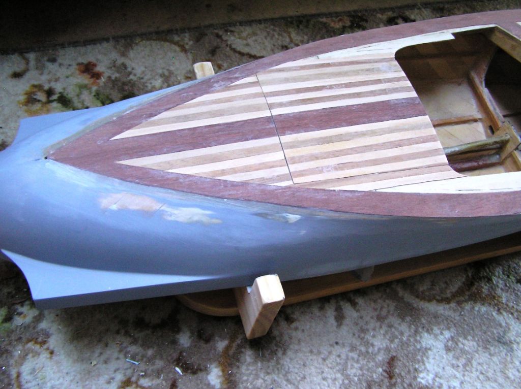

                new planking 3.jpgnew planking 2.jpgHi Allglue
                I removed all the deck planking and started with different wood.
                Found a darker wood veneer (Australian Jarrah) for the outer planking, but, staying with the Blackwood and Huon pine on the inside straight planking.
                Still have a bit more planking to go!!!

                    #72873
                      Hi All
                      Finally finished the deck planking, for the second time!!!
                      The glue destructions maximum drying 24 hours, I will wait 48 hours with the boat in the nice warm house.
                      I hope the wife does not see it !!!
                      My test piece as come up great with only three coats of spray vanish( British paints clear).
                      The brass strip in the middle of the dark Jarrah looks the goods!!!!
                      Harry
                      #72974

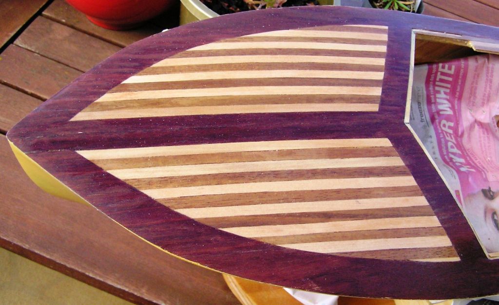

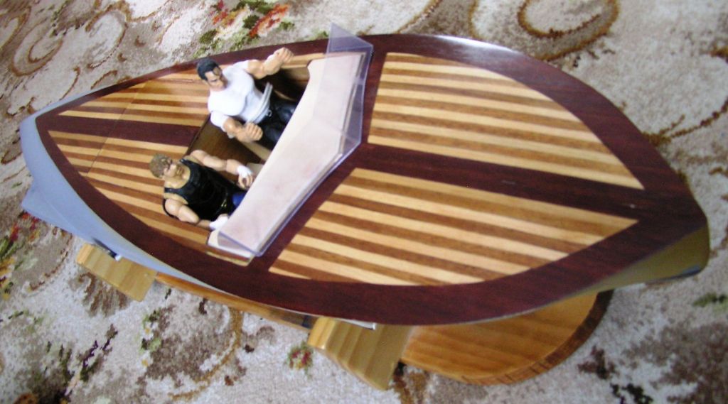

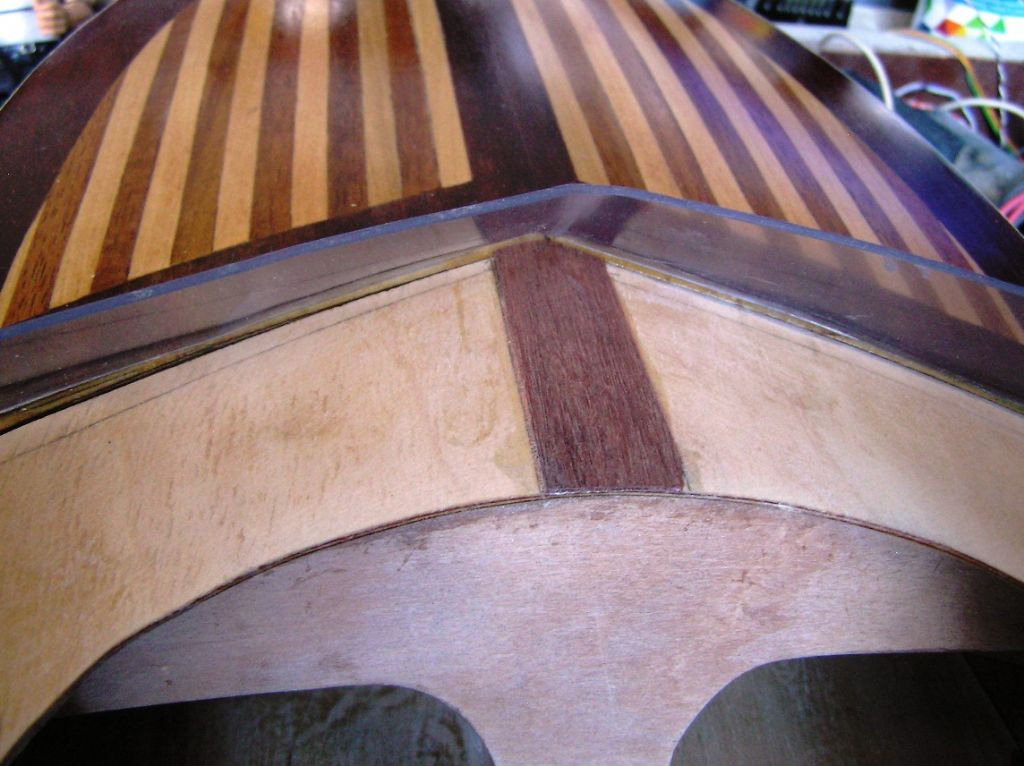

                        new stern deck.jpgnew centre deck.jpgHi All
                        Well guys the planking finished and started vanishing.

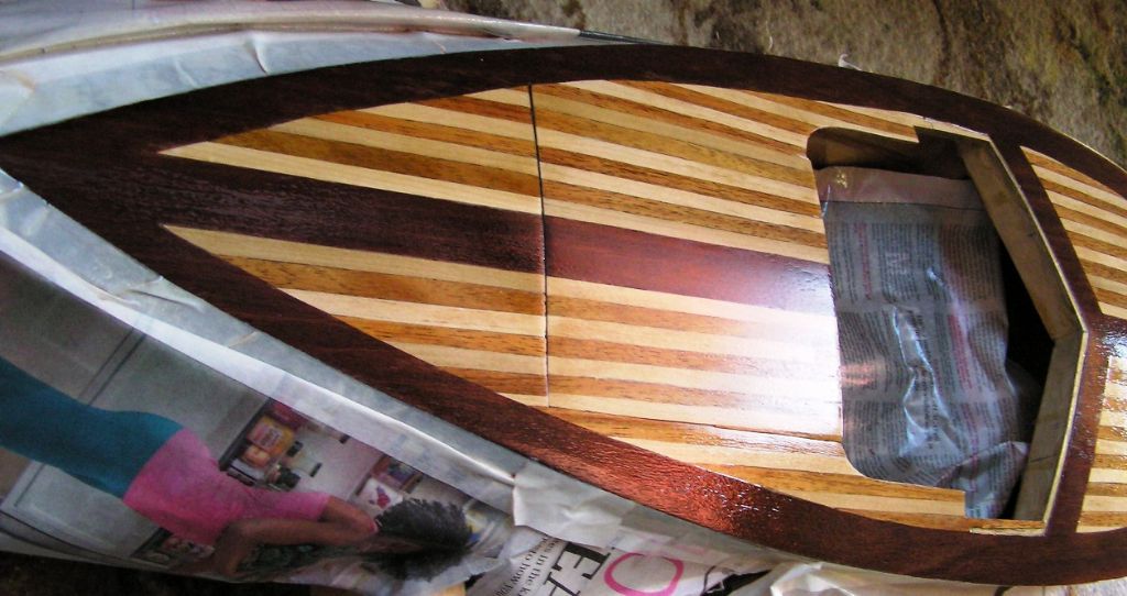

                        #73044
                          new deck vanished 4.jpgnew deck vanished 3.jpgnew deck vanished 2.jpgHi All
                          Finished vanishing the deck, I think it looks better than the first lot !!!!!!
                          A nice Royal Pipa blue for the bottom next .

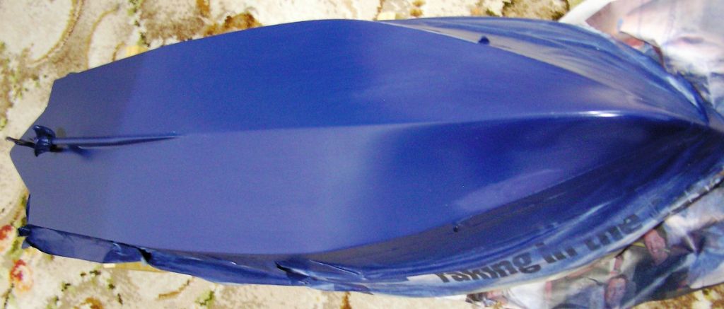

                                Two coats of blue on the bottom so far, two more coats and a few days to harden up.
                                Harry

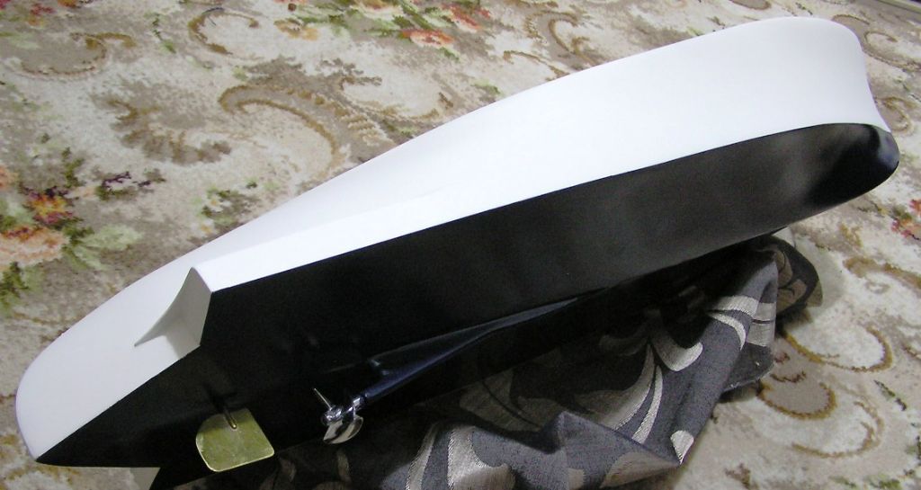

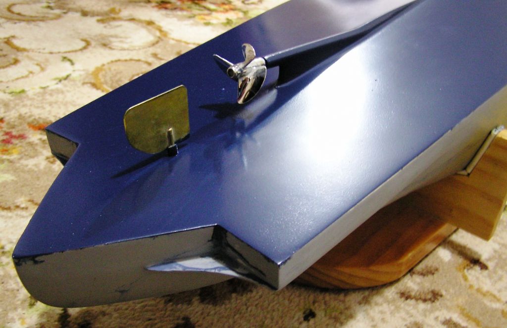

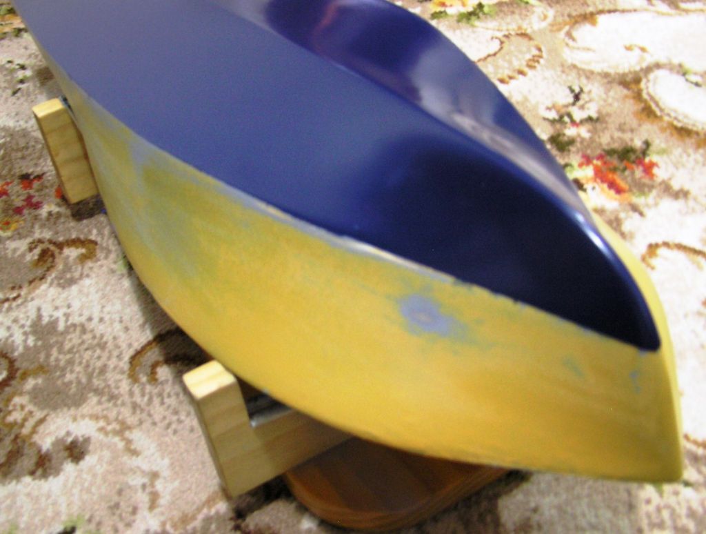

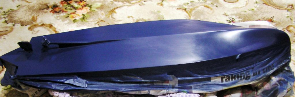

                                #73074
                                  royal blue bottom 4.jpgroyal blue bottom 3.jpgroyal blue bottom 2.jpgHi All
                                  Final coats on the bottom of the boat !!!

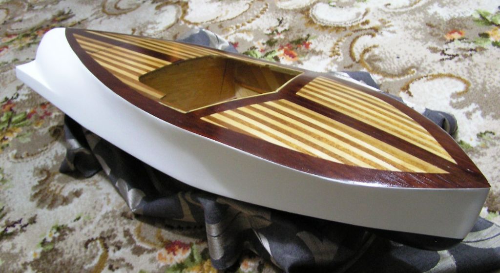

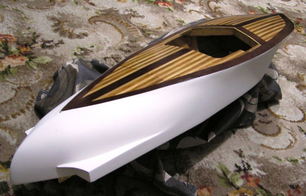

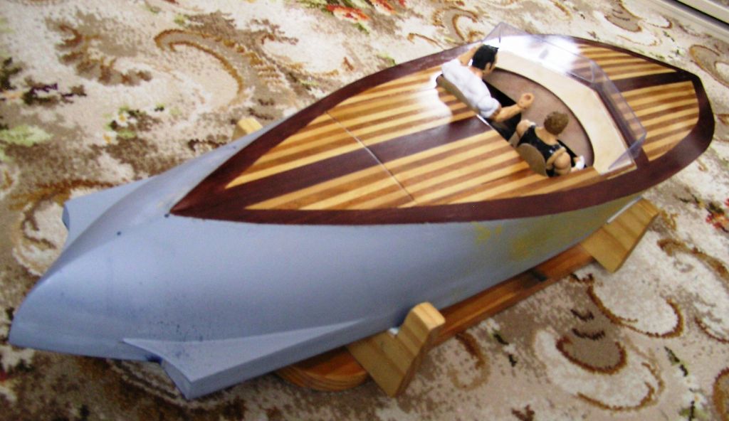

                                  #73125
                                    white side view 2.jpgwhite side view 1.jpgdash planking 1.jpgHi All
                                    Painted the sides white and started on the planking for the dash.
                                    Also add the shaft oiler which is the forward/ reverse T shifter !!!
                                    #73128
                                      That's beautiful harry, really nice. Once the figures of you and DM are in there it will be perfect.
                                      Those cutouts at the back are begging to have something in them….chrome exhaust outlets, jet exhausts or wotnot??
                                      ​Ashley

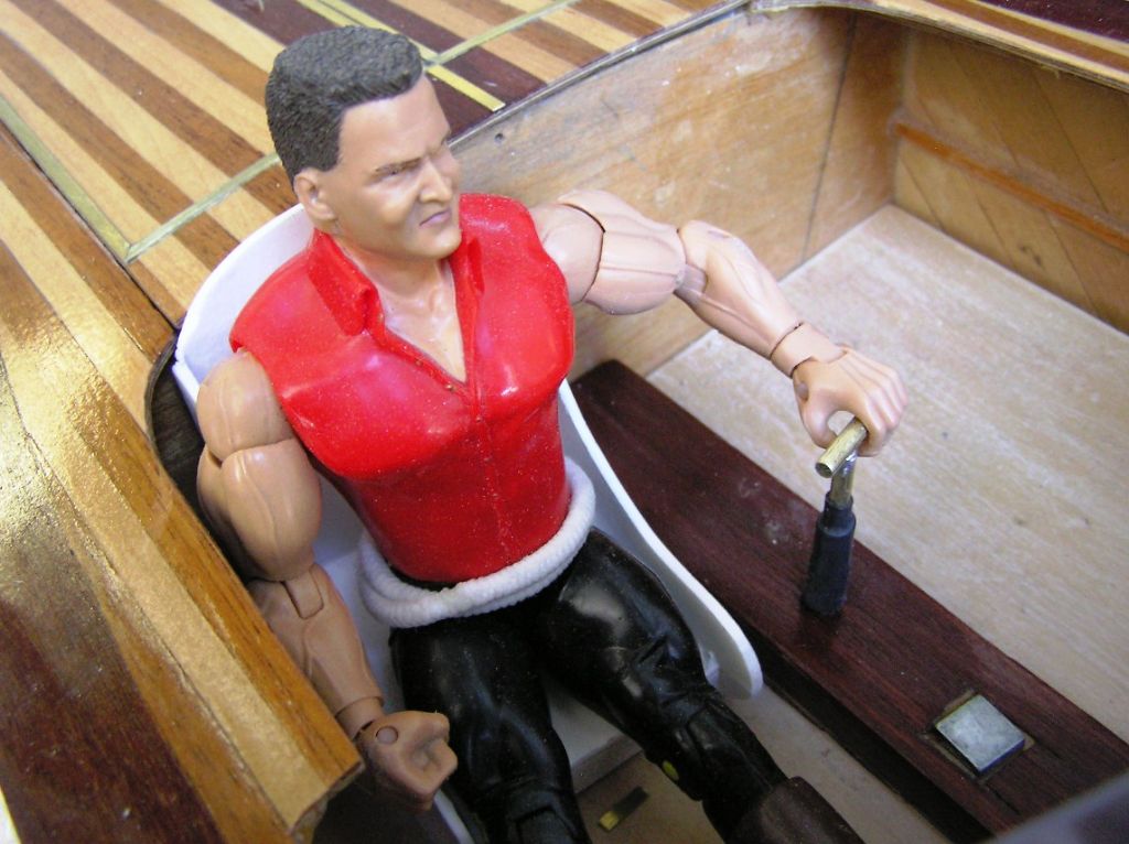

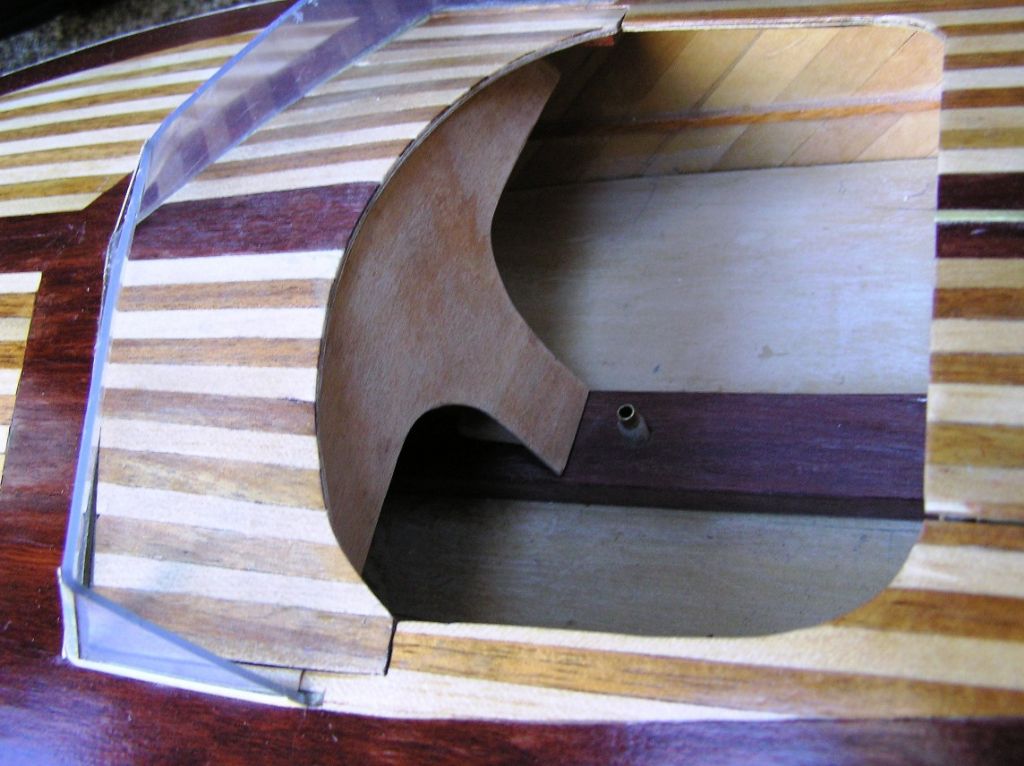

                                        oiler and shifter.jpgdash planking 1.jpgHi All
                                        Dash finished and vanished, also added the T Shifter oiler.
                                        Yes Ashley the wotnot exhaust would be six out each side, but that's after I get it into the water.
                                        #73162
                                          And yes I did let Ashley sit in the driver's seat, but, only once !!!
                                          Harry

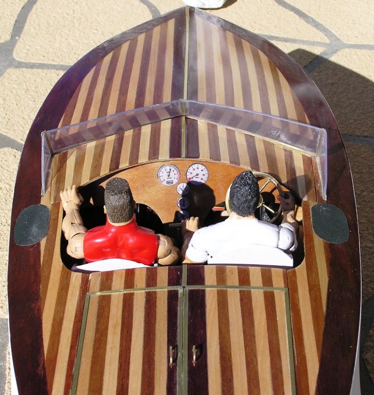

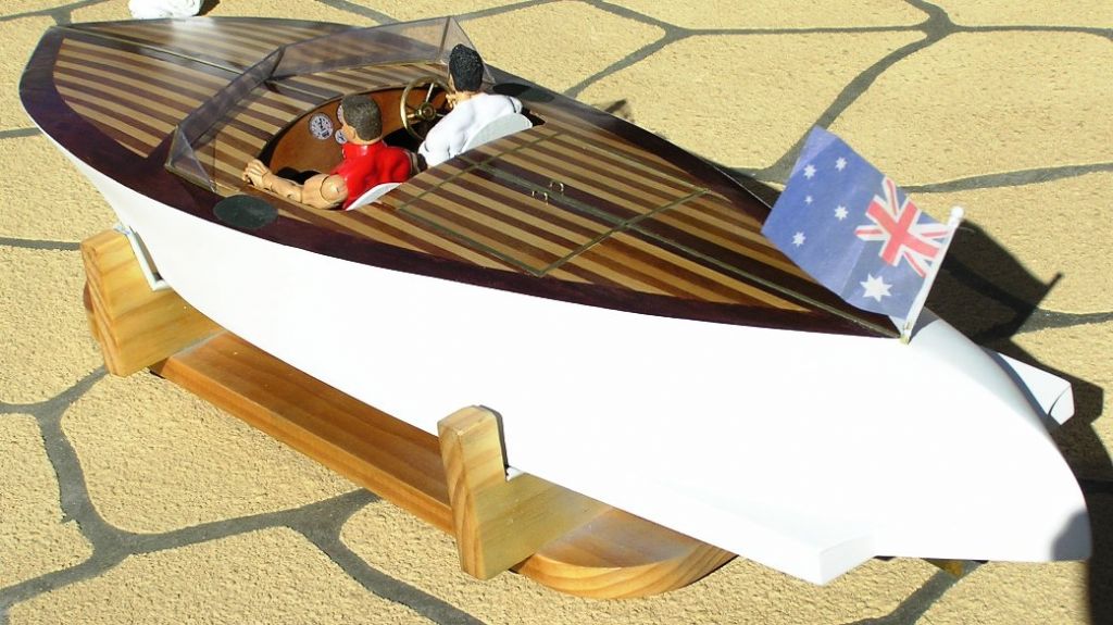

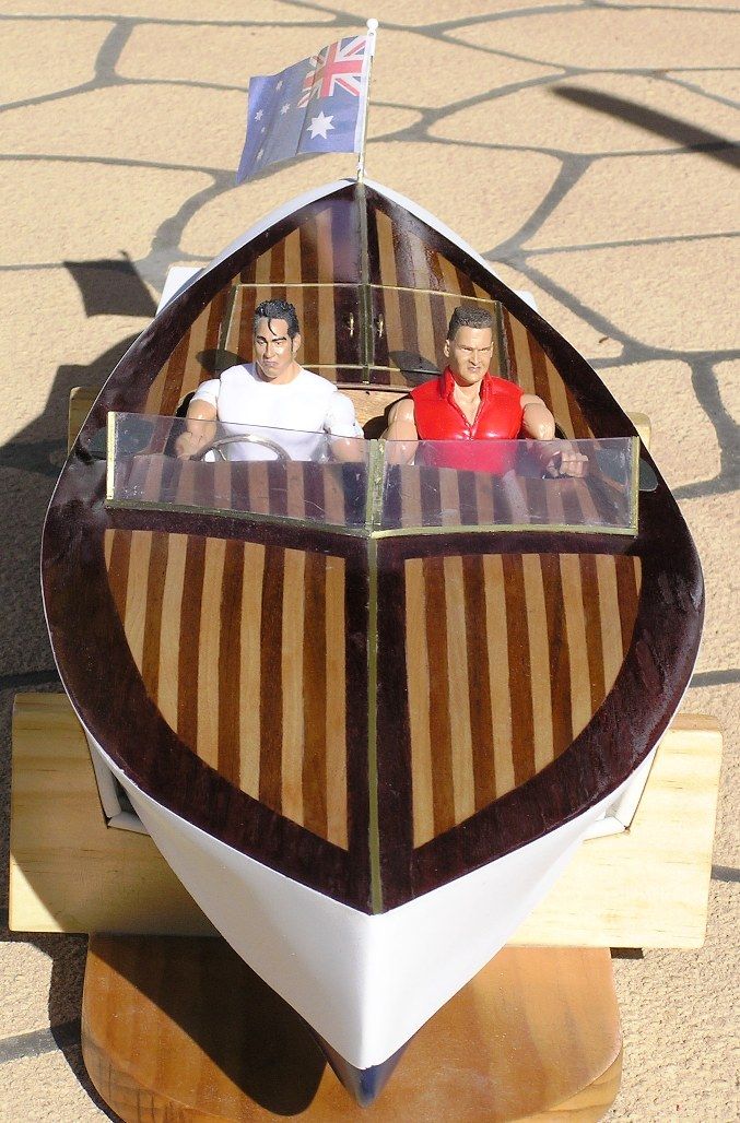

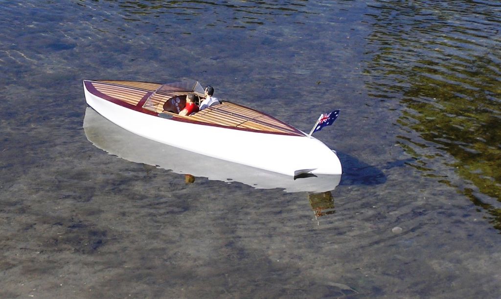

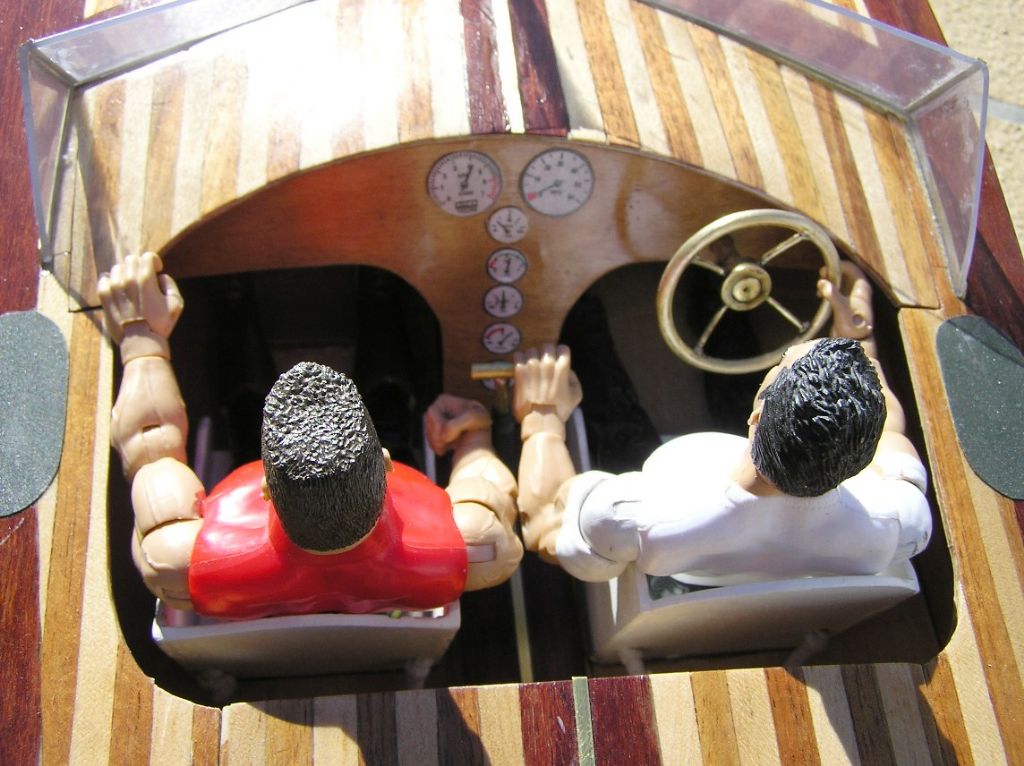

                                            side view finished.jpgcockpit with crew.jpgcockpit to bow view.jpgbow to stern view.jpgHi All
                                            Well I am getting close!!!
                                            Picture day with the boat polished up.
                                            Radio installed, Esc programmed up.
                                            Seatbelts on the crew.
                                            Offset on the rudder.
                                            Well chaps, take a leak and drive it like you stole it !!!

                                                Harry, could do with a bit more padding on that seat, it was a bit hard….
                                                ​Love the T shifter. Doesn't the driver have a girlfriend??
                                                #73202
                                                  Hi Harry
                                                  Really brilliant launch, I think the crew should have straw boater hats ? they look like they have just escaped from The Village People
                                                  #73203
                                                    Hi Ray and Ashley
                                                    These guys only got out of prison, yesterday !!!!
                                                    Has for padding on the seat , they had padded cells, so they would not have them!!!
                                                    Harry

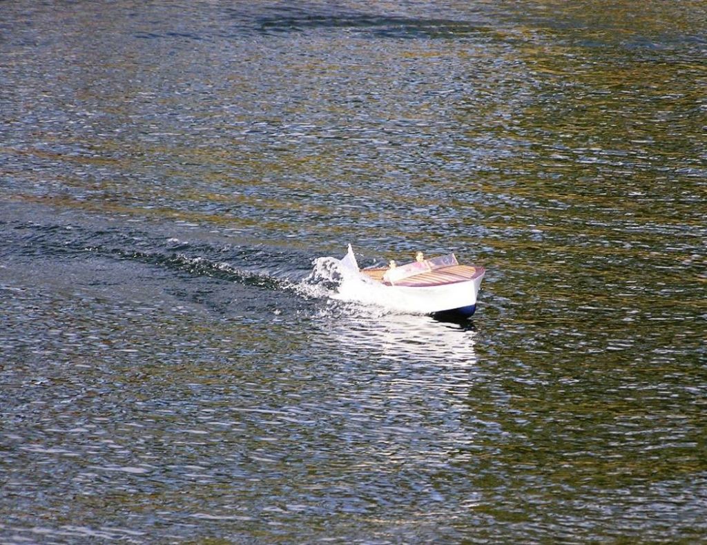

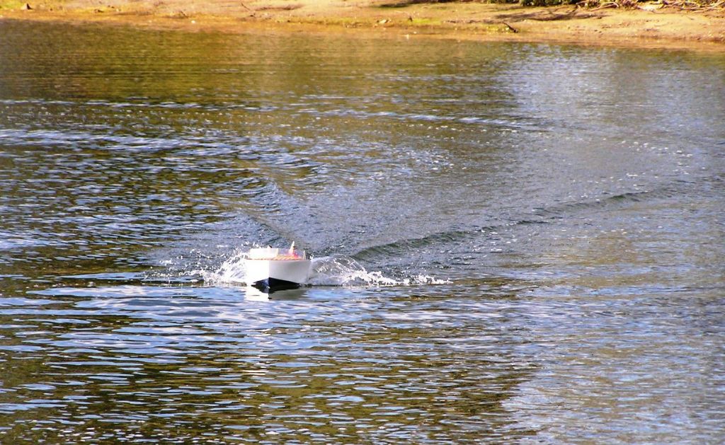

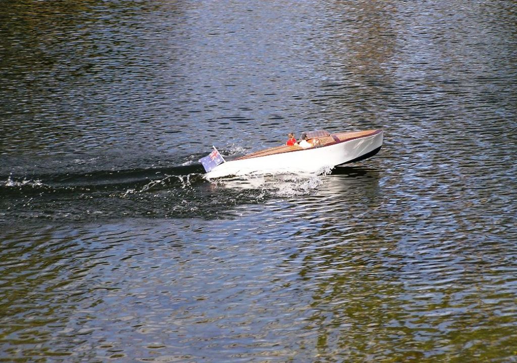

                                                    #73258

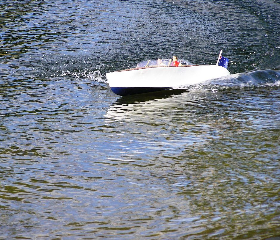

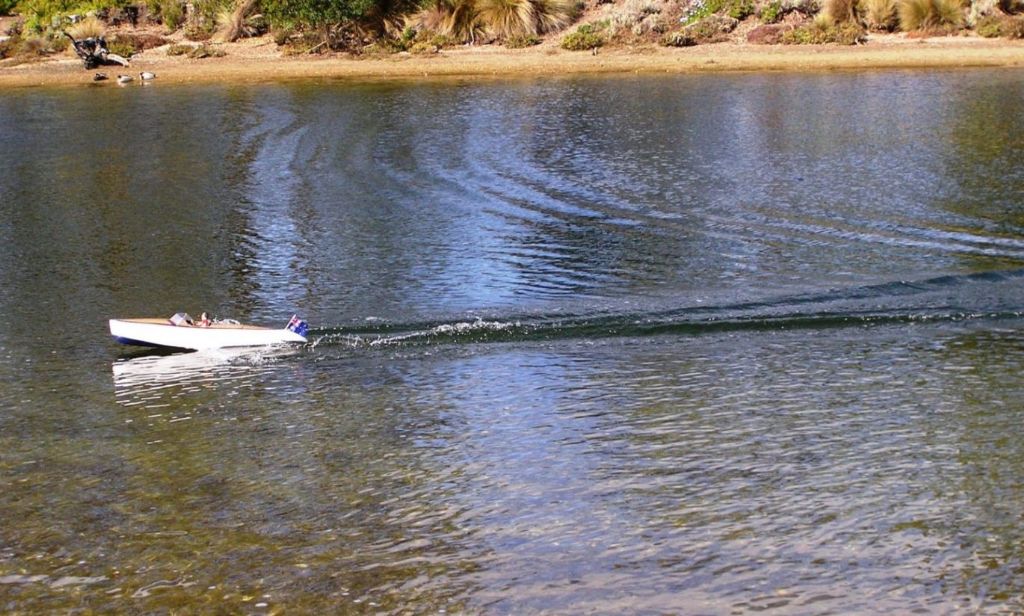

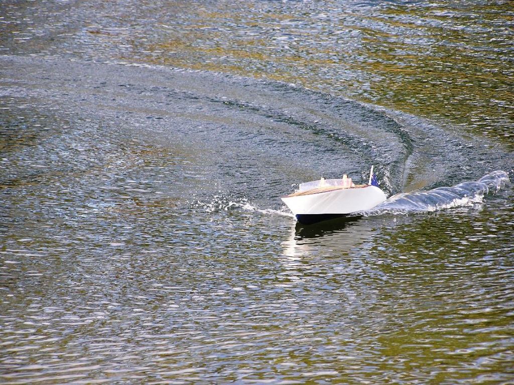

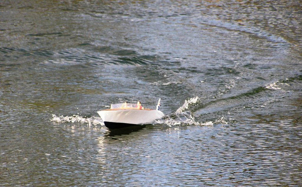

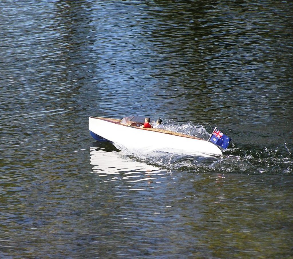

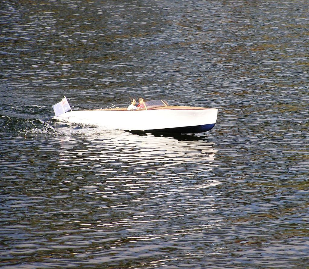

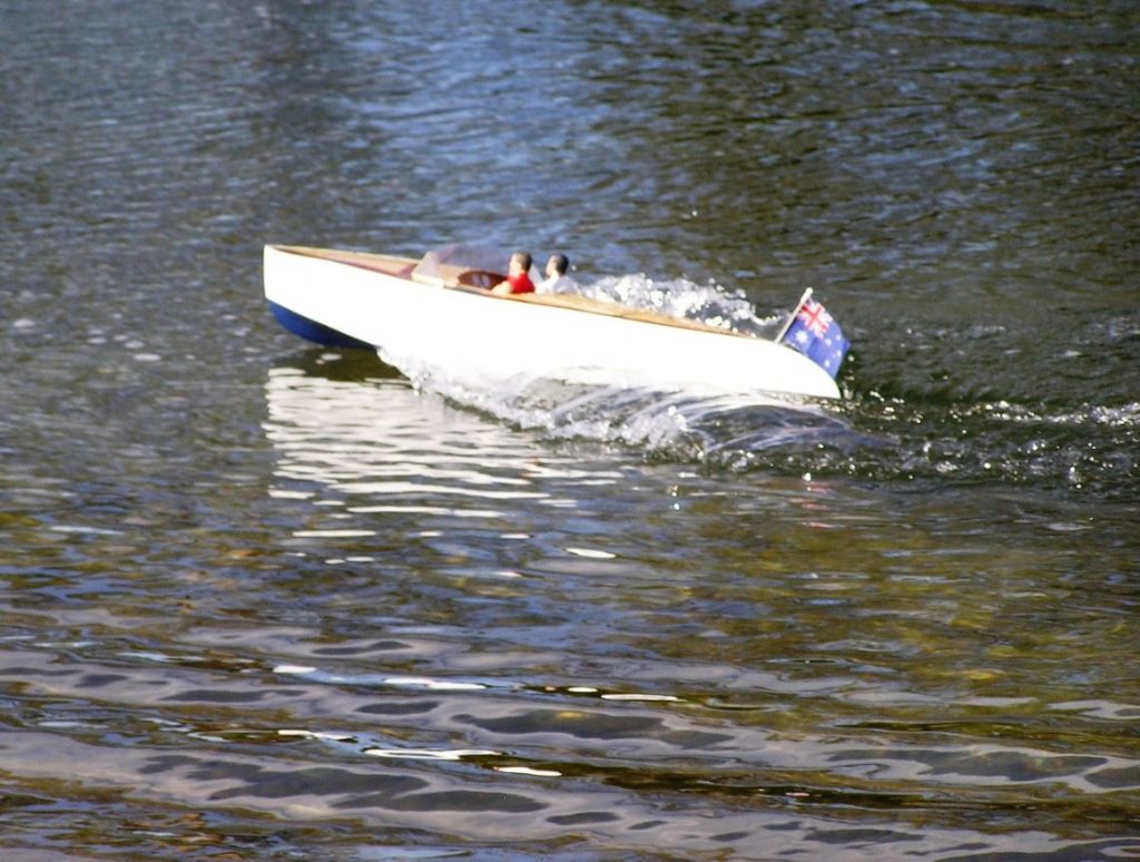

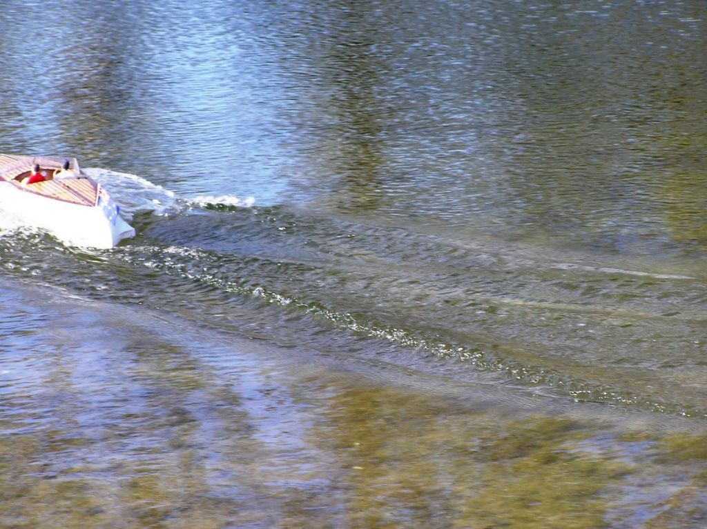

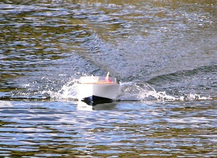

                                                      first run 20.jpgfirst run 20.jpgfirst run 2.jpgfirst run 18.jpgfirst run 17.jpgfirst run 16.jpgfirst run 15.jpgfirst run 14.jpgfirst run 13.jpgfirst run 12.jpgfirst run 12 a.jpgfirst run 11.jpgfirst run 10.jpgHi All
                                                      It's the big day today, the has it's first run !!!
                                                      Weather fine and a little chop on the water.
                                                      CG is at 415mm from the bow(about level with the crew's shoulders).
                                                      The boat sat on the water line.
                                                      A slow cruise off and checked the rudder and forward/reverse.
                                                      All OK !!!
                                                      As the boat did not spray rails, water flying up the sides and going all over the place.
                                                      Up on the plane easily at 1/3 throttle with nice rudder control.
                                                      Zip up to 1/2 throttle, planning very nicely and only standard spray existing from about the middle on the engine hatch area of the boat.
                                                      Down to 1/3 throttle on the turns.
                                                      With the camera shots over, time to see what full throttle is like!!!
                                                      Nice and quick, over scale speed, but sits very stable on the water.
                                                      My rudder offset as spot on for the first time ever.
                                                      Very happy with the boat.
                                                      What a cracker of a day, may have a few pints tonight.
                                                      Have a few bits to add to the boat later and make some six stack side pipes for each side.
