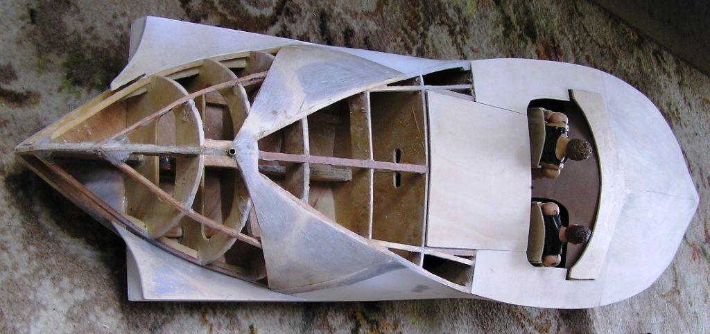

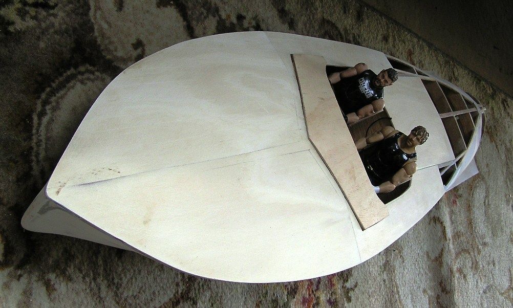

        forward deck 4.jpgforward deck 3.jpgforward deck 2.jpgHi All
        Added the forward deck with a full cover of wood glue over the underside(to waterproof it also fibreglass the inside frames, sides, stringers and keel).forward deck 1.jpg

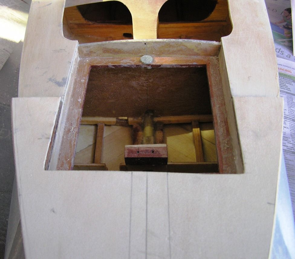

                The boat is 850mm long, I found smaller boats are too hard to work on and get my hands into.
                Also our boating area is on the large size and the free car parking is only 20 feet from the water.
                The only limit access is to the rudder, but, to the motor and ESC good.
                The radio and battery area is larger than the drawings and I can get a 3S 3700mah Lipo battery in and out easily.
                The original engine hatch size will be seen on the boat.
                I am into planking the stern at present, so watch this space.

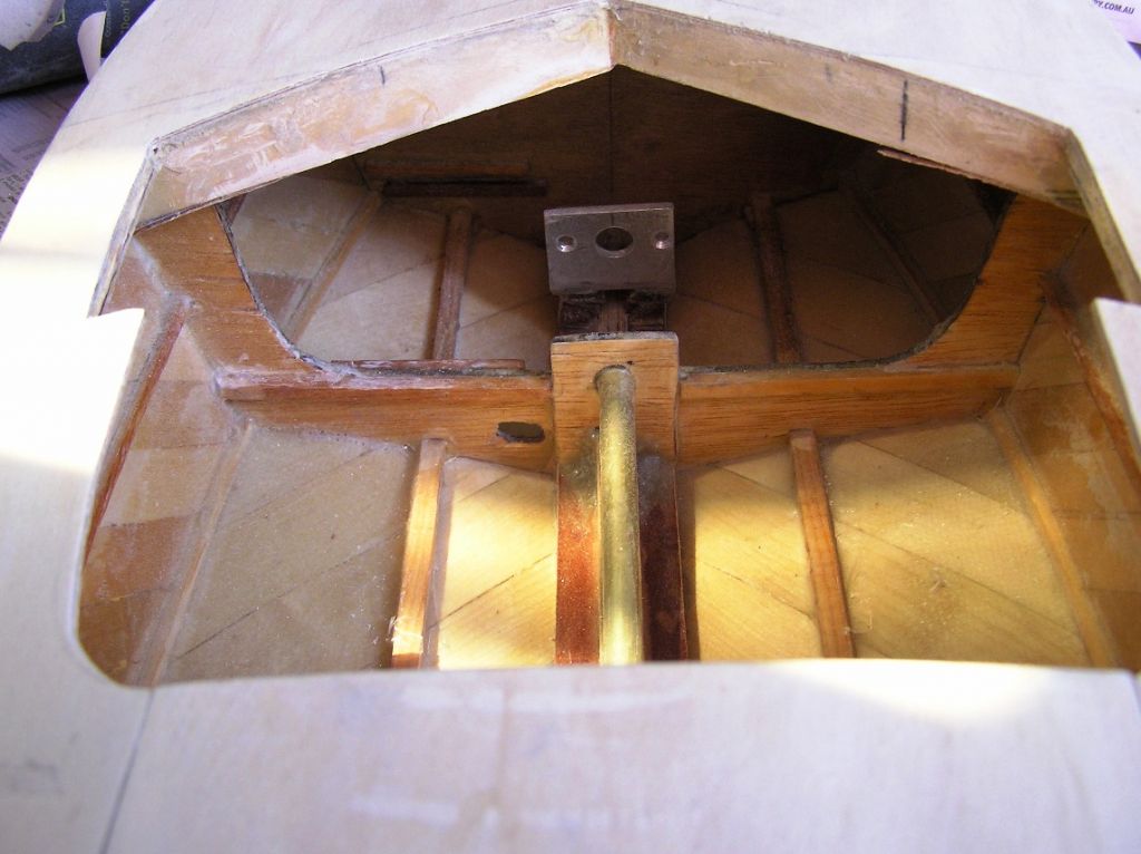

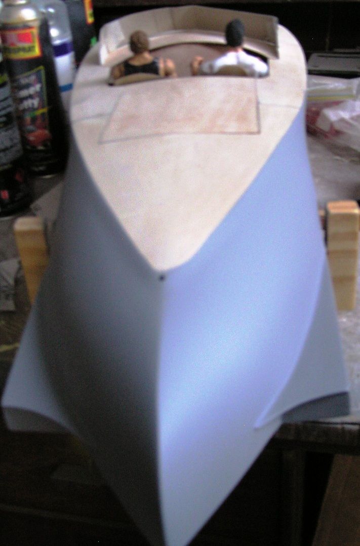

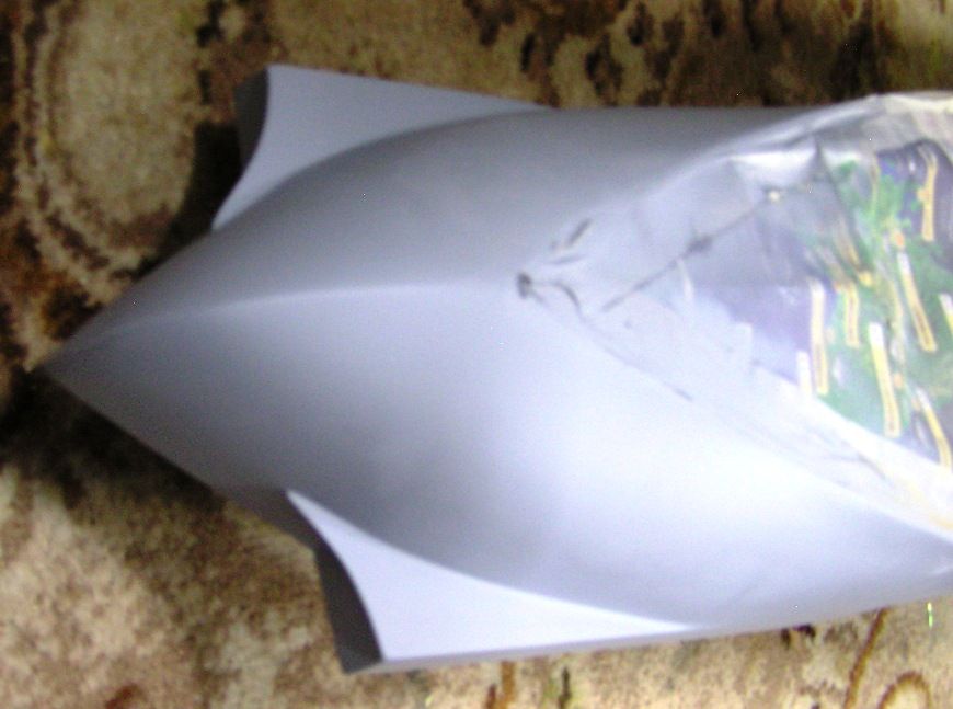

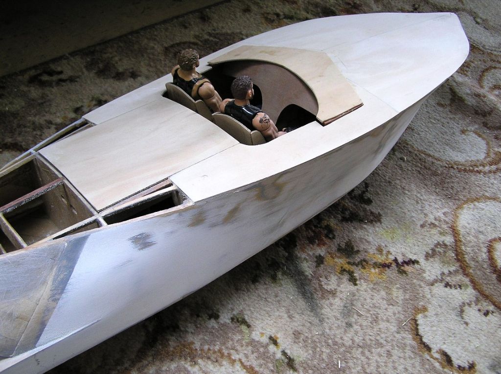

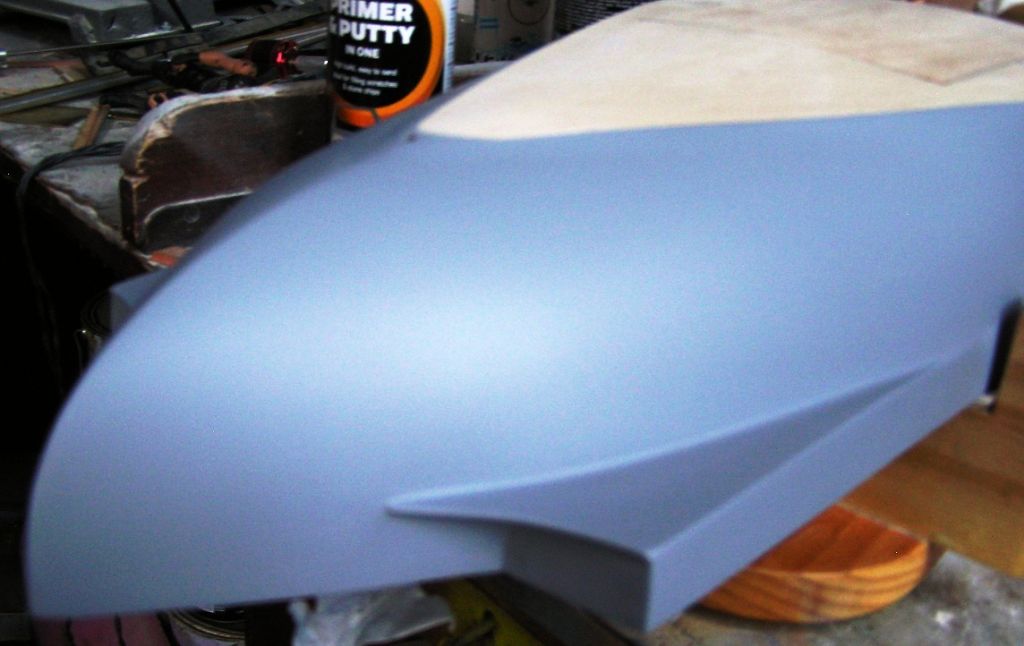

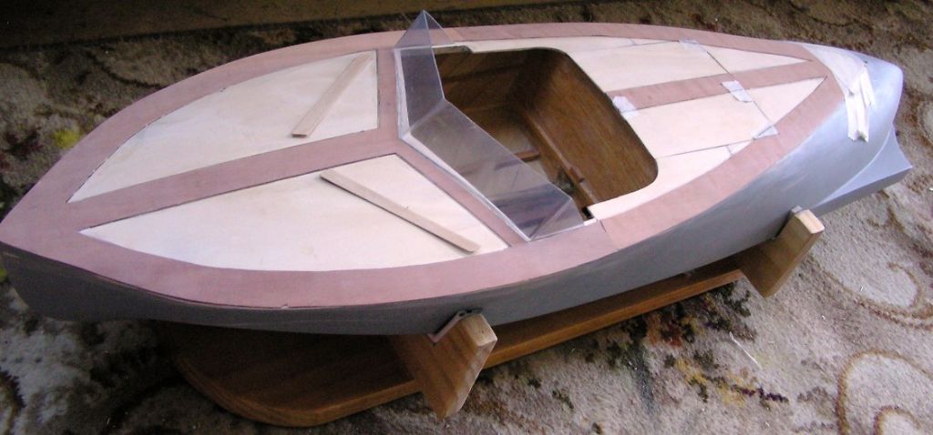

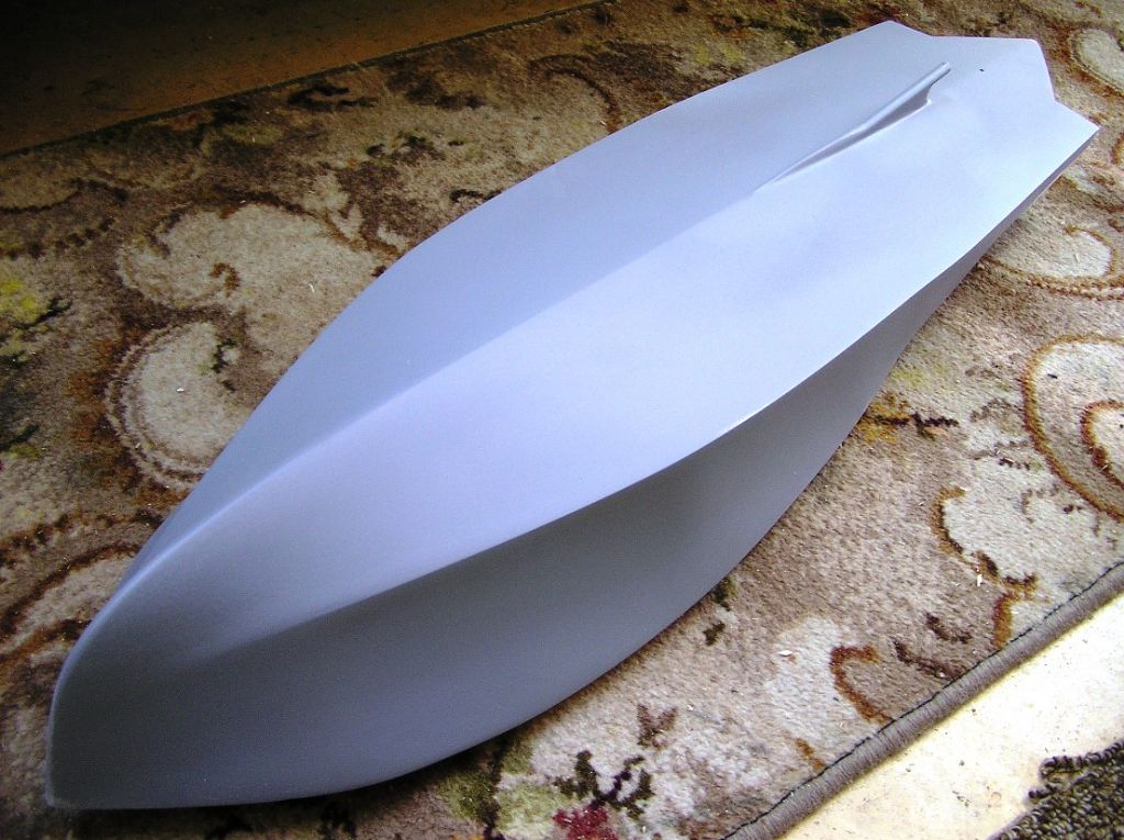

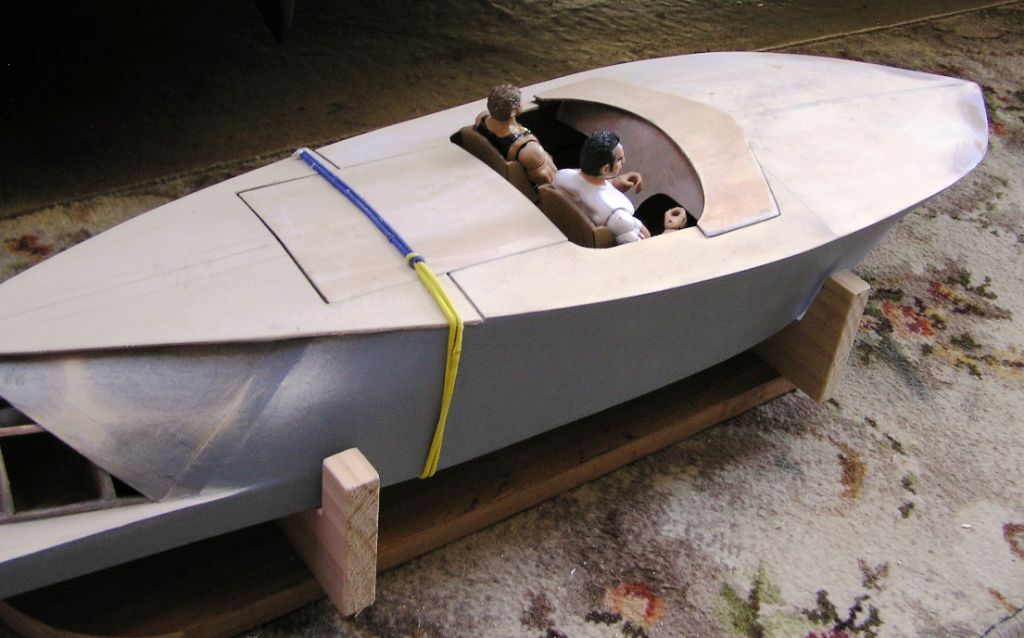

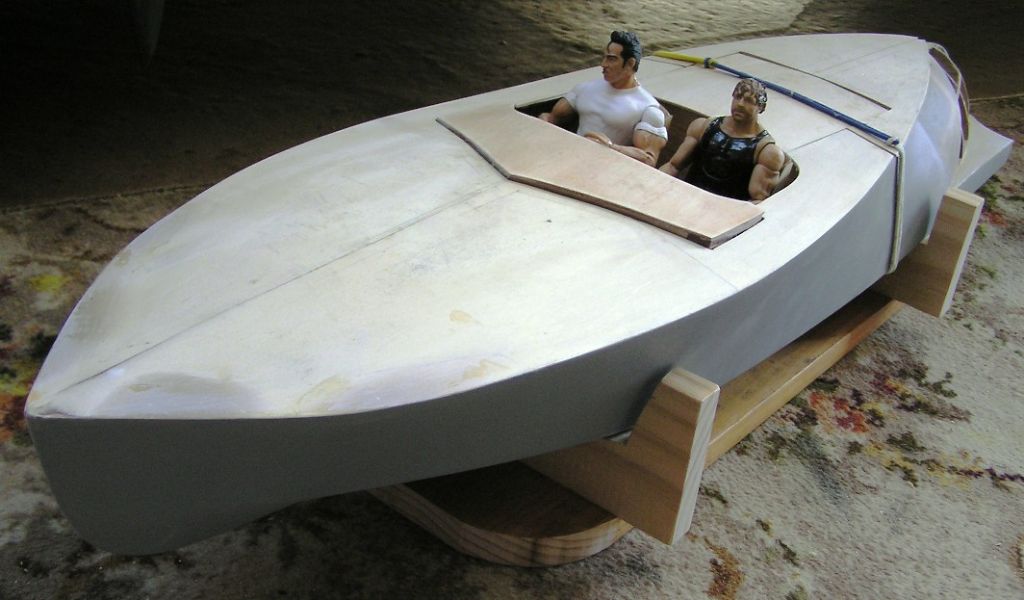

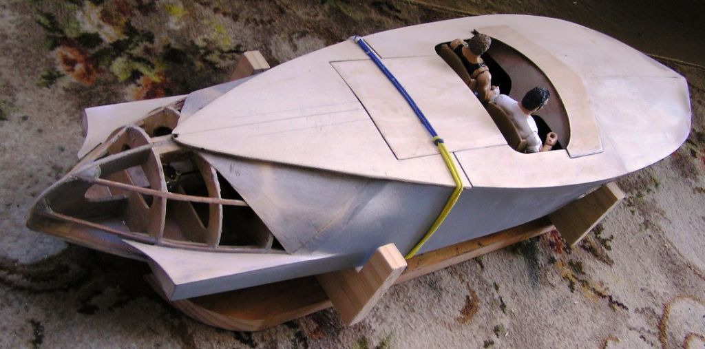

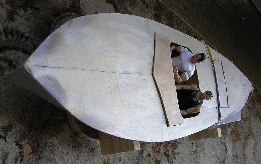

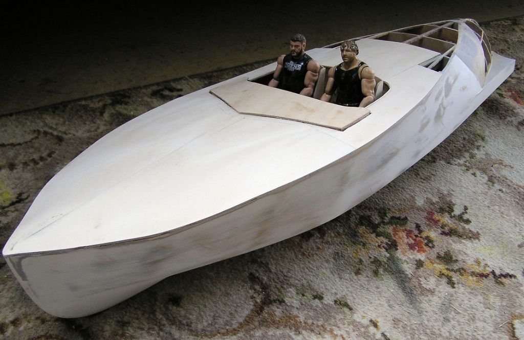

                  top side view 3.jpgtop side view 2.jpgtop side view 1.jpgbottom undercoated.jpgcockpit with dash.jpgcockpit no floor.jpgdeck view.jpgengine hatch off.jpgHi All
                  A warm winter's day, so I dry fitted the aft deck and spray painted the bottom and sides with a filler/ undercoat.
                  I am resizing the pics and posting soon!!

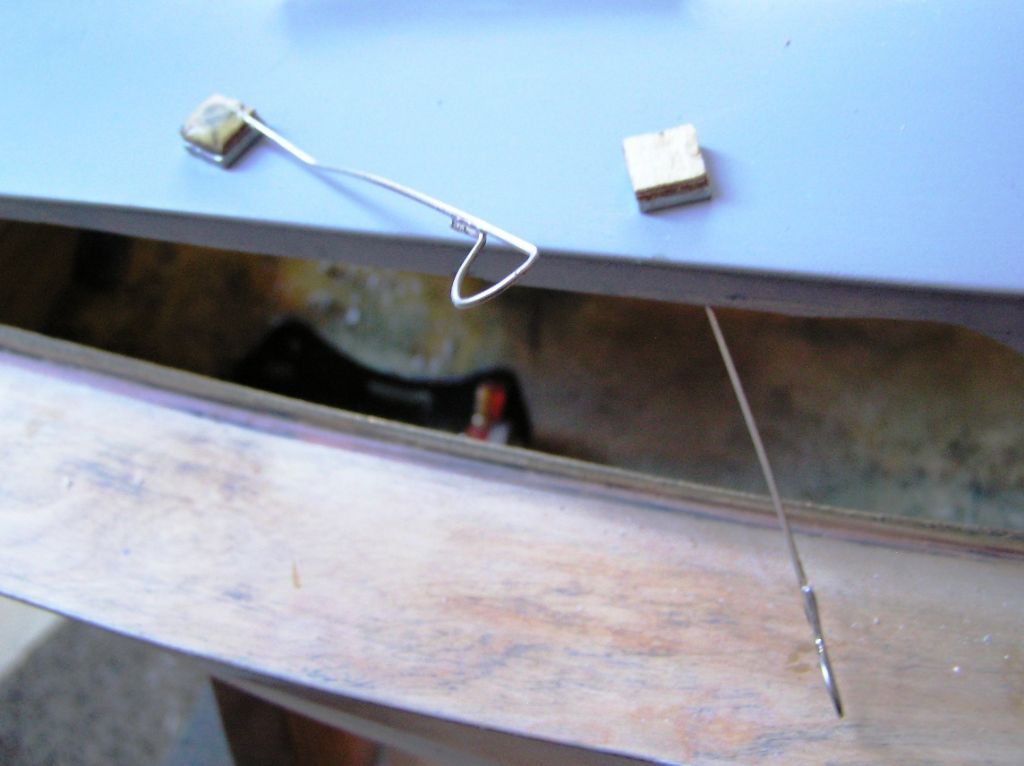

                    Hi All

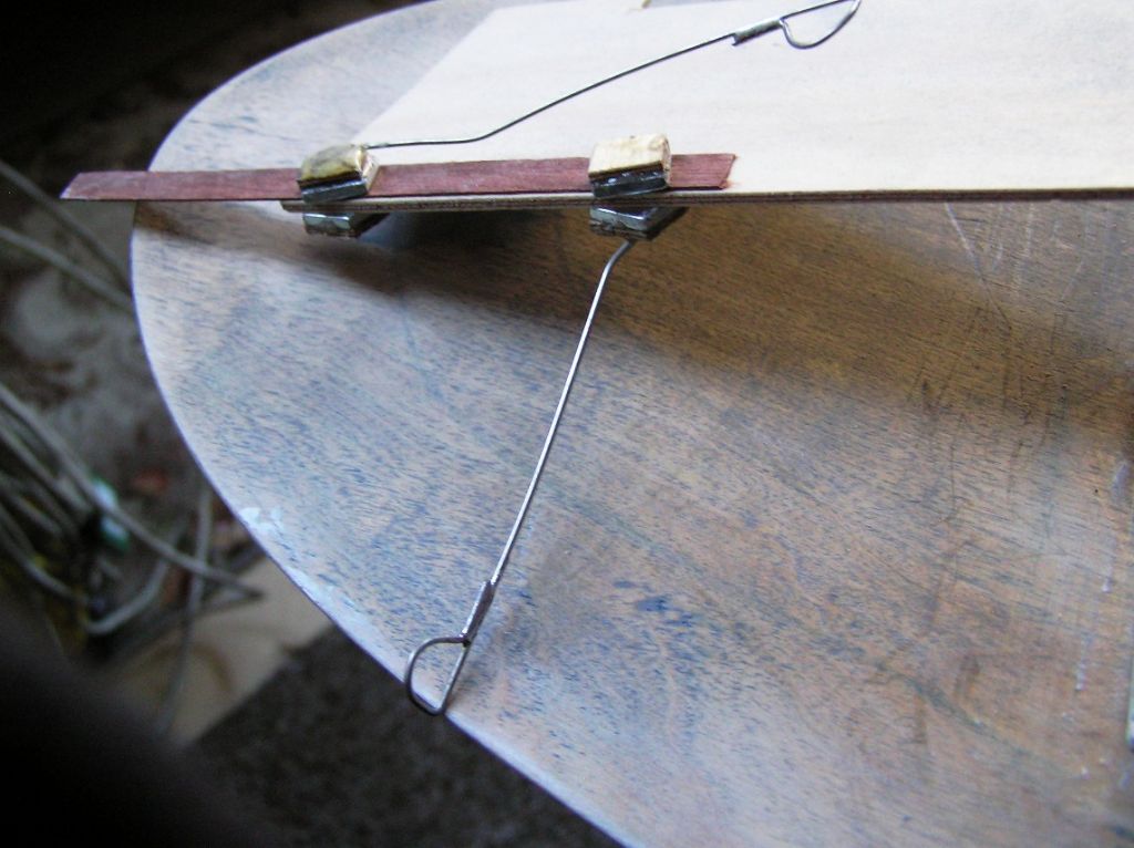

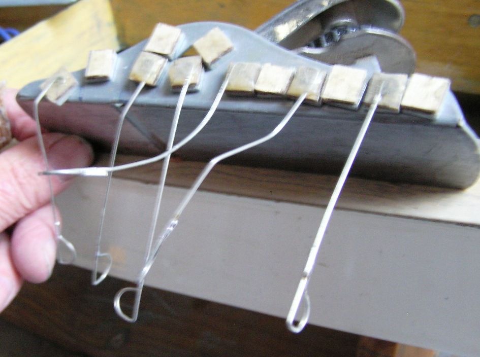

                    Made some wire handles and glued onto the 10mm magnets to plank in the stern .
                    Found these work OK with the wire easily bent to requirements.
                    Harry

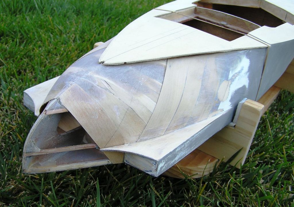

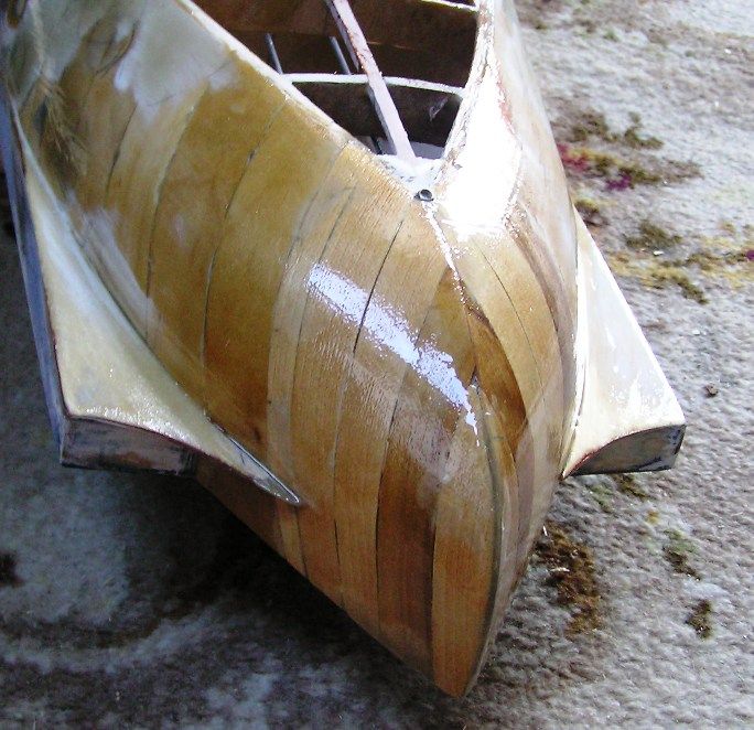

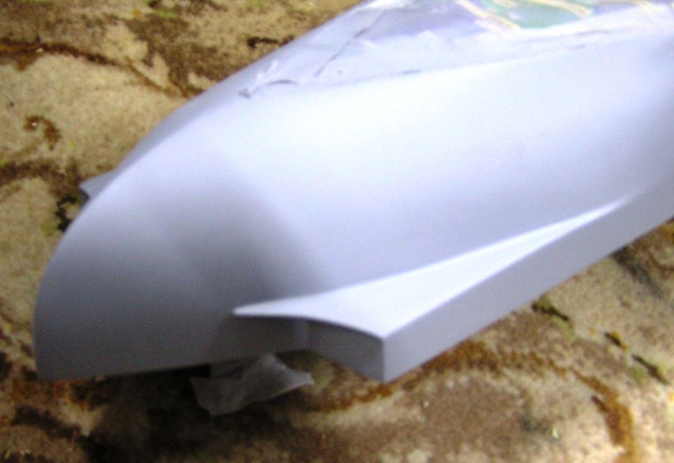

                      stern undercoated 2.jpgstern undercoated 1.jpgstern final planking 2.jpgstern end view.jpgmagnet clamps 3.jpgmagnet clamps 2.jpgWell Gentleman the stern is finally covered in, looks better than some rear ends I have seen at our club meetings!!!
                      The magnetic clamps work like I hoped ( over glue-ing a bit of a problem to release them)!!!!
                      I feel like this one is fighting all the way, but, I will get this beast into the water!!

                          I will have to do some better pics of my magnetics with the wire handles.
                          I also found these work besides on wood also work on aluminium, etc.(As long as you use one each side).

                          #72306

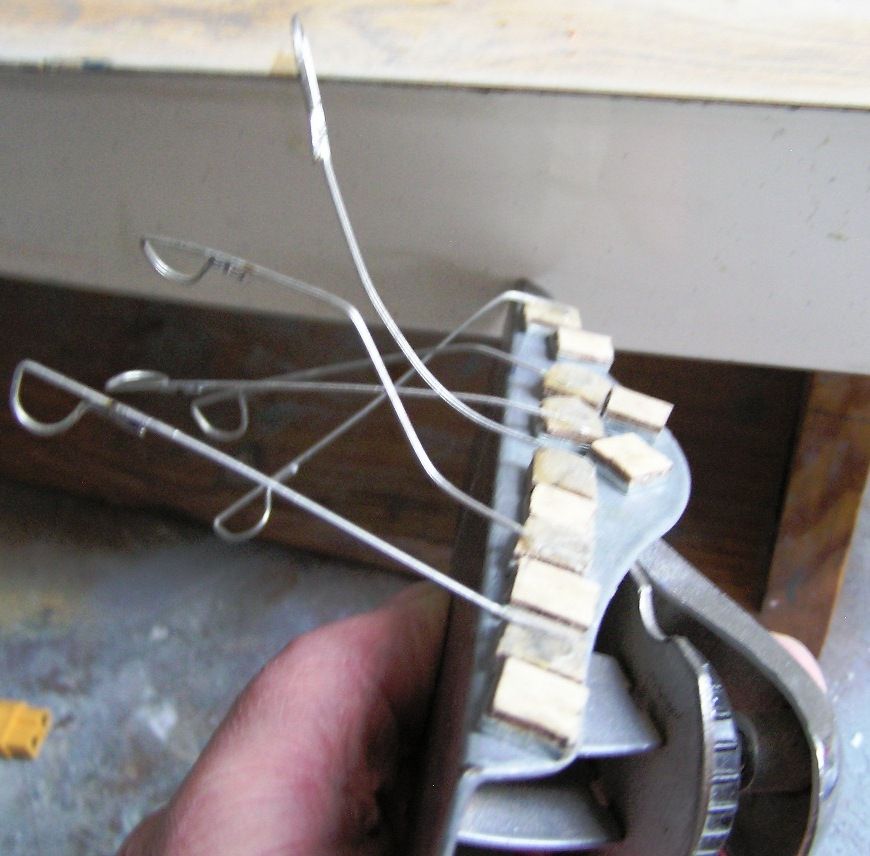

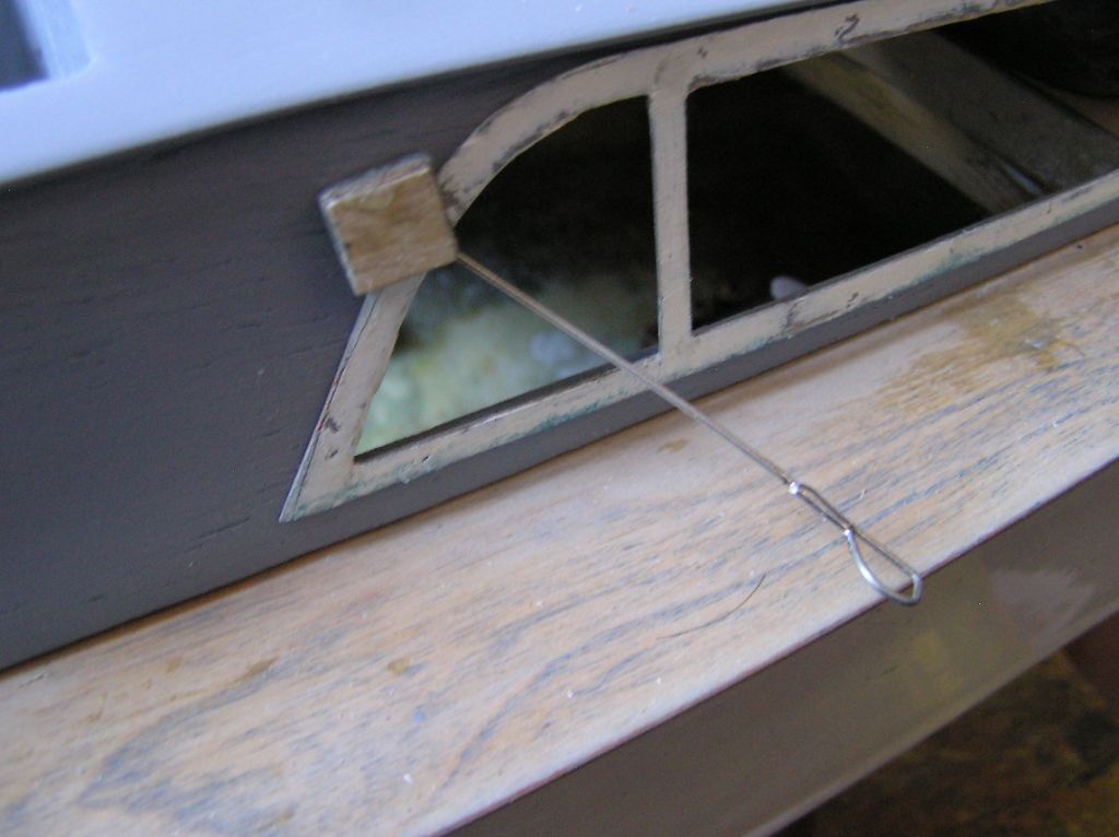

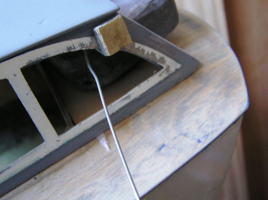

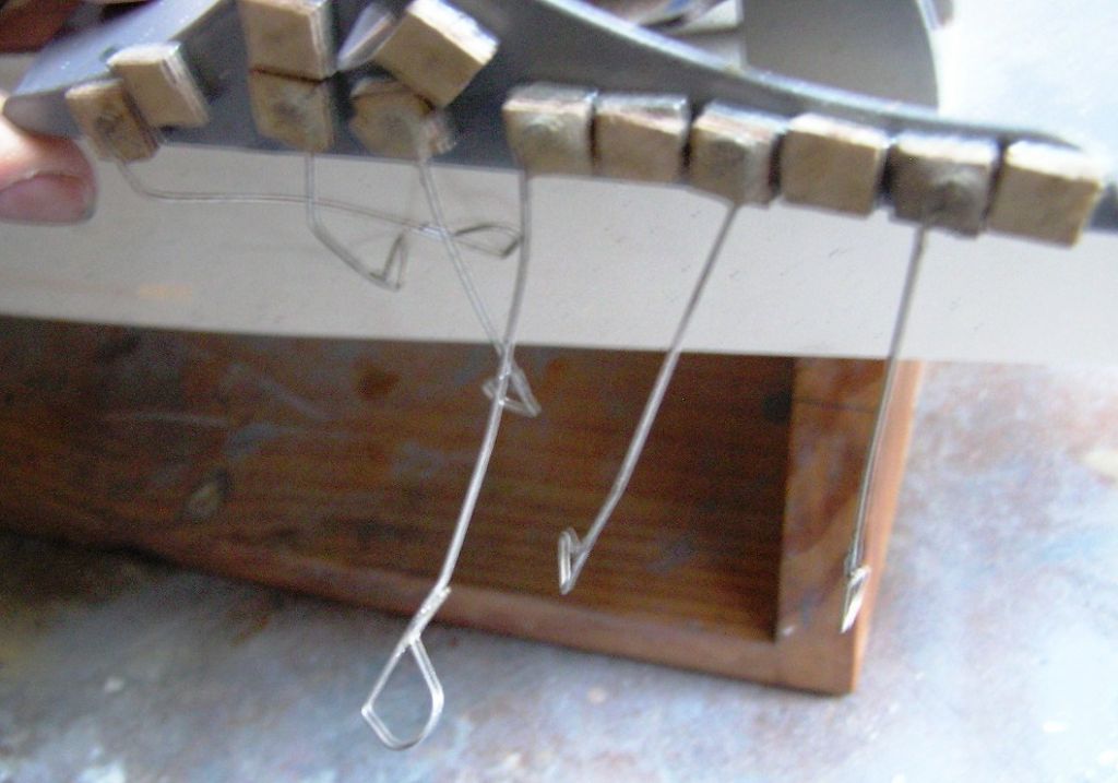

                            magnet clamps 7.jpgmagnet clamps 6.jpgmagnet clamps 5.jpgHi All
                            Adding a few pics of my magnets with handles, hopefully these show the idea better!!
                            Harry
                            #72307
                              Hi Harry
                              That's a great idea ! really impressed with the way they hold that block plane on it's side

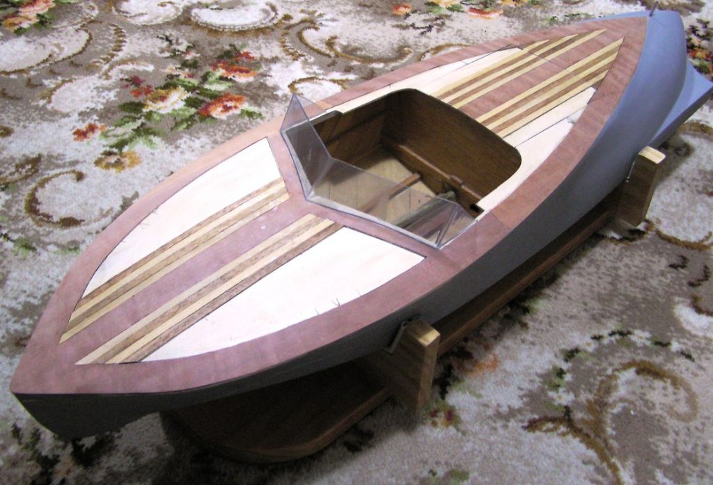

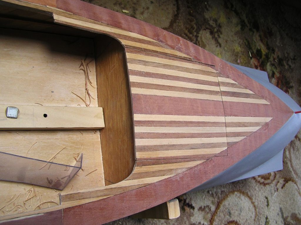

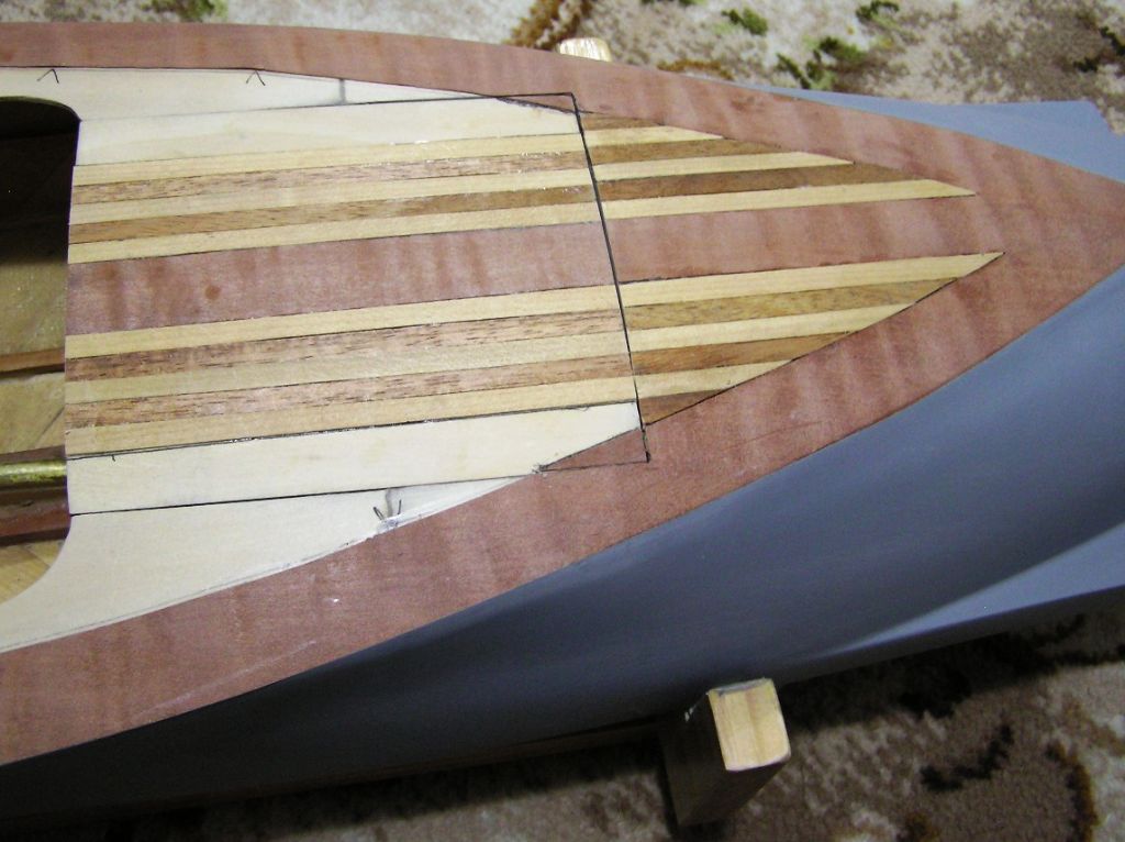

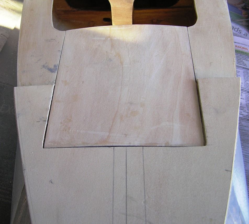

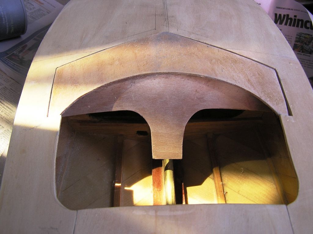

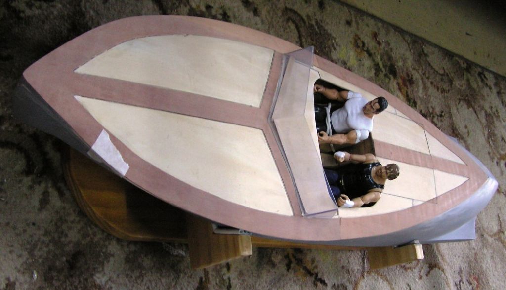

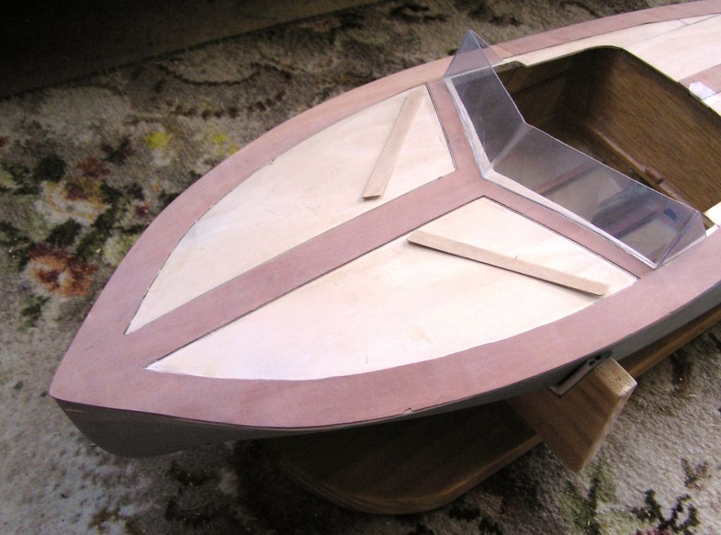

                                stern deck 2.jpgstern deck 1.jpgdeck view 2.jpgdeck view 1.jpgHi All
                                Added the stern deck and starting the long planking job.
                                The outer trim planking is in two pieces with a join near the rear of the windscreen.
                                Also a short piece on the engine cover.
                                Will follow the center strip onto the dash area and cover the cockpit drive tunnel with the same veneer.

                                  The magnet clamps have been very handy with such a lovely complex model shape
                                  Was this your idea?

                                      Yes it is one of my crazy ideas and there are more floating around in the old grey matter!!!

                                        Hi Harry. Your boat is a nice piece of work. The planking interests me, do you just glue one end of the plank down and then clamp the plank into place or do you pre bend them? I would be interested in how you do it. The pictures are excellent but a little explanation of the method would be of interest to me as a starter.
                                        Brian
                                        #72356
                                          Hi Brian
                                          I glued both ends and over the stringers and frames on the first layer.
                                          Because it's veneer it bends easily but on the stern I prebend each one with pressure in my fingers.
                                          Each plank requires trimming on the edge which goes up against the installed plank because of the curve of the hull.
                                          In the stern an extra stringer on each side would have given me more gluing area.
                                          Fill and sand the first layer and start the second layer.
                                          Until you get the second layer on around the cockpit and engine area the hull is fairly weak.
                                          As for the bottom I stood have used plywood from a diagonal cut across frame 2 and 3 to the stern.
                                          This would save a stack of time.
                                          The hull is very strong and light.
                                          I will use 2ounce fibreglass matting in the bottom of the cockpit floor as it's a bit springing, but, the rest is OK.
                                          The magnets with handles worked as I hoped.
                                          Harry

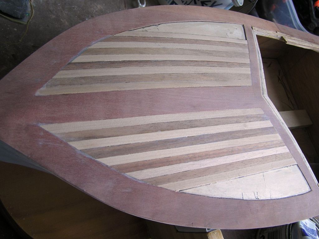

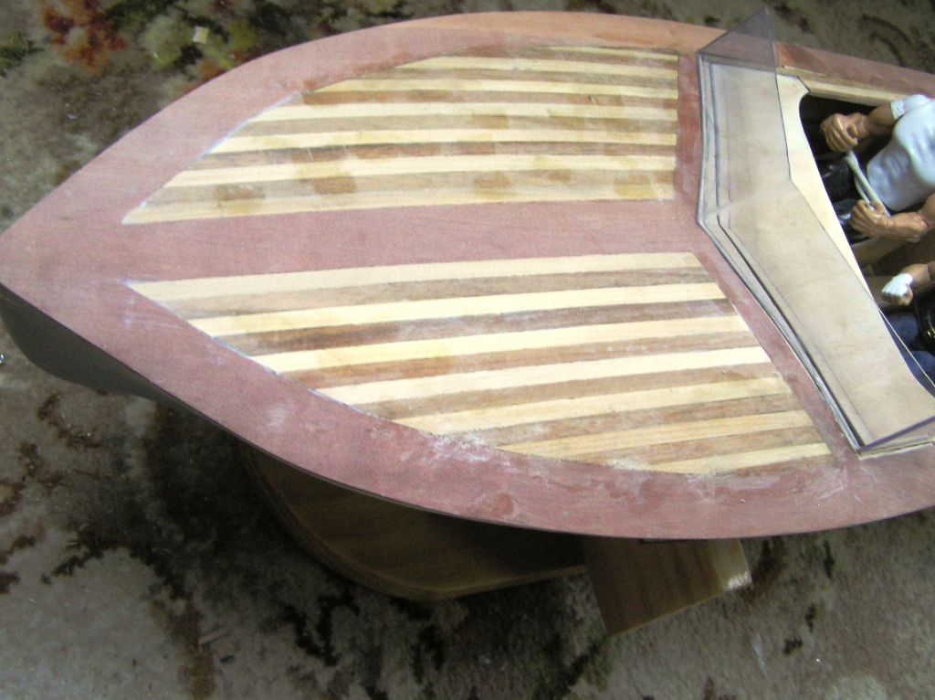

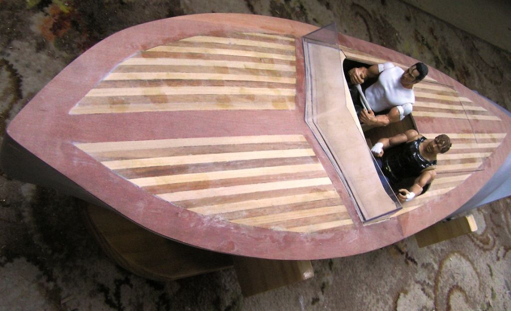

                                                planking deck 1.jpgplanking deck 2.jpgplanking deck 3.jpgHi All
                                                Planking, planking and more planking!!!
                                                I think I am just about planked out!!!

                                                    #72544
                                                      deck full planking 2.jpgHi All
                                                      Finally finished planking!!!!
                                                      Harry
