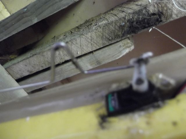

              #43628
              Amy jane September
                @amyjaneseptember49770
                Hello Pete.
                This is the method my friend Lynn uses on her planes. 1.6mm s/s tig welders filler rod. Handy stuff!

                #43629
                  Garden wire, noit the plastic coverwed stuff..2mm or so.As per Amy`s post, easy, cheap..just put a very small dogleg either end.. servo arm may need enlarging a tiny bit with a needle file. Ashley nb Electrical connectors also a good idea for adjustment, take the plastic outer off for a more compact size.
