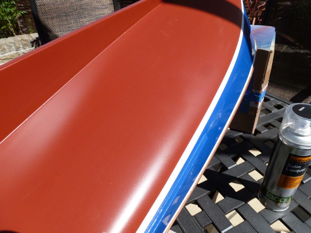

                To illustrate Kip Woods' point about Halford's Satin Lacquer, this is the finish I obtained with it over their Red Oxide Primer on my Lobster Boat (hull is balsa planking with glassfibre cloth and epoxy resin):

                  Halfords satin laquer it shall be. I didn't even know they made one. Anyway, many thanks to all respondents.
