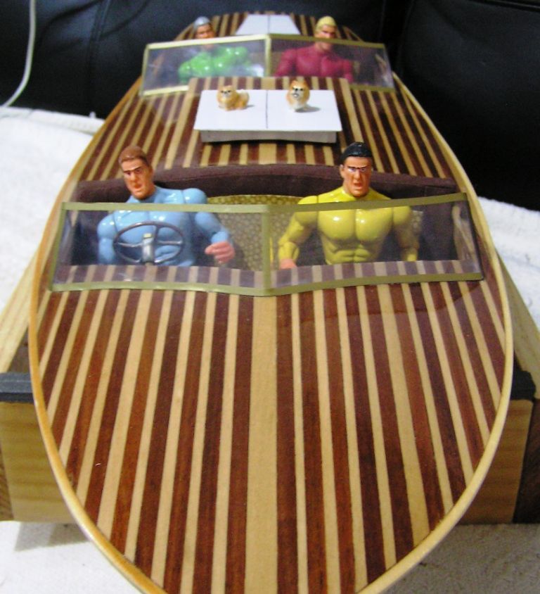

                                p1010239.jpgHi ALL
                                I caught a couple of Poms trying to STEAL my boat!!!!!!
                                I got a few pics of these Poms to post on the web site!!!
                                They put a brave fight but my crew did capture these villains!!!
