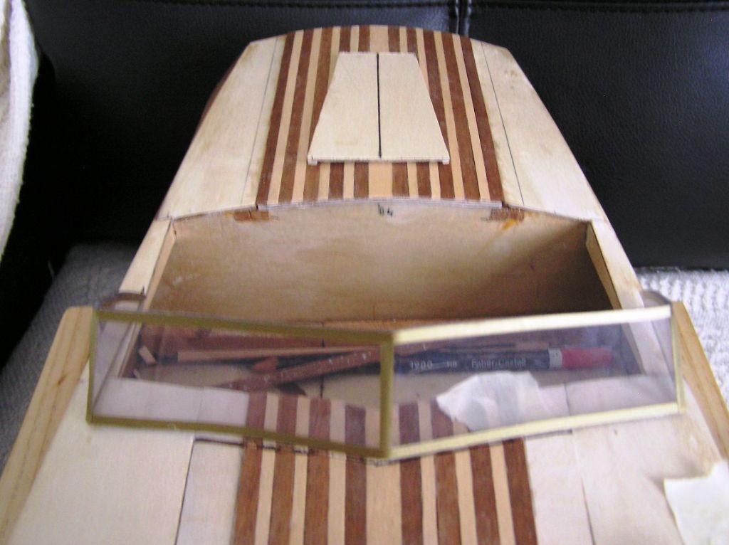

      #59814

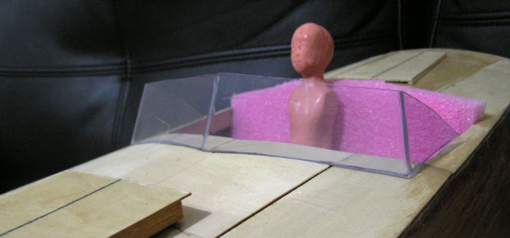

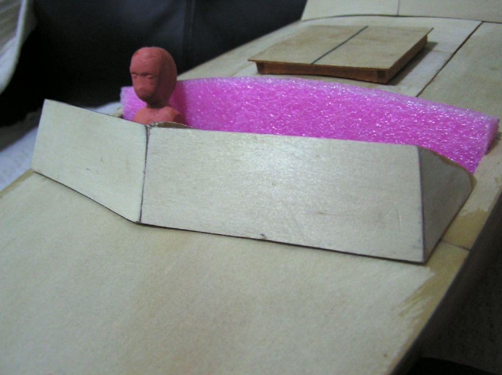

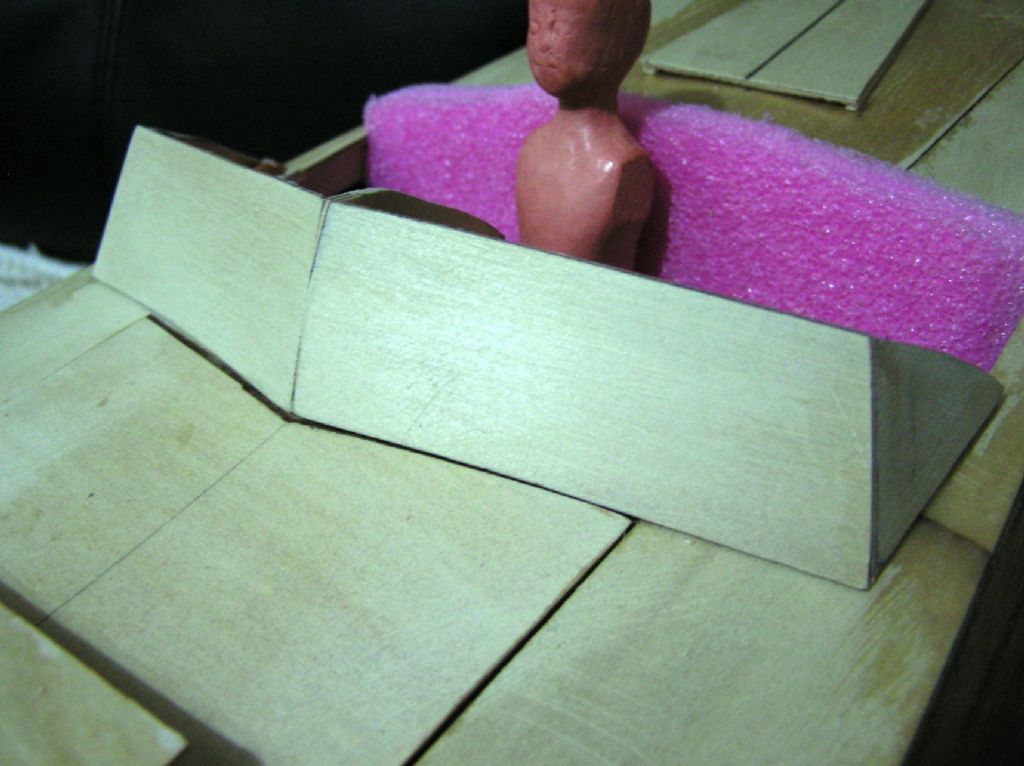

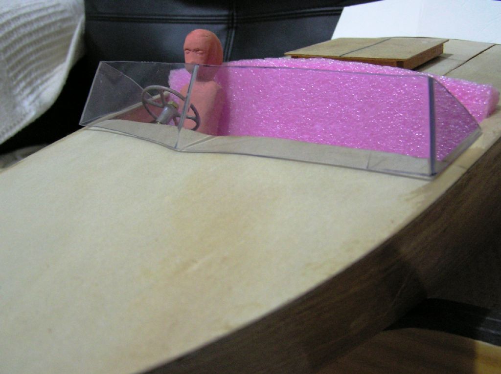

        front screen.jpgDay 23
        Made plywood template for the front windscreen.
        The first windscreen was to wide, so I re-trimmed the side in and re moulded my second.
        I used 2mm clear plastic which I clamped to one side of the template with plywood over the top.
        Used other piece of plywood to cover the other section with only a 2mm gap to heat the required area to bend.
        Heat was from a small butane torch.
        If you do not use the plywood to cover the plastic the heat will discolour it.
        I laid a sheet sandpaper over the forward deck to sand the bottom of the windscreen to fit the deck.
        This has been my first go at making a windscreen!!!
        Started on the rear windscreen and added the false transom.

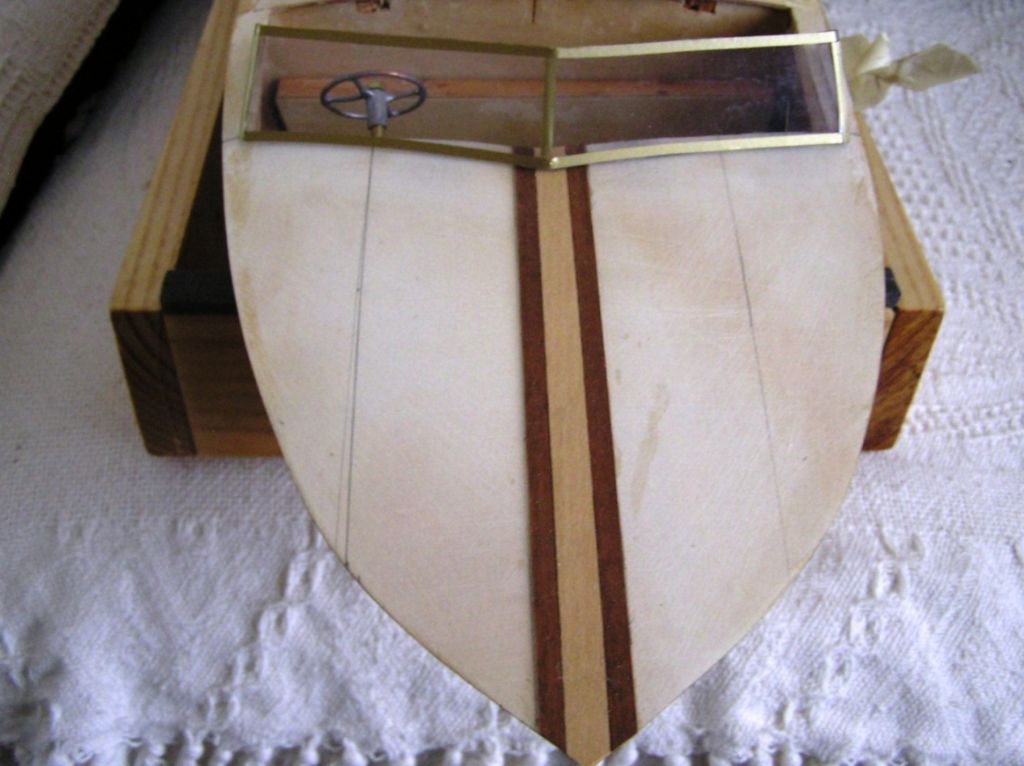

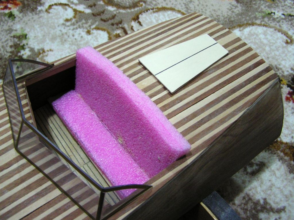

        #59828

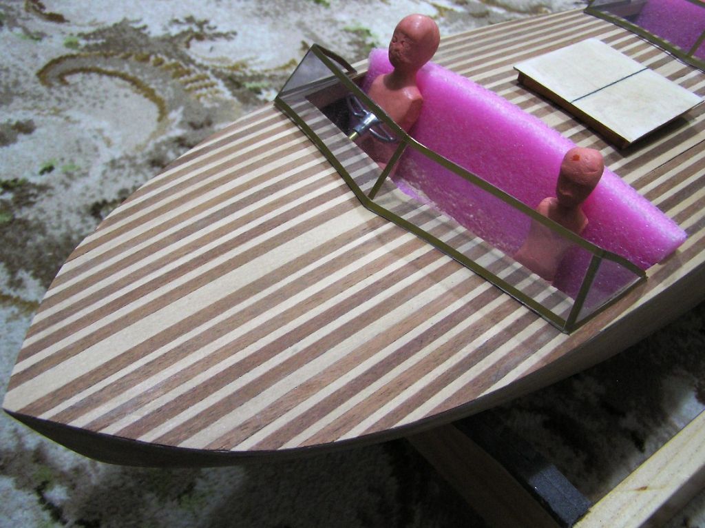

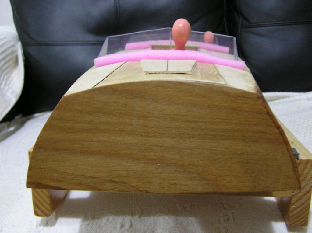

          stern false transom.jpgrear screen.jpgrear screen paper template.jpgDay 24
          Finished the rear windscreen template and made the rear windscreen.
          Looks like a trip the auto shop for some 3mm silver or brown pin striping tape for the windscreen frame.
          My mate used it on his MFA Spearfish windscreen and it looks OK.

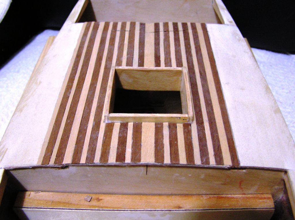

          #60389

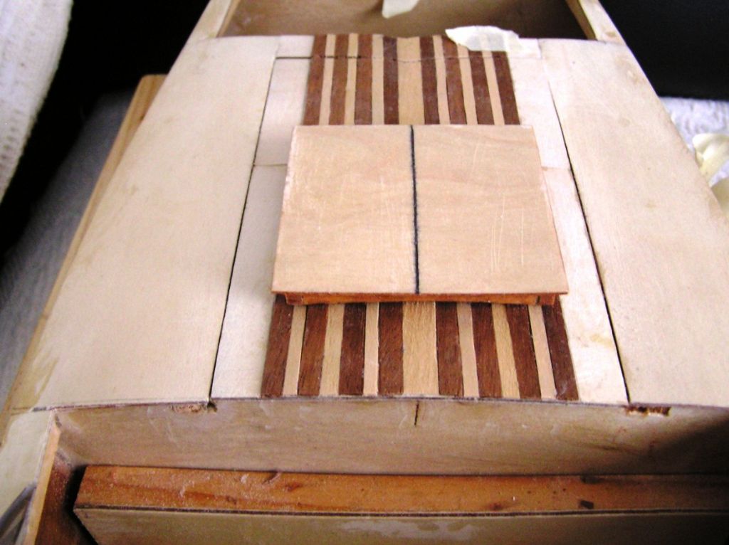

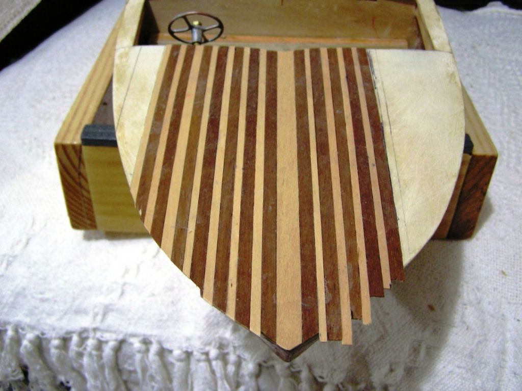

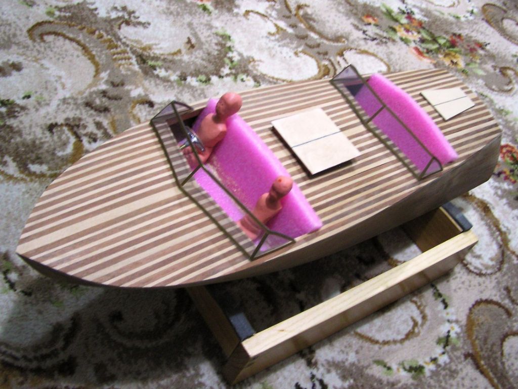

            planking stern.jpgplanking mid.jpgDay 25
            Started planking the deck with 5mm blackwood and 3mm Huon pine veneer.
            #60439
              planking stern 2.jpgplanking mid 2.jpgDay 26
              #60495
                Day 27
                Finally finished planking the deck with 5mm Blackwood and 3mm Huon pine veneer!!
                Added 3mm rub and spray rails next!!!

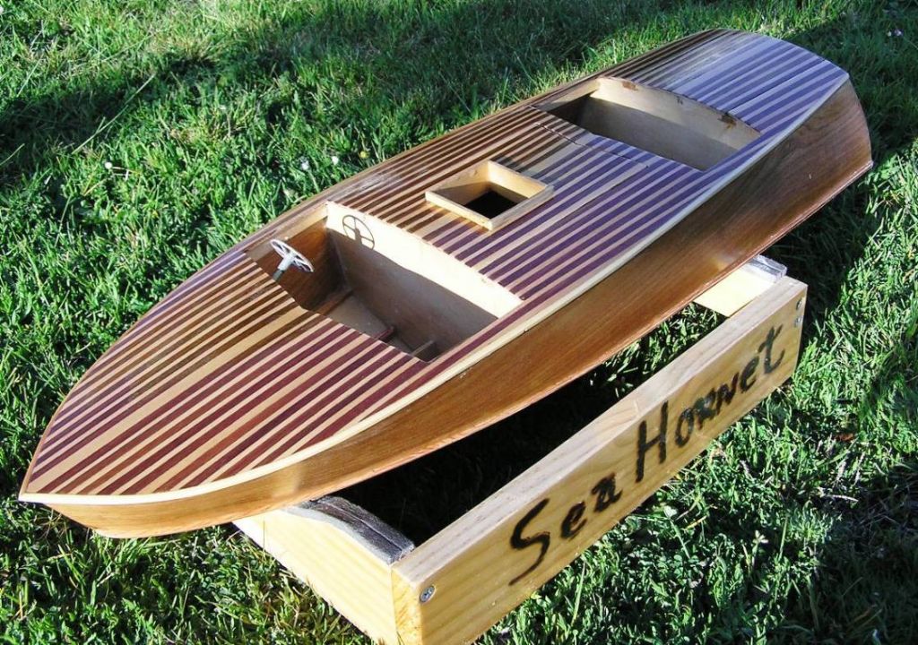

                #60496
                  h planked top view.jpgh planked stern 2.jpgh planked stern 1.jpgh planked mid 1.jpgMissed adding photos into album before posting.h planked bow.jpg
                  #60497
                    Harry. Looks nice. Would the hull ply look ok if it was sanded and a Mahogany varnish was used, to disguise the staining a bit?? seems a shame to have Mahog veneer and have to paint it.
                    Deck looks striking. Glad to see you are putting some drivers/passengers in the boat. So many people dont and I always think a speedboat, say, a Fairey, looks incomplete without a driver. Shame your passenger doesnt seem to like the driver !!
                    What sort of covering and colour are you contemplating for the cushions?
                    #60507
                      Hi Ashley
                      I fixed the stains so the deck, stern and sides will be vanished.
                      I will have to raise the spray rail at the bow a little(3mm) to hide a few bits, but, I think it will be OK.
                      I think the hatch's and hull bottom will be white.
                      Yes RED would make it go faster, but, it would not look right.
                      The figures are clay because no suitable figures available in VAN DIEMANS LAND (120 to 160mm).
                      Probably available in England, but, the cost of getting these to Tasmania would be too costly.
                      It is the same for model boat plans.
                      Installed the spray rails today, what a pain in the butt!!
                      If I build the Swordsman I will modify the hull and add the spray rails into hull like a few new deep vee's I have seen.
                      These are like a step in the hull with an angle down.
                      I had an old IC power boat with this design and it was the dries boat I raced in foot high waves off shore.
                      My mate and I are thinking of remoulding his Spearfish and using that as a basic for a Swordsman as well.
                      So short a life and so many boats to build!!!!!!
                      Harry

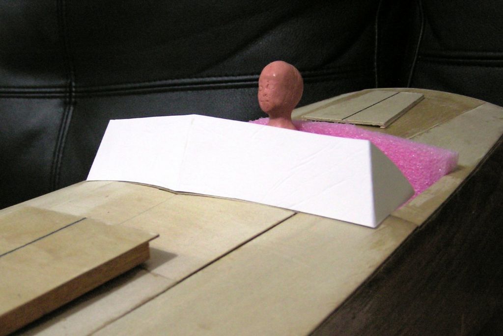

                        #60751

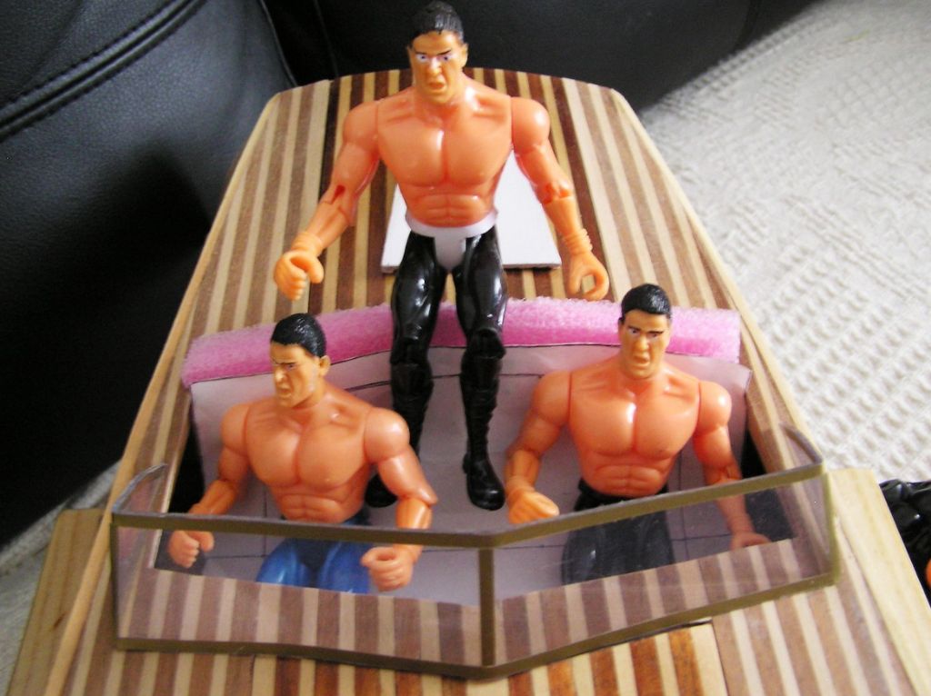

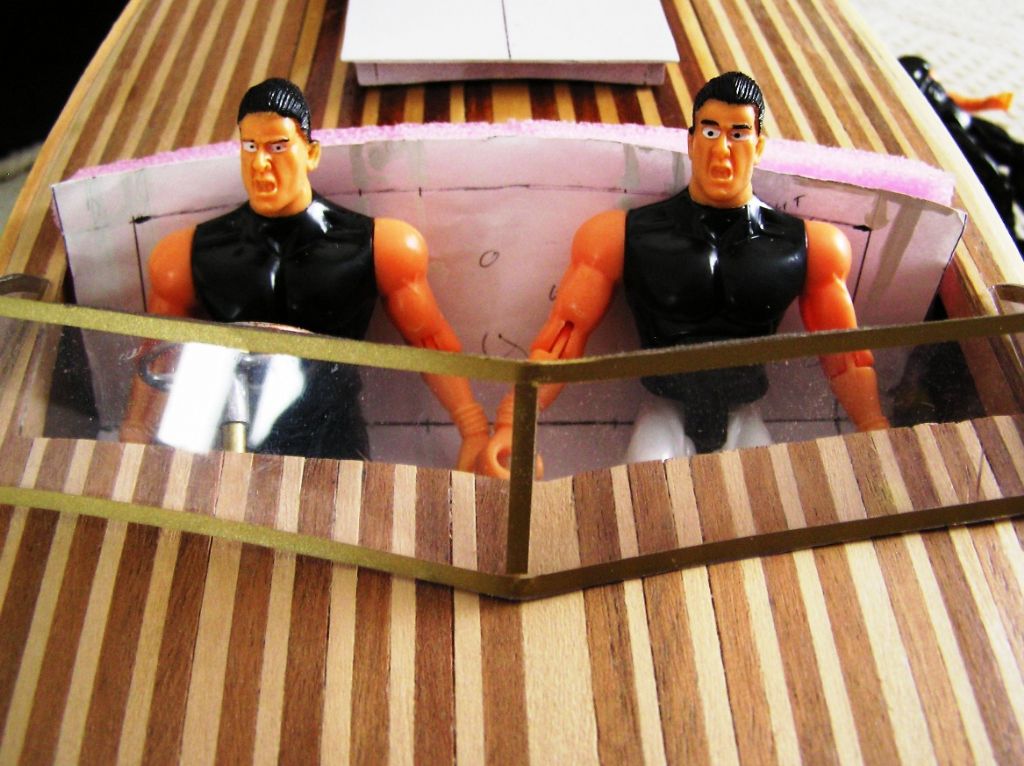

                          standard crew 1.jpgstandard crew 2.jpgDay 28
                          After months of looking for crew, finally the cheap shop(Reject Shop) wrestling figures 135mm(5 and1/4 inches).
                          So a bit of body swapping(all but one had face masks) and the magic of Humbrol paints!!!!
                          Also the right size for a Swordsman!!!!
                          The picture with 3 crew also you can see two coats of auto clear sprayed on the hatch.

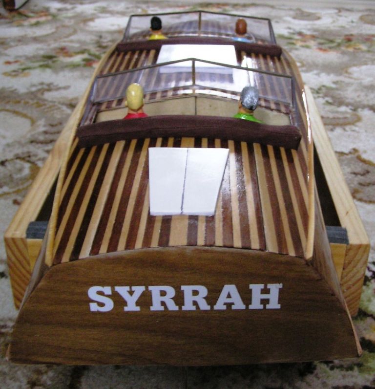

                              hornet rear 2.jpgDay 30 to33
                              Finished clear coating top, sides and stern.
                              Start on the bottom four coats of white and a couple of clear coat.
                              Had a little accident with the name on the stern, rubbing out a clear coat run and touched one corner!
                              DAM !!!

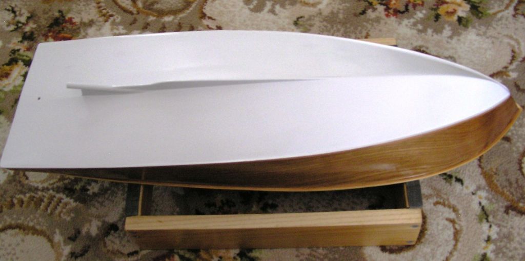

                                  #60864

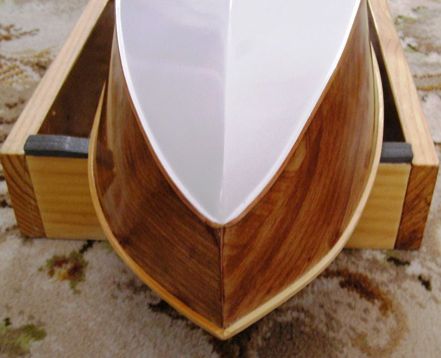

                                    bottom bow.jpgDay 34 to 35

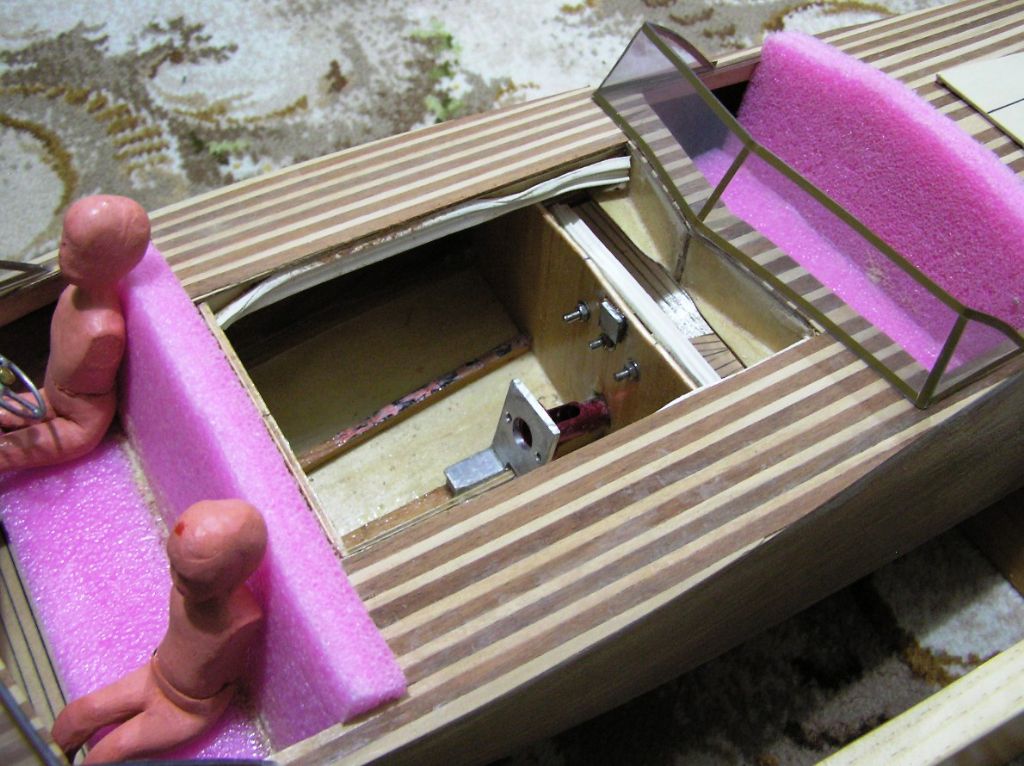

                                      I weighted the hull today with drive line and rudder installed (2lbs 4 ozs).
                                      Installed the motor and sat in 100 Amp ESC(2lbs 10 ozs).
                                      Tried a few Lipo's which added about a pound and a half.
                                      Total weight about 4lb with a 1900kv 630 watt motor!!!
                                      Harry

                                        Hi ALL
                                        Some clown did not drill the holes in B3 and B4 for the ESC extension cable(radio), also, the battery to ESC power extension cables!!!!
                                        I will not do that again !!!!
                                        Remade the windscreens(one piece) today with tinted plastic.

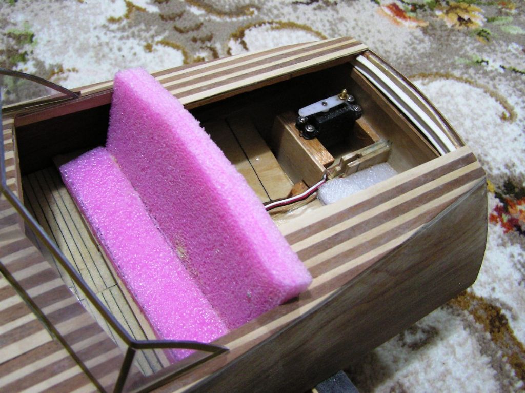

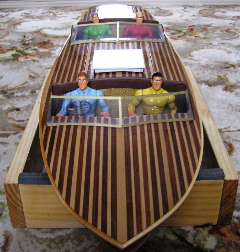

                                          Day 37
                                          Finished installing the two windscreens and my lovely wife made the two seat covers.
                                          This will COST ME DEARLY!!!!!!!!!
                                          Ready to bind transmitter to receiver and setup the ESC program.
                                          Start with a 3S 2650mah battery and 45A ESC with a 32mm x 1.4 pitch 3 blade plastic prop.
                                          Pond water test very soon.
                                          Harry
                                          #61138

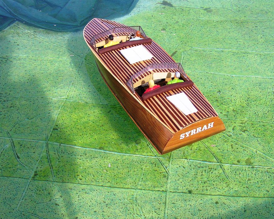

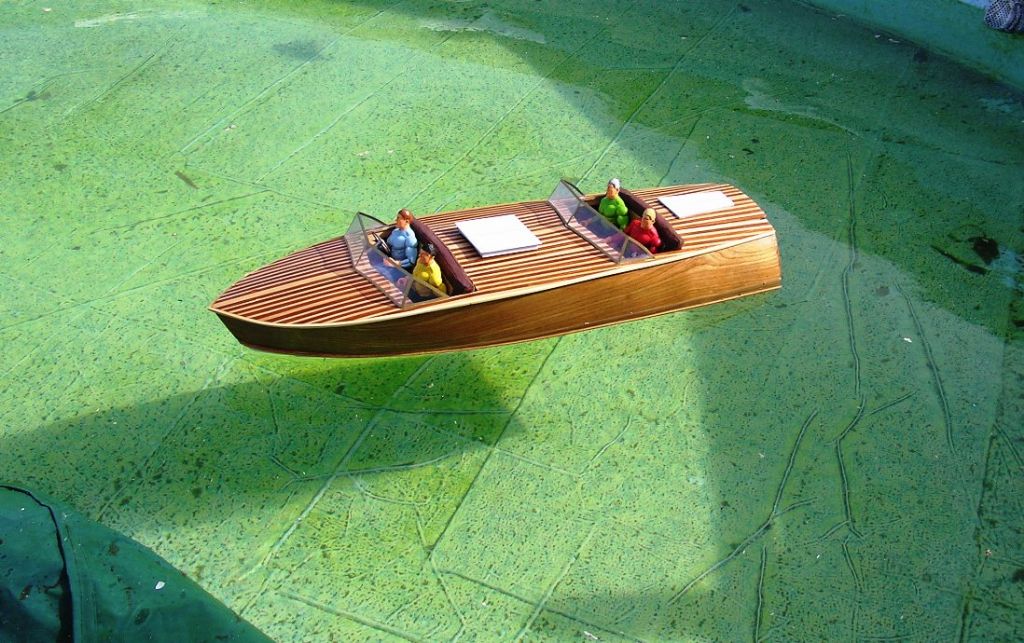

                                              test 2.jpgPool Test Day
                                              Launched today(only in a pool).
                                              No water leaks!!
                                              Motor and rudder working the right way!!!
                                              Full load power test(holding on like hell) 41 Amps.
                                              A few little forward and reverse goes to test the ESC setup!
                                              Nice slow forward and reverse.
                                              READY FOR THE BIG TEST!!!!!!!!!!!!!!!!
