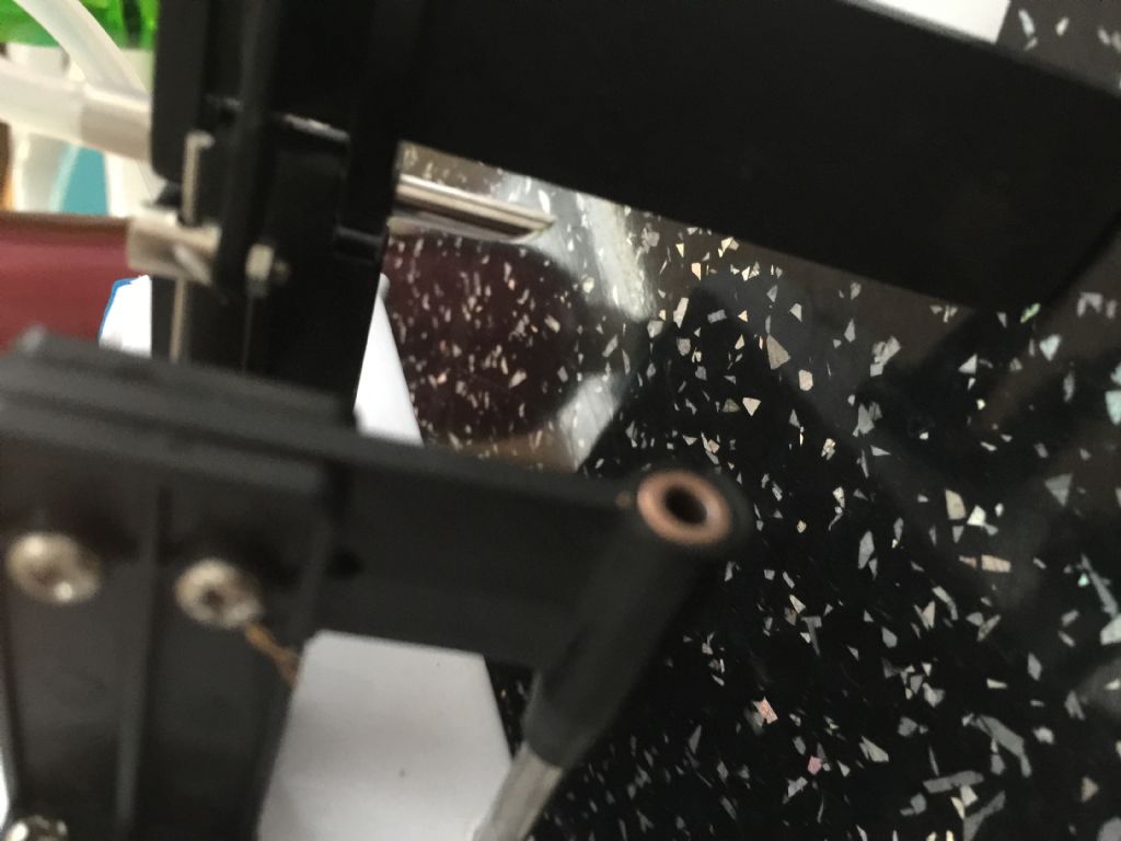

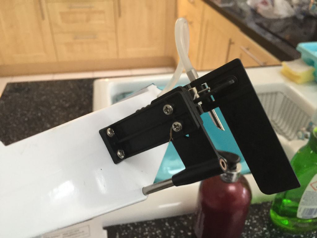

                                                  Well took it out today and this has happened.  Looked back on video I filmed at no time did it look like I hit anything.
                                                  Something missing 2
                                                  Something missing 1
                                                  Edited By chris ottaway on 21/08/2017 21:09:14
                                                  #72775
                                                  Dodgy Geezer 1
                                                    @dodgygeezer1
                                                    It looks as if you have a broken propshaft. Did you read the maintenance directions regarding lubrication, and use of loctight on the grub screws?
                                                    Edited By Dodgy Geezer on 21/08/2017 21:19:36
                                                    #72776
                                                    chris ottaway
                                                      @chrisottaway86119
                                                      I was told at the shop to spray it with WD40 which I did, has to the grub screws shouldn't have that been done when it was fitted?
