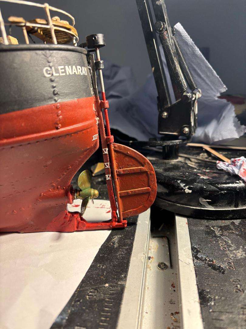

                                rudder

                                  Hmm.  I was just about to show off to you some photos of progress on my Caldercraft puffer, when another fault in the kit’s rudder area came to light… advice and help appreciated please! What appeared to be a solid adhesion between the kit’s rudder and rudder stock has, on contact with the side of the bath proved to be anything but.  The rudder now no longer moves when the ruder stick does.  This fact means that with a bit more force I should be able, hopefully, to lift the rudder stock back out of the rudder. That then leaves me with the question though of how I actually make it adhere in place when I put it back in? The bit of the keel that the rudder fits into was made by me in brass as the white metal components supplied were unusably soft and came to pieces.  It is a good kit, rudder aside! Grateful for advice on how to fit this back together in a way that ensures the rudder sticks to its stock.  Thanks!
                                  #126139
                                    Hi Alasdair,
                                    You did the right thing in remaking the keel extension. You should have gone further and ditched the rudder altogether, it is only fit for ballast!
                                    I have built a number of kits with white metal rudders and always just used them as a pattern for a more robust construction. You can see what I did with my Dean’s Medea kit below. I made a new brass rudder and soldered it to the stock then added some 0.5mm ply detail.
                                    With a bigger rudder and a thicker stock I have notched the blade and drilled through the stock tube to add a peg to give an added mechanical reinforcement. Rudders are vulnerable and need to be of robust construction. Kit manufacturers unfortunately often go for the cheapie option.

                                      Sound advice as ever, Colin! will go back to the drawing board with this one and see what I can make from brass! I take it the simplest solution here is going to be to flatten the stock a bit on one side at the rudder end and just solder it to the rudder?

                                                I have never flattened the stock, just left it to the solder to fill the gap. But if you have got a small enough drill then you can make a couple of holes through the stock and make matching slots in the blade. Then run a length of brass rod or wire through each which greatly strengthens the soldered joint.
                                                I think the kit manufacturers just cast their rudders round the stock and hope that it will create a satisfactory bond but it doesn’t really and once it comes loose there is not much you can do.
                                                #126148
                                                  An option might be to carefully drill a couple of 1mm holes right through the rudder and the stock and insert a small piece of 1mm brass rod.  Flood the pin and the joint with very thin cyano, which finds its way into every crack and gap and then file the ends of the pins flush.  Keep the cyano away from the pintles though!
                                                  That should work without having to take everything apart and should be strong enough to last.  The challenge might be if you don’t drill accurately and one of the holes doesn’t go straight through the stock.

                                                    rudder 2

                                                      Have followed your advice, Colin and am much happier with the result now I have made my own rudder from scratch from brass, as recommended. If anyone else out there is building a Caldercraft puffer, this is a good kit (with adaptations for accuracy) but I exempt the rudder and surrounding area from that praise. The white metal fittings supplied for the rudder and the structures around it are almost all unusablly fragile in a working model.
