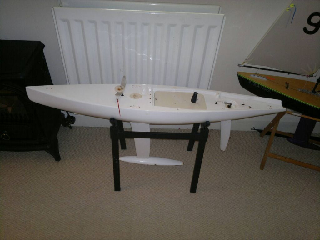

      29032013419.jpghoping this works,im trying a pic thumbs up

        hi , picture ok………..looks like a marblehead, any body help out there…..larry
        #39982
          The carbon fibre arm looks very professional and the builder is obviously a serious model sailor. I also note the locking screw that passes through the arm and into the servo wheel which ensures the arm rotates correctly and means that this critical point doesn't simply rely upon a friction connection.

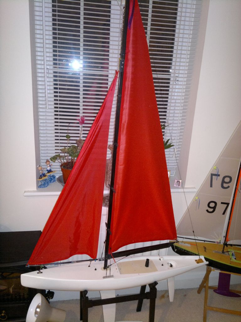

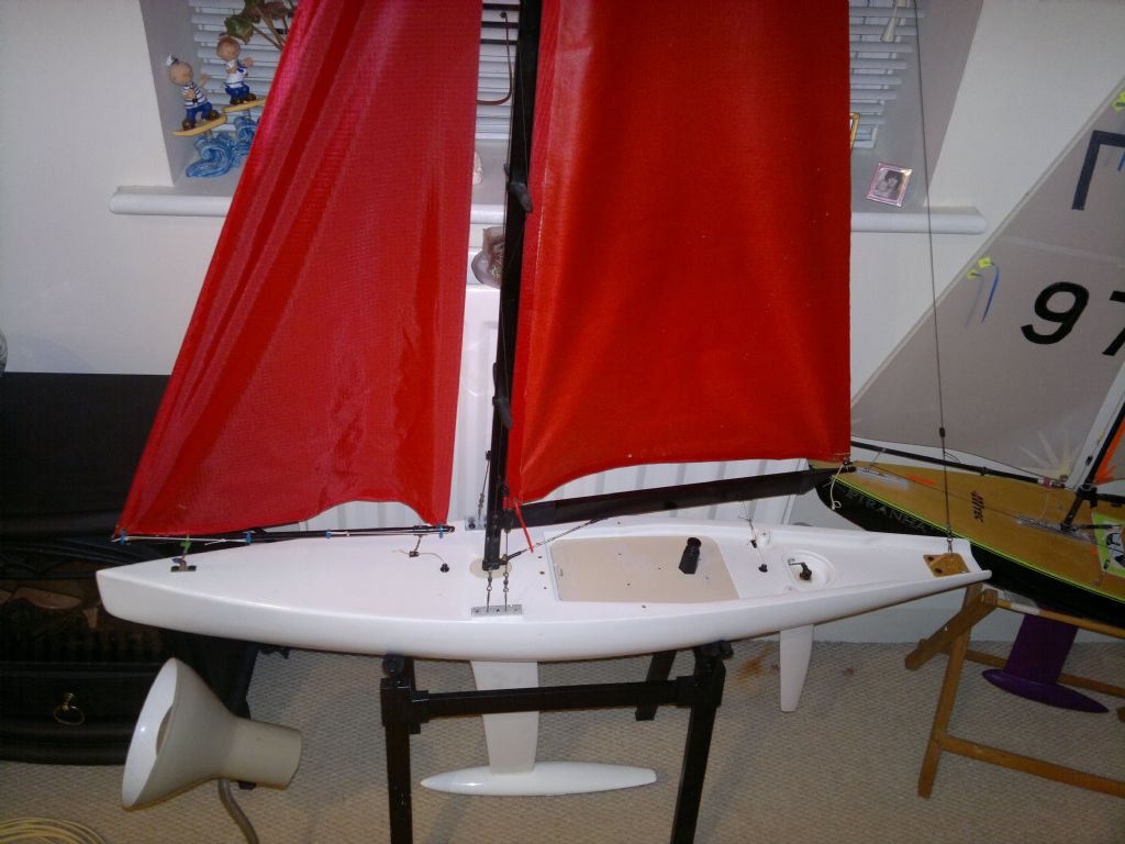

                          we nailed the mast this weekend,ive made stronger reinforced side and rear mounts for the rigging,not a lot i could do with the front one thoughlittle room for modication up there so ive used some super strong waterproof adhesive and slightly broader screws which are also glued.
                          im trying to find a close up pic of how to attach the sails to the booms,the rest of it looks pretty straight forward

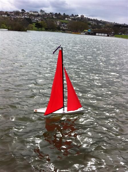

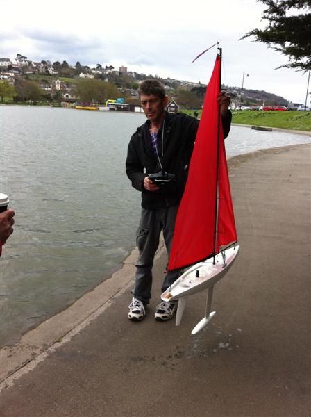

                            took my uncle down the lake for our maiden voyage today,i didnt need my spare set of clothes but do have some essential adjustments to make

                              im really chuffed with the test run,learned why it is a light wind only boat,also that my sails are too big,they seriously overpowered the rudder going sideways to the point i could only manouvre into the wind or directly away from it,unfortunately i would have beached on the island in the middle if id let it go on its favoured route.

                                    Looking good, Redsquirrel, should go well when the fine tunning is sorted, I think my next model will have to be a yacht! Well done.
