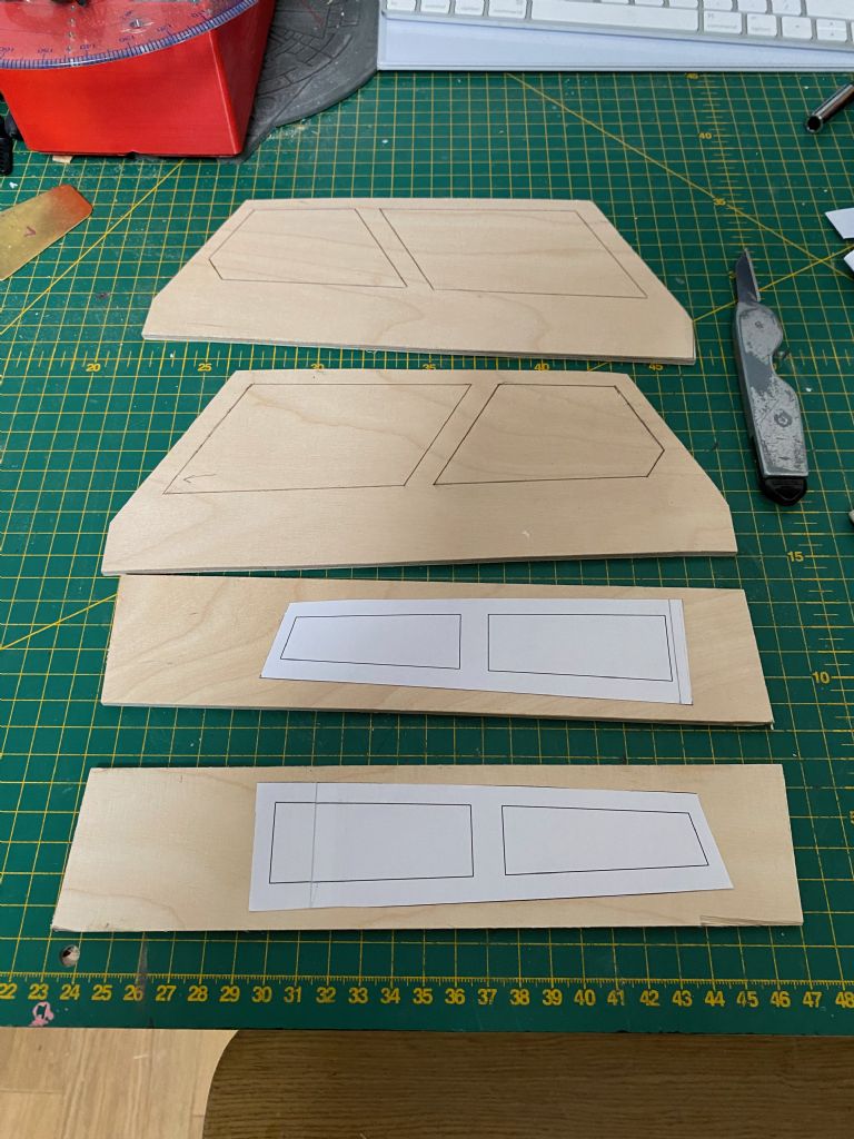

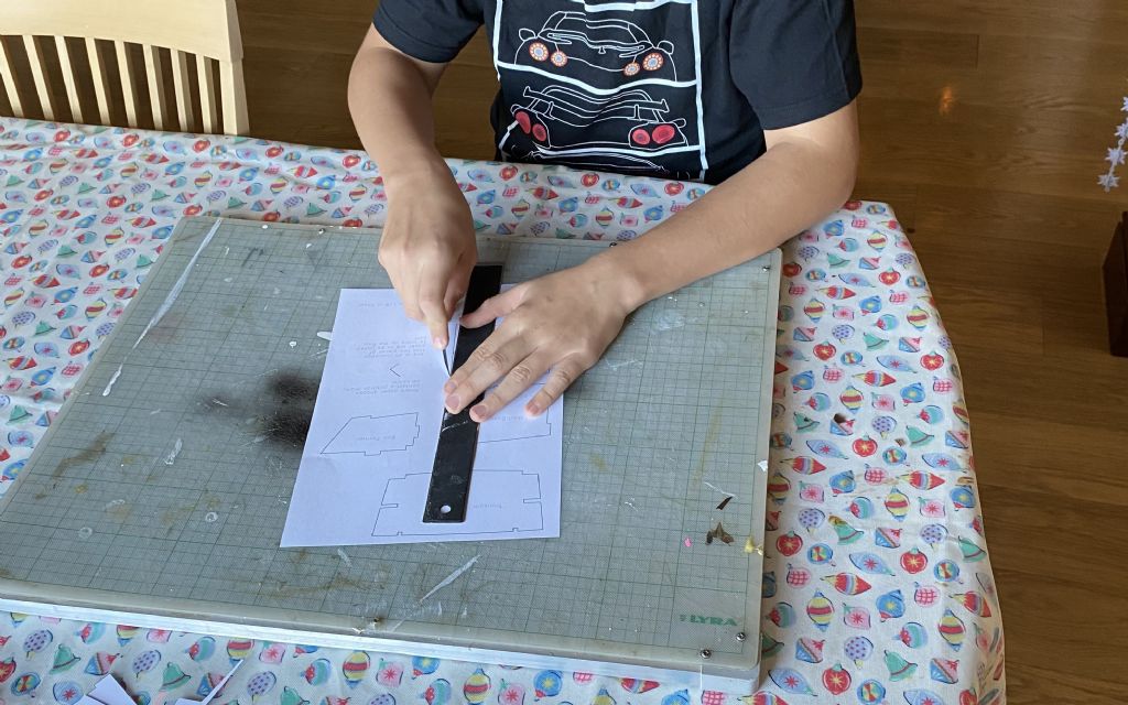

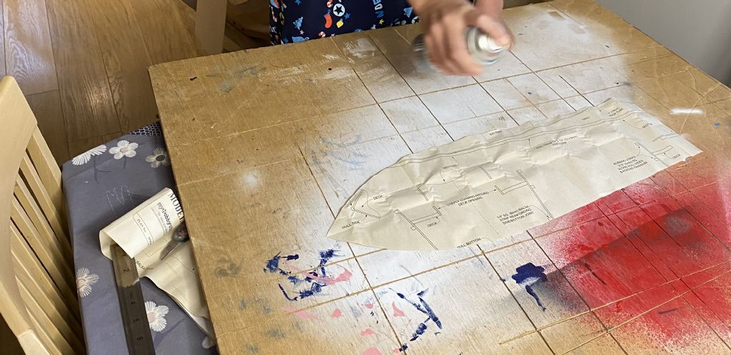

                            First actual photos of the wooden bits to follow. We have the templates cut and spray glued to the ply. Some cut out, but some bandsaw action this weekend to finish off the parts required. Then a dry fit to see it all fits together nicely, then some glue up to follow.
                            Andy

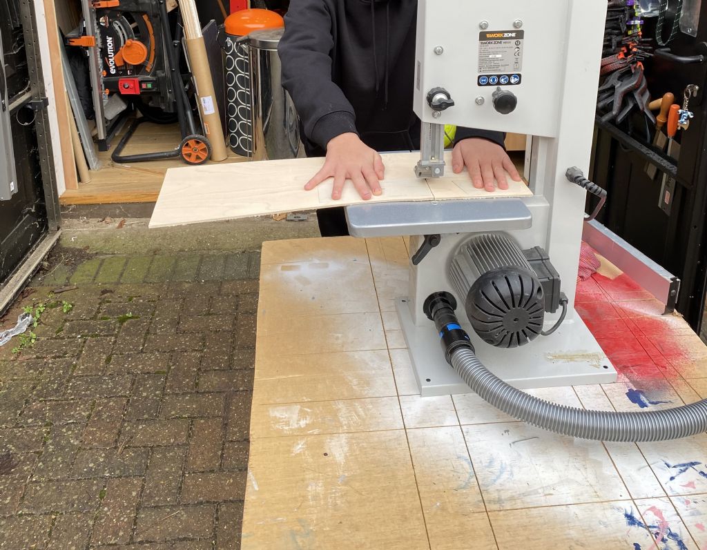

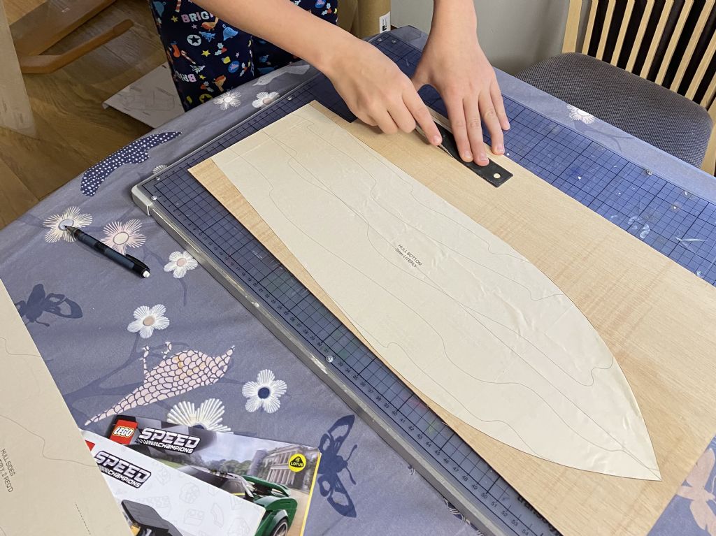

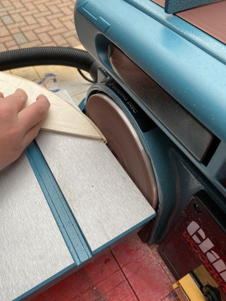

                              SandBandsawTemplate stickingFirst cutsLong time no posts, so time for an update. Plan cut out and stuck to the right thickness ply. Got Tom cutting the 2mm ply by hand and using the bandsaw for the thicker stuff. He is a quick learner and made short work of this task. Cutting close to, but not on the line.
                              Next up was a go on our new toy, belt & disc sander. Coming along nicely, too.
                              he has to upload evidence of his work so lots of photos being taken p. Now I am taking them of the wood for here as well as with him in them for school. Template cutting

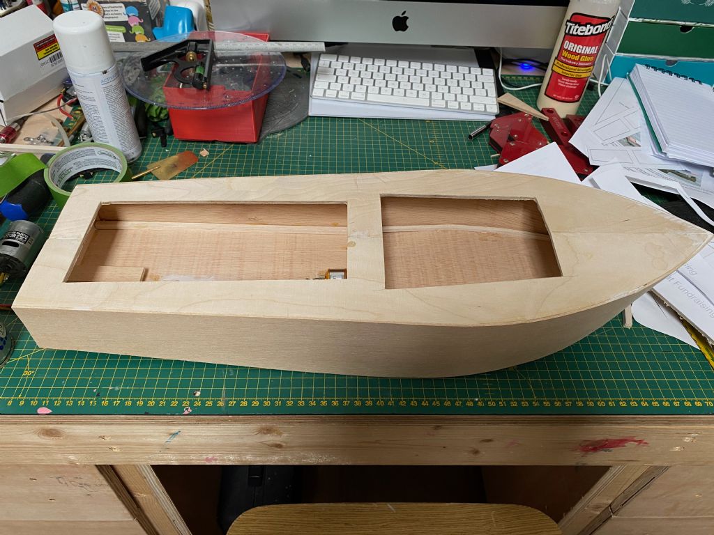

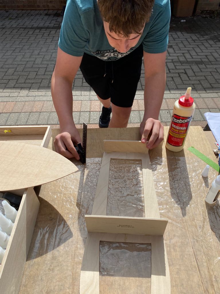

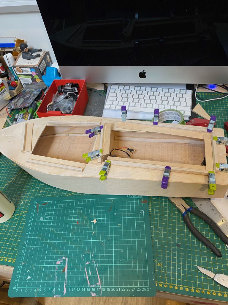

                                    Some more work on Tom boat.

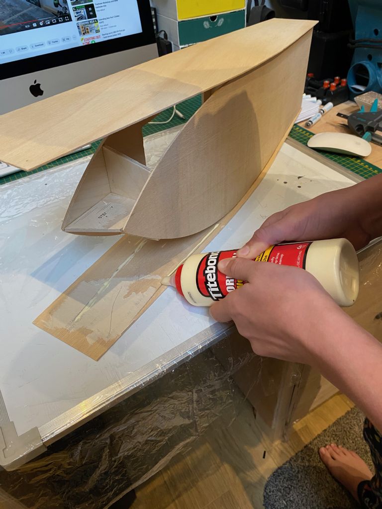

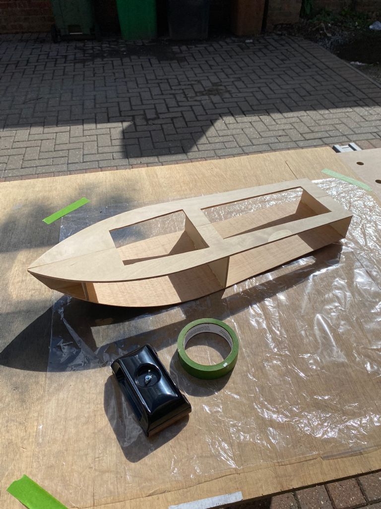

                                    Hull frames going in.
                                    frame glue up
                                    Hull Deck and botton now guled up
                                    hull
                                    Hull sides being added
                                    hull sides
                                    Hull now complete.
                                    hull complete
                                    On to the Cabin and Deck cover. This was version one. He liked the look of the Sea Spray cabin, but after cutting soon found it was not quite the right shape. Settle on a sort of modified version using the ones at the botton, not yet cut out. Some new tools in use here too. Had to drill holes in the windows and use a coping saw with a small blade to cut out the windows. Some filing and sanding to smooth things out and actually looks good.
                                    cabin v0.1
                                    Here the deck and cabin combing are beling glued together before being glued in place.

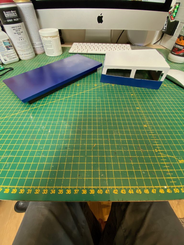

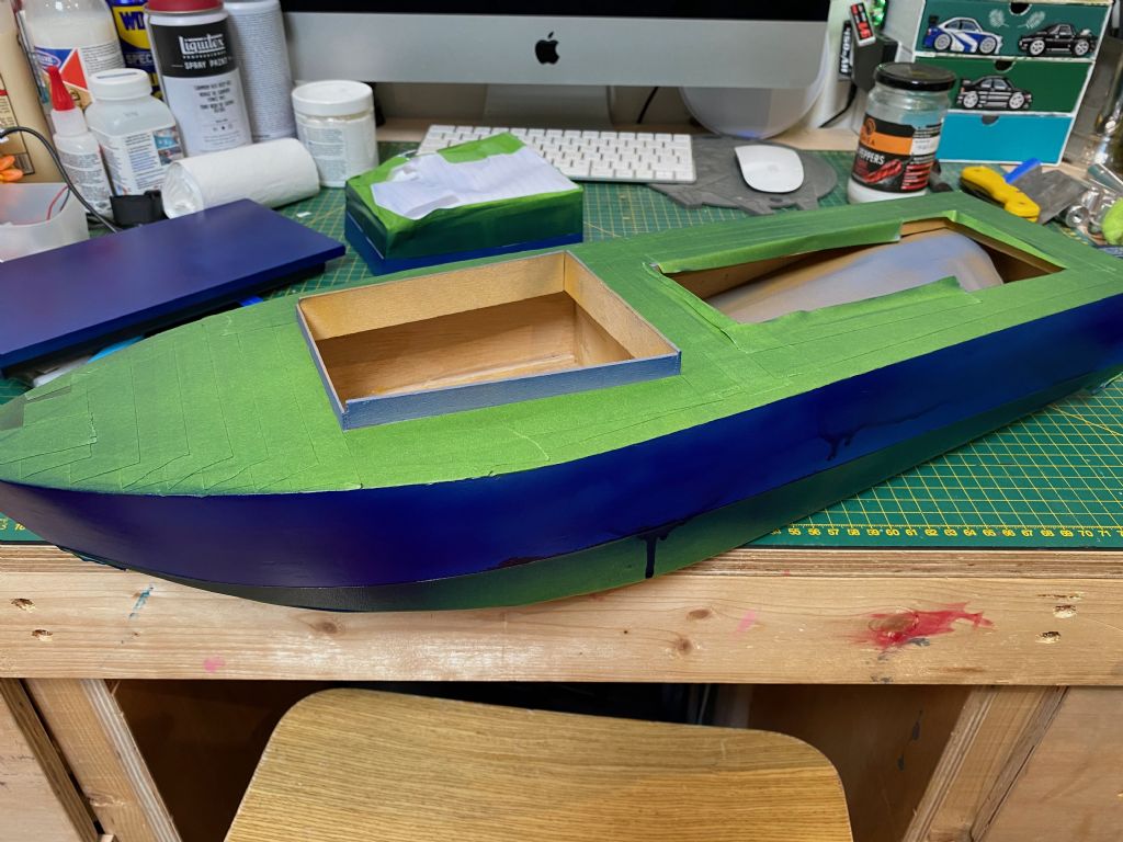

                                    deck combingNext on to painting. We have used tissue and Eze-dope to cover the hull, cabing and deck, but to be honest, although it was a good learning tool and and looks sort of okay, it is not completely without issues. Some more practice needed to get it all to a nice smooth finish. Next time maybe just a few coats of Sand and Seal or Eze-Dope followed by some primwer filler will do the job. We had a couple of coats of primer filler followed by a couple of coats of grey automotive primer on the hull and it looked okay. We did a bath test and no leaks so he is happy with that.
                                    Next up some top cots of Liquitex Cadmium Red Deep Hue, which dries to a nice flat colour for the hull and Nissan Ink Blue going on hull sides and bottom half of the cabin. We are thing the deck could stay primed grey to look like the non-slip coating on many boats, but will see once the boat is finally unmasked completely.
                                    Deck and Cabin Paintpainting
                                    The hull as you can see has some paint runs, where it was applied a little too heavily. will try rubbing down and adding a couple more lighter coats and see what happens.
                                    Over all, I must say Tom has a knack for wood working and takes to new tools really well. Were learning opportuniets made, oh yes. did he recut some of the bits, certainly, but to ave a finished boat he built himself is amazing.
                                    I will add some more pics of the electrical internals once the boat has it final coats of paint on it.
                                    Ashley.
