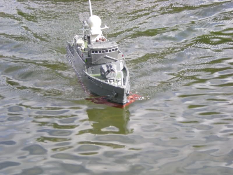

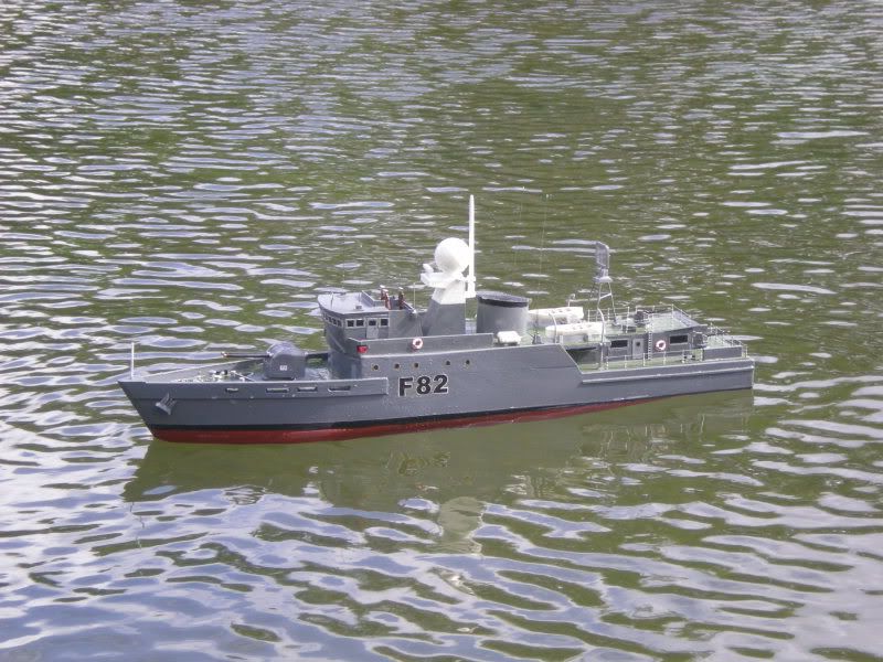

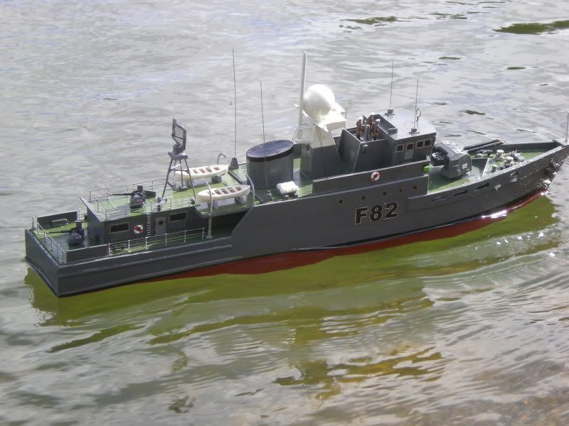

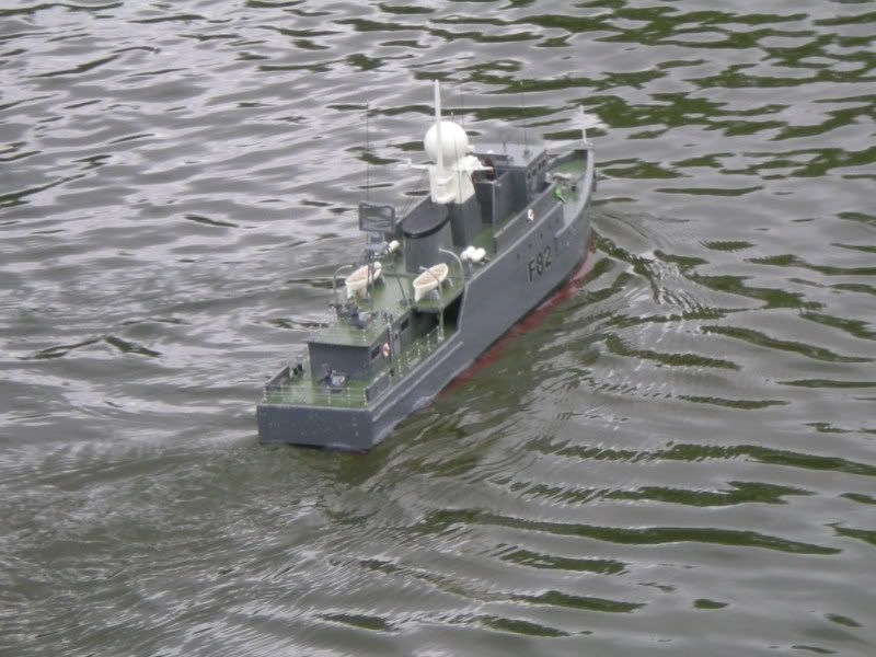

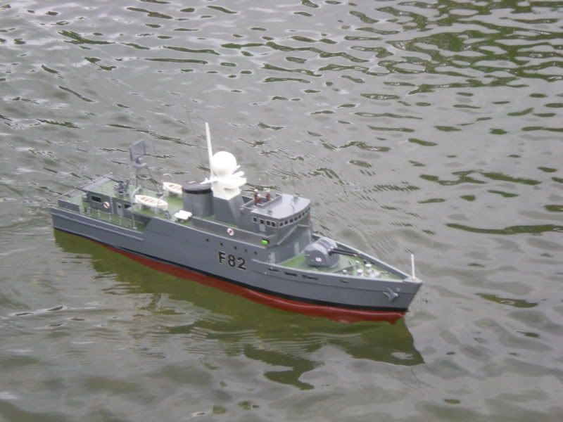

          Some up to date pics of her on the water. I’m just waiting on the flags now,and other than some final painting to be done on the hand rails,she’s finished.
          Edited By David Young 3 on 25/06/2010 00:57:37
          #27419
          Ian Gardner
            @iangardner62867
            David,
            I thought I’d just log in to say how good she looks on the water, especially cutting back through her own wake. Your boat seems to possess heft and purpose and moves very well. I’m always interested to see where people sail too – your water looks very nice.
            Ian
            #27424
            David Young 3
              @davidyoung3
              Thanks for that Ian,I’m going to be testing her later today with a Raboesch(type 1) 25mm 3-bladed brass prop,to see if I can get her sailing at a more scale speed. I’ve found that even a 30mm plastic 3-blade creates too much thrust,such that I can only really run her at just over tickover speed on the throttle,as seen on the last vid. It’s really difficult to sail her at slow speeds,as there is the tendancy for your finger to ease off the throttle just a little too much such that she stops. You only need the lightest of touches on the throttle to get her moving. I’ll post up a vid of the test when I get back.
