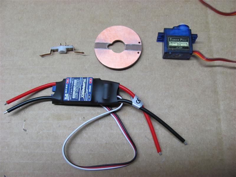

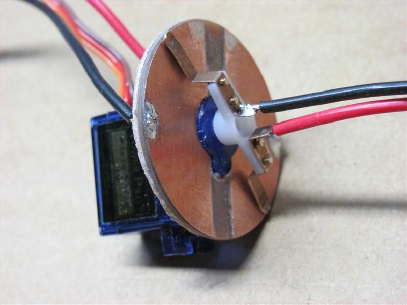

      I wanted to make a servo operated reversing switch so that I could use the cheaper aeroplane esc’s in my boats.
      The disc is made from a piece of single sided printed circuit board, the contacts on the rotor arm are made from phosphor bronze shim. The Tower Pro servo cost $3.79 US and the Turnigy 20 amp brushed ESC cost $4.95 US both were from HobbyKing Online R/C Hobby Store

          David,
          Many thanks for a briliant way of reversing small brushless motors. I shall certainly try it. As an aside I have bought quite a number of DSM2 compatible receivers and small servos from HobbyKing.com in the past without any problems at all.
          Their prices are spectacularly low and anything that helps reduce the cost of our hobby has to be good!
