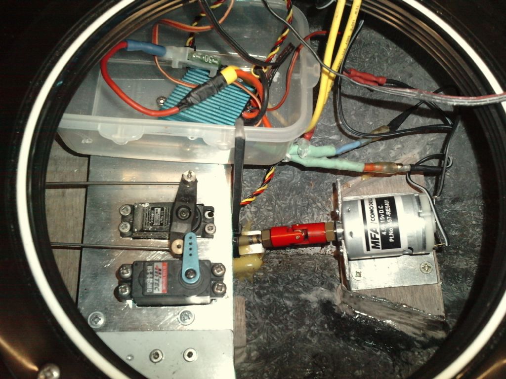

                                          ok new motor instaled . swoped the servo over to a normal one . now the servos are twitching more and more as i increase speed . and when on full throttle the rudder servo goes all the way over on one side and then the motor cuts out again . ohh and i am running 6v now
                                          #33399
                                            This sounds like a classic case of interference from the motor brushes (that MFA motor is particularly prone to it). Have you fitted RF suppressors to the motor? Could you take a photo/photos of the installation and post it here so we can see what the problem might be?

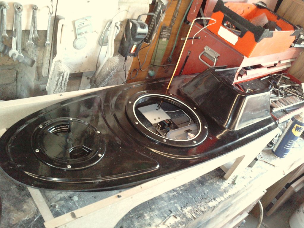

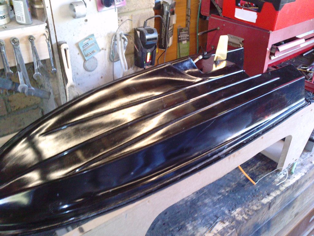

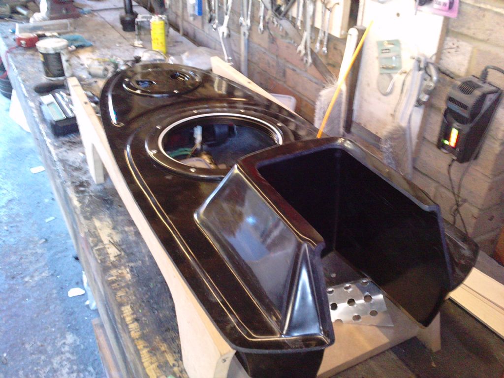

                                              andrew greenfield
                                                @andrewgreenfield50901
                                                well heres a few photos of my set up . i have used alli for mounting the servos and metal posts . these are screwed to plywood . esc is a 100amp one . just a thought could the alli be one of the problems maybe amplifying the interferance from the motor ?
                                                #33407
                                                  Andrew.  MFA do sell suppression kits… 3 capacitors, one big `un across the terminals and one each smaller ones from each terminal to the casing. If yours has one between the terminals already then just the ones from terminal to casing will have to be fitted. I have never understood why the motor capacitor Graupner sell (the yellow one) is so LARGE??
                                                  Sometimes, I find in some of my boats (as room is tight) I get interference and it`s simply sorted out by seperating the wires a bit. Try not to cross too many wires to the reciever.
                                                  To run through the list of things you COULD do..
                                                  Suppress motor with capacitors,
                                                  Ensure seperation of wires especially reciever ariel,
                                                  Earth motor body to water via a strap from one mounting screw to the propshaft body (needs a bare bit of shaft to contact the water)
                                                  Twist motor wires together,
                                                  Use a ferrite core (from Maplins for instance) around motor wires,
                                                  Use seperate battery pack to power reciever,
                                                  ummm…
                                                  To be honest, I have loads of boats and the most I have had to do is suppress the motor with capacitors.
                                                  Edited By ashley needham on 16/02/2012 20:33:27
                                                  #33409
                                                    Andrew
                                                    I suspect the problem may be the aluminium baseplate?
                                                    Temperarily remove it and see what happens?
                                                    Before going down Ashley Avenue!

                                                    andrew greenfield
                                                      Well i think it may be sorted . i have changed the mount to a plastic one . also change the motor to a 3-9v mfa . and reduced the battery to 6v/10ah . and all seems ok . all i have to do now is try it out on the lake , i would still like to run 12volts though but a least its running ok
