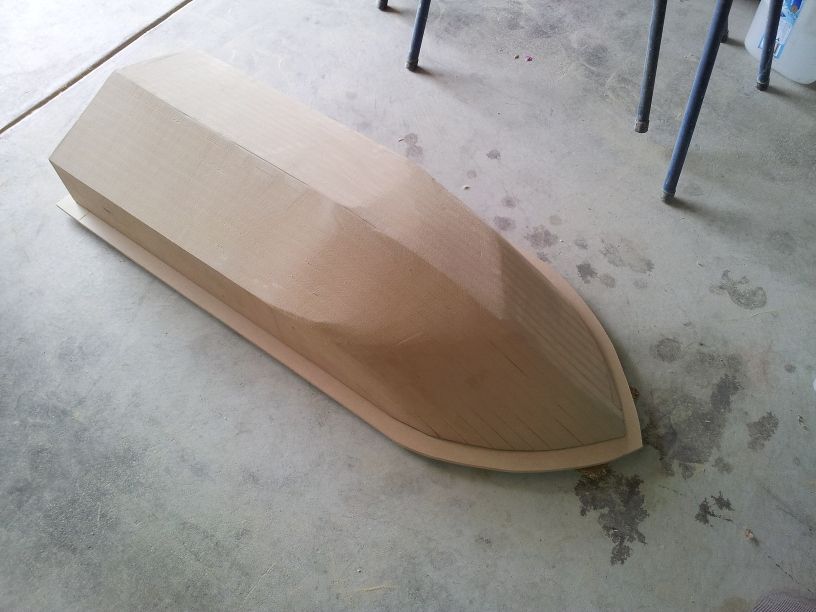

      Hi all,
      I am new to RC boats and am building a shark bait dispensing RC boat that is about 1.2m long and about 0.4m wide. I am planning to dispense baits in reasonably light surf up to about 500 metres off shore. I have been given advice that perhaps the 'Graupner Speed 720BB Torque' motor would suit my needs as I am not worried about speed at all, happy for a slow and reliable way of towing the bait out. I was also thinking about using a 60mm propeller with a 'Fixed Kort Nozzle with Rudder & 60 mm Propeller'. The boat is going to end up being fairly heavy (have so far only built the mold (see below, still needs imperfections sanded out), but estimate it could weigh upwards of 20kg in total after creating the fiberglass hull and top and adding some buoyancy foam).
      Is anybody able to advise if I might be way off the mark with the motor and prop choice?
      The boat is intended to be something similar to this one:-
      Any suggestions would be much appreciated!
      Cheers!
