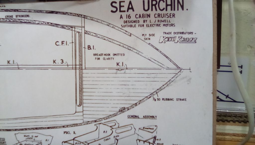

          Hello John,
          The SLEC kit for Sea Urchin is an updated version of the original Aerokits design distributed by KeilKraft, not sure who or where Roadrunners review was ? but the original design had the deck fitted after the hull sides and trimmed flush with a 1/8 square rubbing strake externally over the joint, did you have a drawing with your kit ??

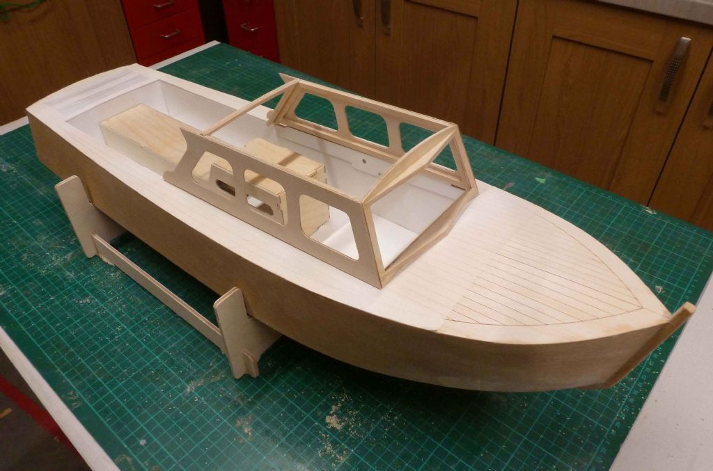

            My SLEC Police Launch has a laser-cut deck overlay which glues on top of the ply deck parts. There was an overhang of approx 2mm all round which I sanded back flush with the hull sides. The rubbing strip then fits flush with the overlay.

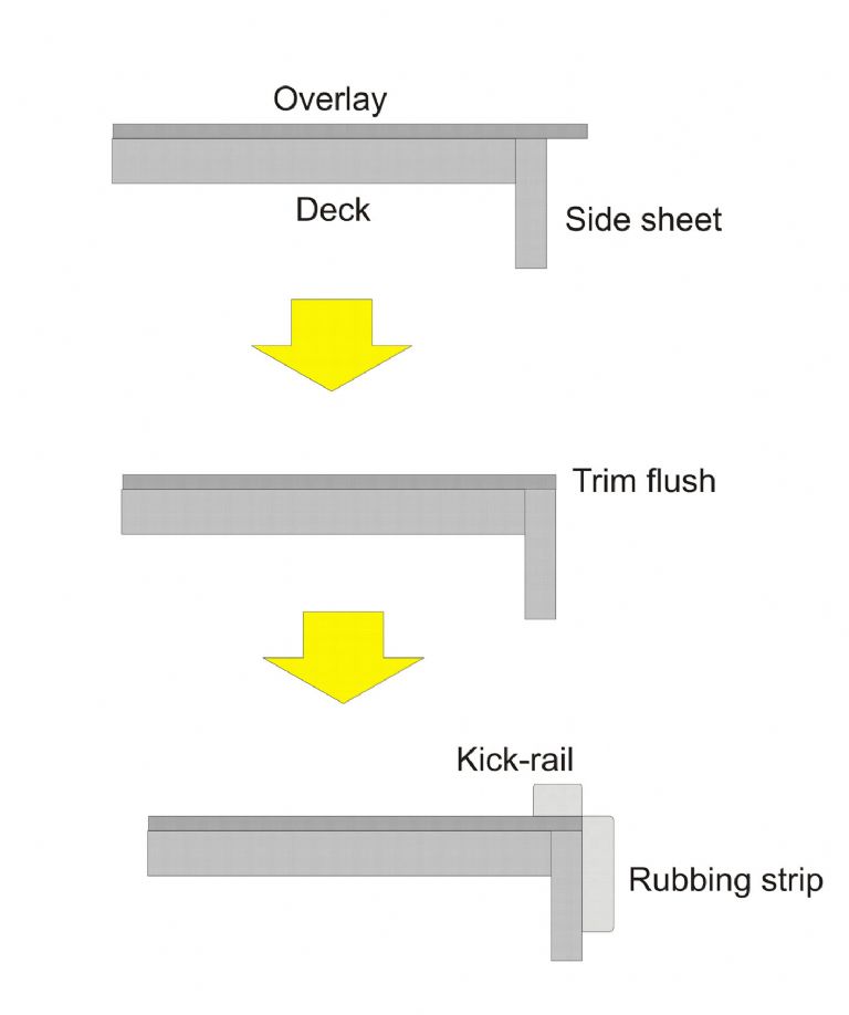

                    This is how it's done:
