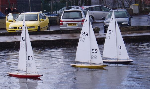

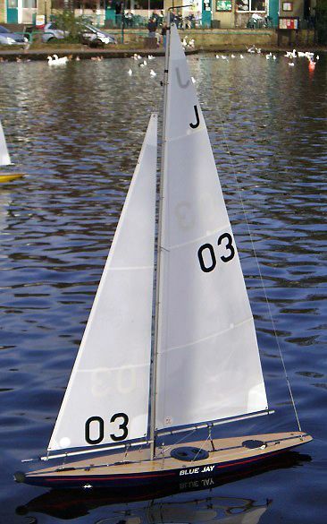

                                Back again found the pictures I had of the J class,
                                Good as well if your lake isn’t very deep .Our lake is getting more silted up very year !
                                Ducky
                                Edited By Ducky on 22/03/2009 08:23:11

                                    Ducky
                                      @ducky
                                       Hi Bob
                                      Yes I’ll fish them out and post them if Sammyk is interested in this superb Yacht
                                      Nice seeing you and your god Lady yesterday,looking foreward to seeing your JDAW on the water and having a sail whilst you take your pictures which I’m sure will be a hit on this site again.
