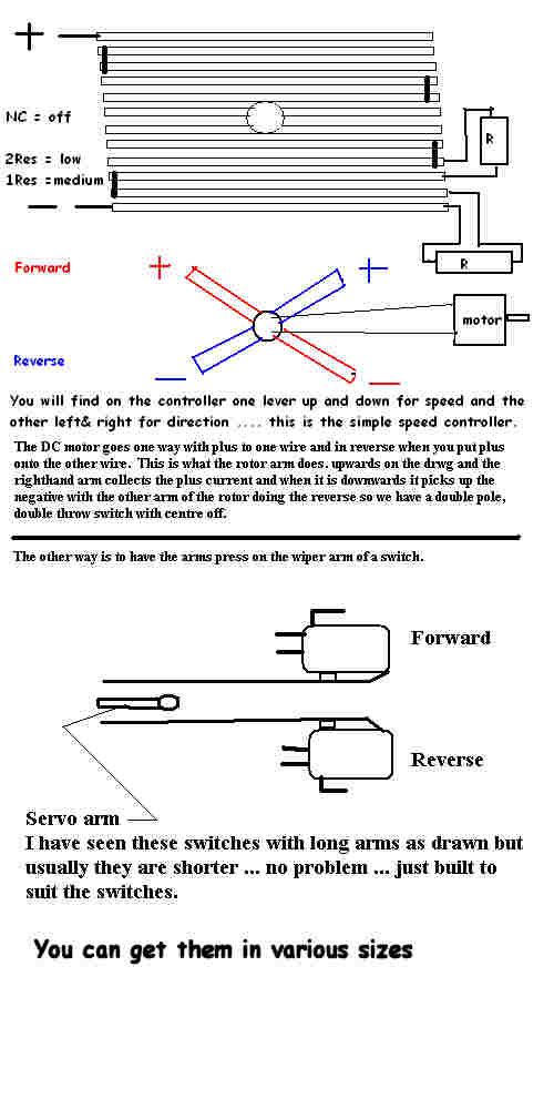

                                    It is I guess rather nice to have an electronic speed control but even at 21 sterling that is quite expensive when there are cheaper ways of doing it.     I am quite happy to work with just off,low,medium, full options in both direcctions and even question the need for more on off and on in both directions.  Though I suspect I would like to have off,medium,and full.
                                    Below are diagrams of my version of the ‘Bob’s Board’ which uses electrical strip board with a wiper and two or three resistors.   The drawback with this system is that you are draining the battery the same amount whatever speed to go at.   The other diagram is a simple on/off iin each direction which several of us think is all we really need.   Though I have some doubts and think off, medium, asnd full would be better.
                                    Our working is limited compared to the complicated navigation courses I read about in Model Boats and most time we are simply going around in circles on the pond.   We do have a harbour with wharves to practice our manouvering using prop grab etc and often we simply want a short burst of full power to halt or push us in the direction we want to go with the rudder directing the push sideways etc.  Turning the boat in little more than its length.
                                    I am working on the off/medium/full switched control but first attempt didn’t work with physical interferance between the servo arm and switches.
                                    Anyway here are the two systems so far. …

                                      Building your own speed controller is one way of getting the cost down…just keep your reciept from Maplins to show how much the parts cost.
                                      paul

                                                as far as speed controllers are concerned I don’t think you need one for this model, just some way of turning the motor on and off. Yachts don’t normally go backwards so ahead only may be all you need. Alternatively maybe a cheap resistive type if one can be found.
