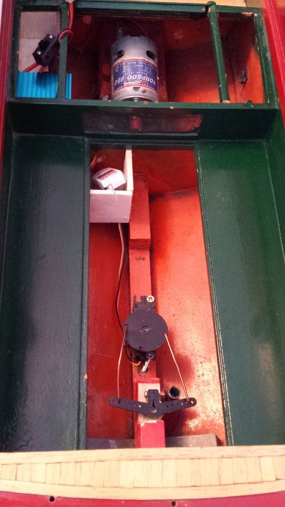

        As you can see i have a Huntsmam,Huntress or Swordsman..Im still not sure. Anyway i know its a heavy boat but i really would like it to go a bit faster. At present it goes at a very quick walking pace. It has a 850 Torpedo motor in it and is run by a heavy 12v battery. Great running time but just to slow! Looking to spend no more than £100,is that viable?

          At 4ft you could fit a petrol engine which would provide all the power that you need alternatively you could try one of these new fangled brushless electric motors.
          Could you provide a few photos of the interior so that we can see the existing layout.

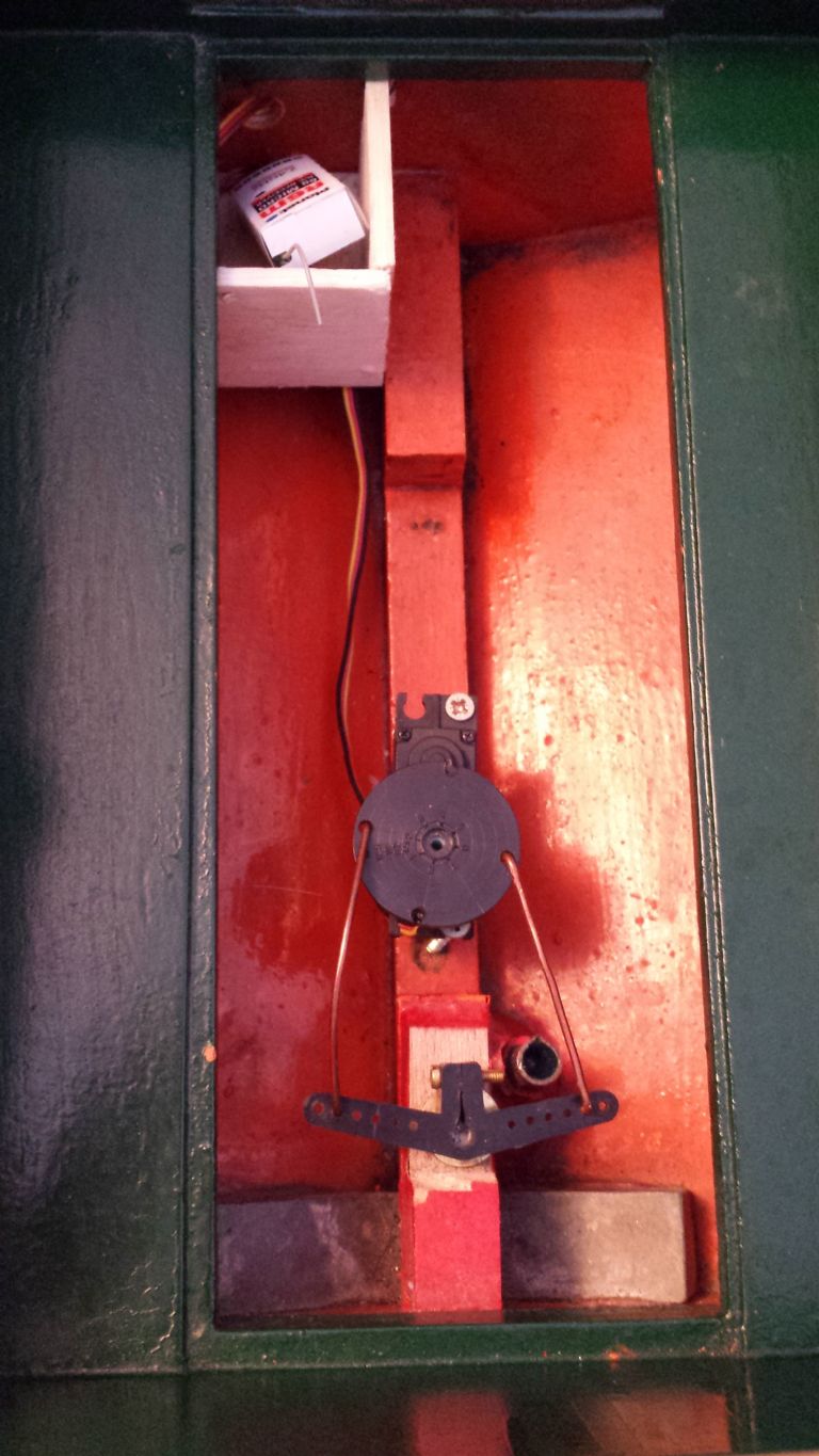

                Ok thankyou, well i have lightened the hull by removing some bits and pieces not needed. As mentioned by Paul T i have included some pics. Like i said earlier,its running a 850 Torpedo Motor,the reciever is a Planet R6m 6gb micro reciever and the speed contol is a Marine brushless. Im not looking for mega speed for the boat,but would be nice to get maybe 10-15 mph.. Now looking forward to taking it for a spin this evening at Eaton Park.
