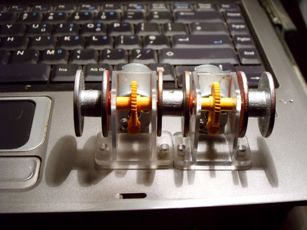

                        #26463
                        Phil Winks 1
                          @philwinks1
                          At last a little more progress towards the finish line. I was at the south west model show today and finally let Mr Milbourne of Action Electronics lighten my wallet. in return I have the bits required to complete the winch and couldn’t resist the opourtunity to get started on my arrival home.
                          Drums fitted to the motors/gearboxes just need to makea cover and wire in the esc’s then fit
                          the left motor turns the left drum only for traversing the boom. the right motor raises the boom via a pulley reduction on the centredrum and hauls the main lifting sheet on the right drum.
                          The assy will sit on the deck with the mast between the motors.
                          Phil

                            Phil Winks 1
                              @philwinks1
                              Er Bad traffic on the way home Dave.  took me two hrs to get the whole thing running and properly set up. Just to ease your mind dave the capacitors are fitted! (thanks for 2 spare ones by the way) and the Power is coming through a 3A 5v BEC via the RX so hopefully no over voltage issues with the micro esc’s!
                              Control is pretty good once you get used to it glad I went for micro’s with linear control as opposed to pico’s with soft start. and the obligatory stickers finished the job off Dave.
                              any way a quick low res video of the beast in operation. hopefully when i fit the box over it the noise will abate a little.
                              phil

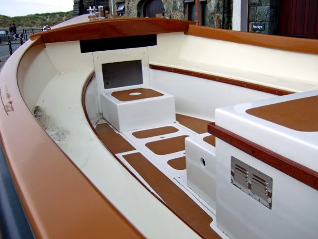

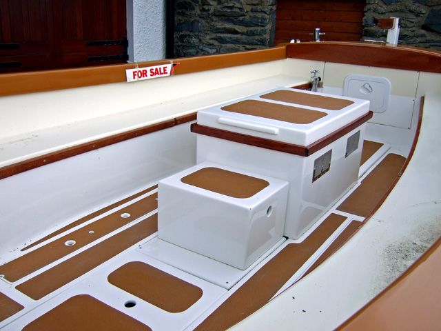

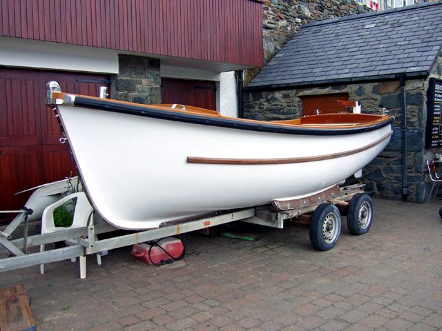

                                  #27749
                                    Hey, Phil
                                    We went to Barmouth last week and spotted a launch which could be a Holmewood Landing?
                                    Well?
                                    #27750
                                    Phil Winks 1
                                      @philwinks1
                                      My goodness thats close very close indeed! I wonder what one of them costs new?
