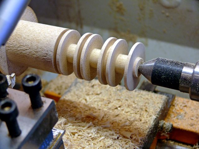

                      If Like bob you’ve had a look at my photo album of this craft you could be forgiven for thinking she is finished. However there is still a fair bit of detailing to do, upgrades mostly I want to change the rear deck hatch from a solid screwed down affair to a double hinged lid, to make access to the rx and steering servo easier. still a couple of crab pots to finish, and more fishing rods, a landing net, boat hook etc etc. one other item is a working winch to haul those crab pots onboard. Ive found the right motors and esc’s and can achieve it all on 2 channels. this pic is the design useing 2 of Dave Milbourne’s M3G motors & gearboxes one runs two drums for the jib lifting/haul rope because the jib is lifted via 1:3 reduction pulley I can lift it 7″ at the tip and with the same revolutions of the 2 drums on a common shaft the haul rope can be 21″ long from the potblock. My only stumbling block at the min is the winch drums as I have no lathe on wich to turn them
                      Given that the sizes are critical or A, they wont fit in available space & B, the combined lift/haul idea will not work as planned so who’s got any Idea’s the shaft they go on is 4mm and can be threaded.
                      #25345
                        Hello Phil
                        What size are the drums…….I `ll make them for you…..No charge, matey
                        Can`t read your drawing….too fuzzy……PM me with the info
                        #25349
                          Waiting for you, Phil
                          If we make them out of wood……..What hole would you like?
                          #25351
                          Phil Winks 1
                            @philwinks1
                            Smashing Bob 3.2 mm/1/8″ would be good then hopefully I can get a 4mm tap through them there won’t be any serious strain on them so it should work fine. You really don’t hang about do you

                                          Very nice, Phil
                                          I see you`ve painted the drums too………You might need to remove the little pips at the side……..Couldn`t do it on the lathe
                                          Your model looks very busy!……………..Bob

                                          Phil Winks 1
                                            @philwinks1
                                            Thanks for that Bob I’ve decided I’ll leave them on as I’m going to epoxy them to the shaft and with that raised bit to the inside it’ll look just about right. so just for the sake of it some more pics
