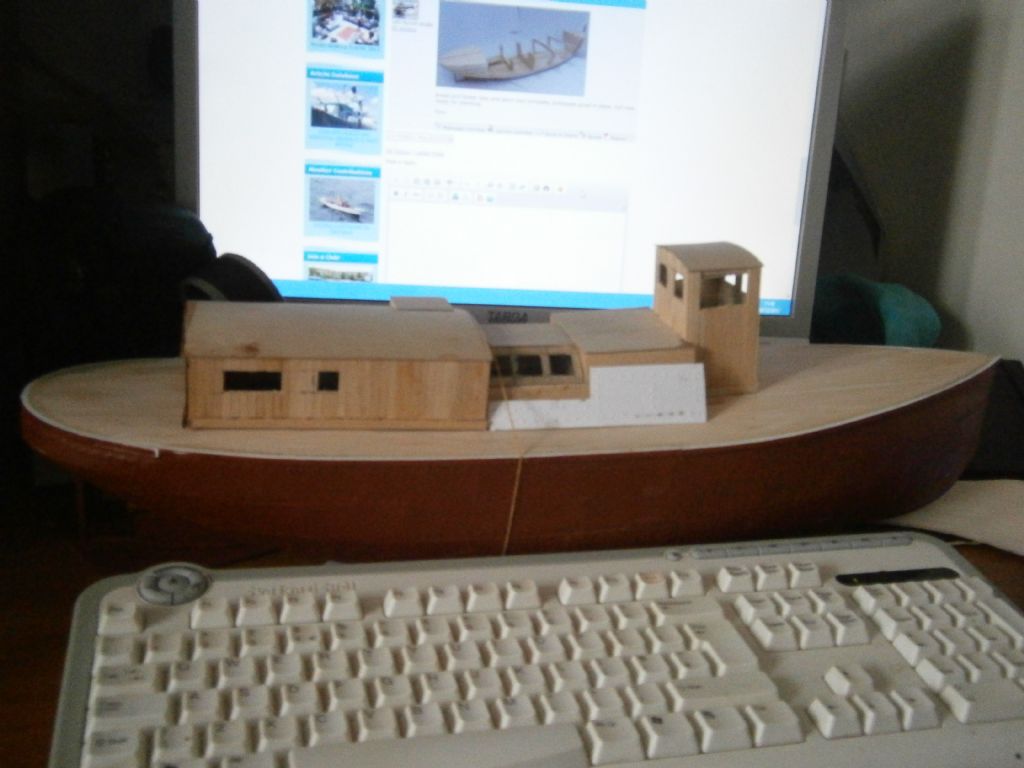

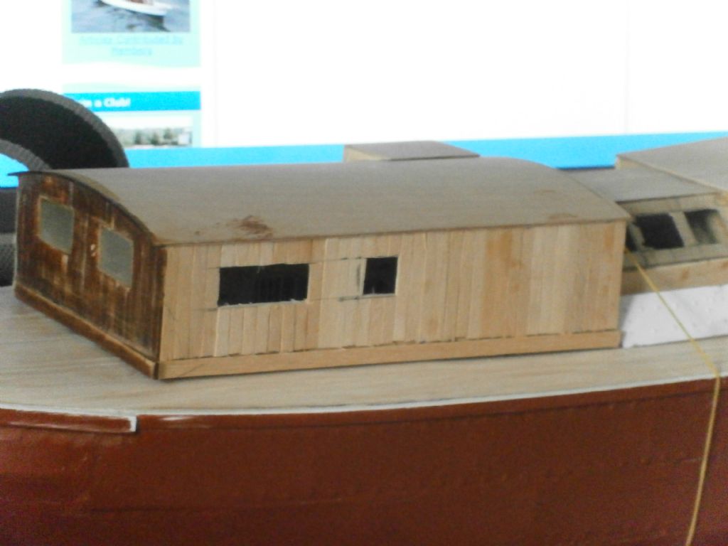

          Hello Tony,
          Happy new year….. coming on what are going plank with?…..

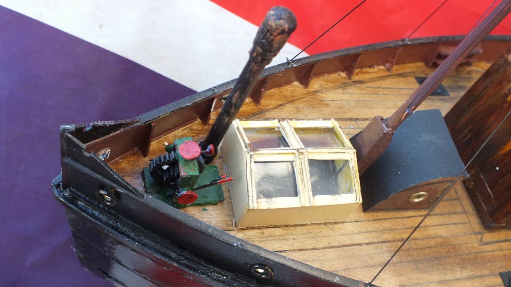

          my progress with my build so far, Bob note rivett plates on going engine house,.GAURDSMAN
          GUARDSMAN
          GUARDSMAN
          note cabin planking using coffee stirrers………cheers Larry..

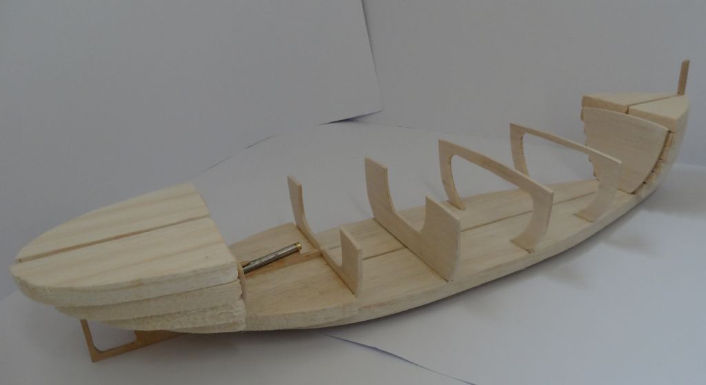

            #39014

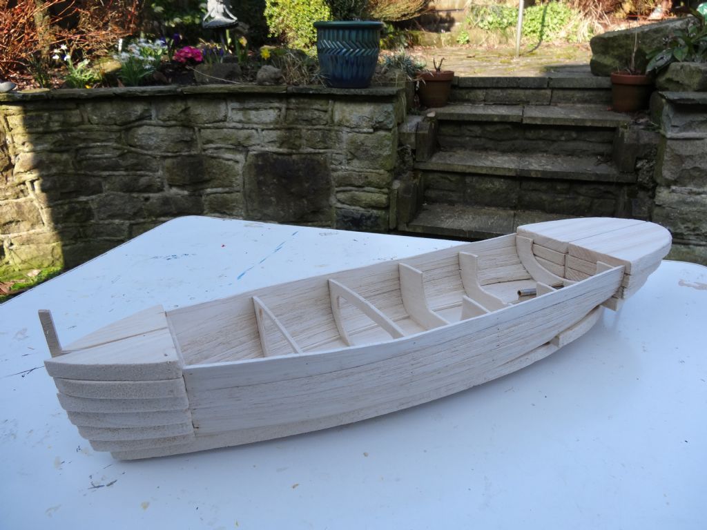

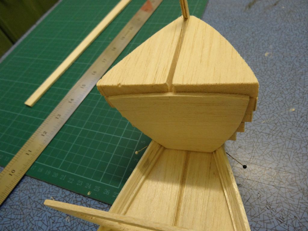

              Started to plank the central part of the hull at the bottom. Due to the radius of the bulkheads 1/8" planks are being used. As planking progresses 1/4" or 3/8"planks can be used. Time now to start to taper the planks at the ends.
              Tony

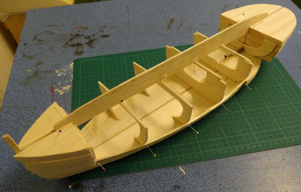

              #39015
                Hello Tony
                You need to align and secure the top section before proceeding with the planking
                That's what I would do anyway
                #39023
                  Hi Bob,
                  You are quite right, one of the bulkheads is slightly out of square and a (couple of) temporary aligning piece(s) at the top would allow this to be corrected. It would add stability as well. Thanks for the help and advice.
                  This hull is going to need a lot of sanding to shape.
                  Tony.

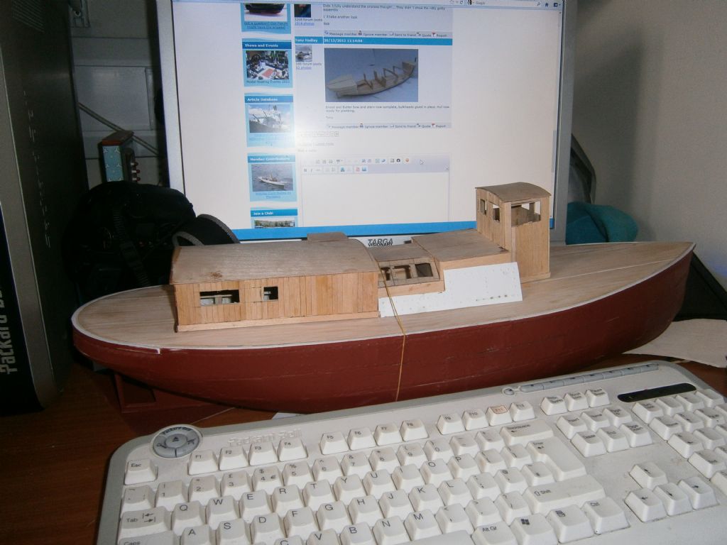

                  LARRY WHETTON
                    @larrywhetton68737
                    Hi Tony,

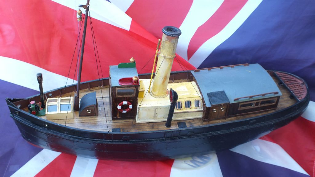

                    Guardsman coming on well,

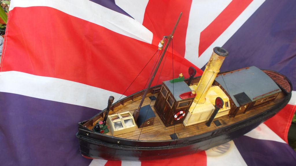

                    mine is now ready for launch with will be at half term, with grandsons Fireboat at the same time,
                    posted a picture of build stage up to the final addon scracht build bit I/E lights life boys rigging and deck winch, and a bit of weathering…..
                    also a picture of the the real boat the only one i could fine …cheers LARRY..pilot boat gaurdsman
                    GUARDSMAN

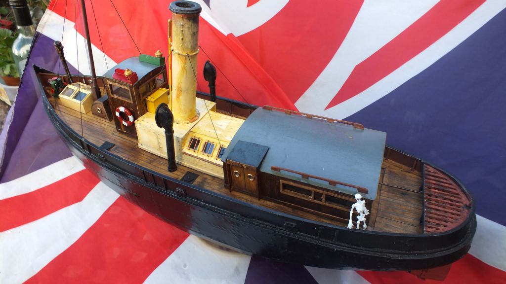

                        pictures of completed , and a strange model on slipway , being built for grandson ,
                        will be fitted with floats , so we can fly on the flooded fields . cheers Larry..

                          Larry,
                          Your Guardsman looks excellent. Looking forward to seeing the sailing photographs soon.

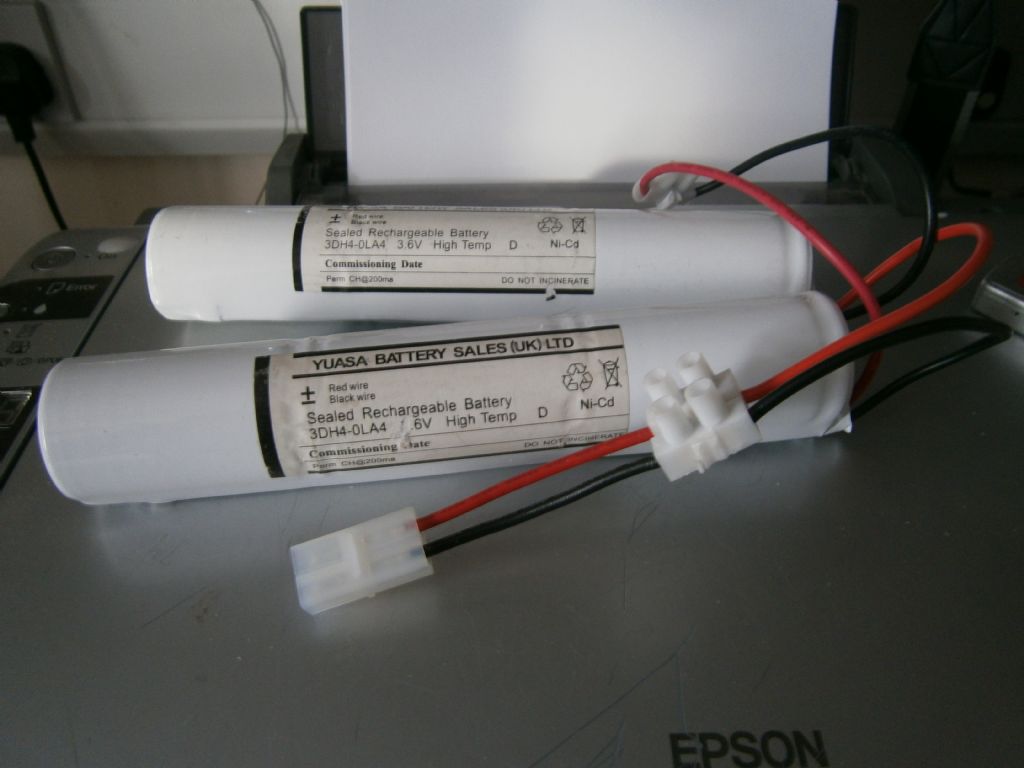

                          What drive are you using? rerop/motor/batteries etc.
                          Tony.

                          LARRY WHETTON
                            @larrywhetton68737
                            Hello Tony,
                            Thank you forkind words,
                            detials are 400 speed motor,15amp esc, 30mm nylon prop. 9vlt x2 3cell sticks of 3.6vlts
                            from emergancy lighting as used in hotels, they fit ether side of hull held in with foam sponge ,
                            new build now started , Bustler tug model maker plan , have a velem copy ,
                            and F/G HULL car boot purchase…..nice little build will have plenty of rivetts,
                            Edited By LARRY WHETTON on 05/02/2013 15:52:33

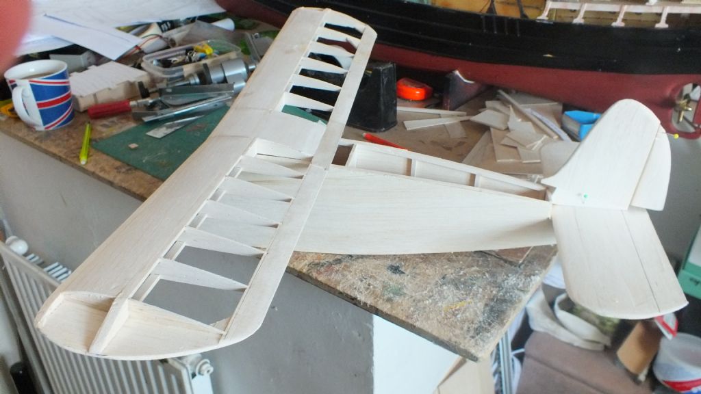

                              #39081
                              Rod smart
                                @rodsmart62545
                                Larry is the Plane in kit build,which one ? Rod
                                Edited By Rod smart on 06/02/2013 17:55:23
                                #39082
                                LARRY WHETTON
                                  @larrywhetton68737
                                  Hi Rod,
                                  The plane is a plan build , of Chatterbox a plan of Vic Smeed. for single chanal
                                  the price of the plan was 3 shillings, i am fitting a 2 chanal and elecric motor ,esc…
                                  and will have floats , i can back to my early roots , forgot how nice a uncovered air frame looks..
                                  cheers Larry…

                                        Continued with planking at the bottom after making a temporary support (and bulkhead bridges) at the top, similar to the one which Bob suggested. Support was made from hard balsa, glued, pinned and taped in place. This really makes the whole hull much sturdier to continue with the planking – Thanks Bob
                                        I won't bore you with any more photos until the planking is now completed.
                                        Tony.
                                        #39132
                                          Well done. Tony
                                          A quality job now
                                          Glad to be of help,,,,,,,,,,,Bob
                                          #39139
                                            Forgot to mention earlier, the support also allowed the slightly out of square bulkhead to be corrected. It was only slightly out of square and wouldn't have caused any problems and wouldn't have been seen, but I would have worried about it.
                                            Thanks again Bob. Any news on Glasgow?
