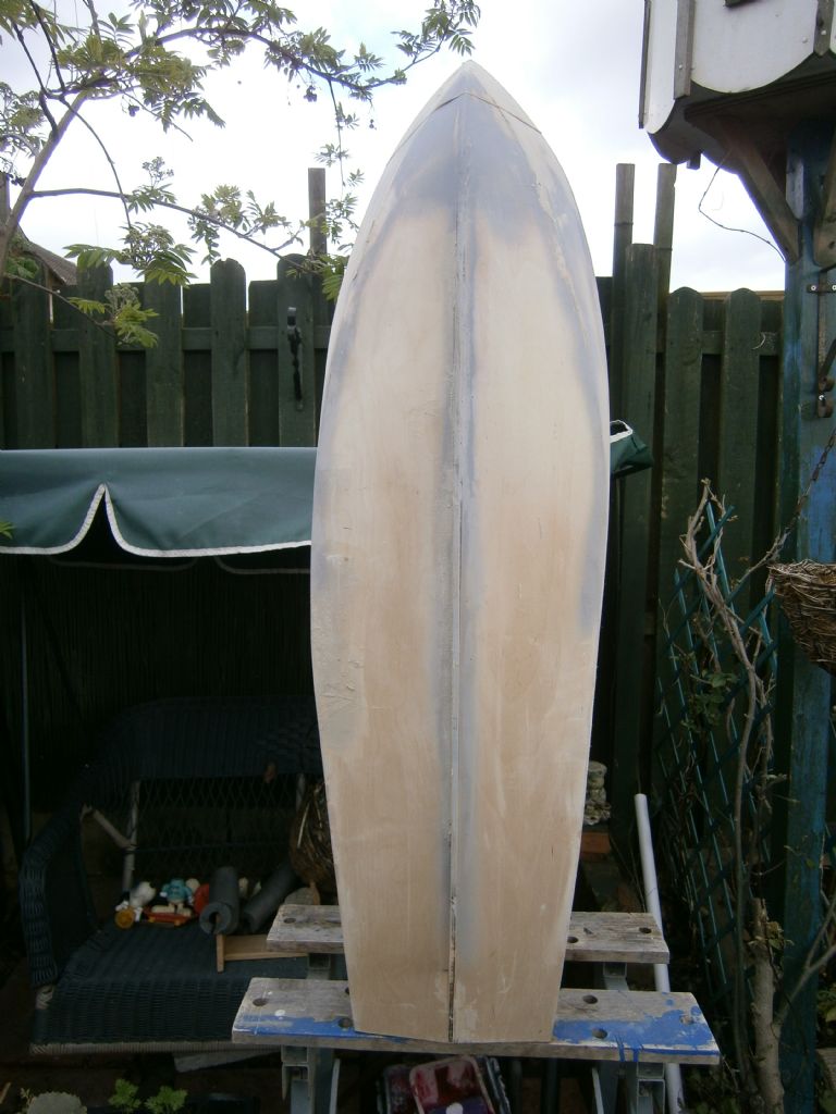

      Hello all,
      This is my first post and indeed my first venture into model boats.
      A little background….
      My sister and I have acquired a Sea Queen model boat as seen here: http://www.cornwallmodelboats.co.uk/acatalog/sea_queen.html
      However, ours is a little bruised and redundant on features as you can see here:
      http://imageshack.us/photo/my-images/17/photo2800.jpg/
      http://imageshack.us/photo/my-images/171/photo2801.jpg/
      http://imageshack.us/photo/my-images/88/photo2805.jpg/
      http://imageshack.us/photo/my-images/221/photo2803.jpg/
      As you can see there is a bit of work that needs doing. I am attempting to sand the paint down and clean up the inside then restore with paint and some kind of 'varnish' to give it a waterproof cover. My sister's keen on the film 'The Life Aquatic' and wants it restored accordingly in the colours portrayed in the film.
      There is a small hole, about 1cm square on the starboard side which I assume can be repaired with wood filler?? Any ideas?
      Finally I have some old Remote Control devices from a model car which I assume that I can use to power the boat, not looking for any speed as such, just something that works okay and looks the part, the prop will be driven by an electric motor and have a Servo arm linked to a rudder.
      So, any ideas on how to sort this fine vessel out?
      Help would be much appreciated, I will update with progress in die course,
      Thanks in advance,
      Ed.

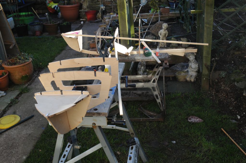

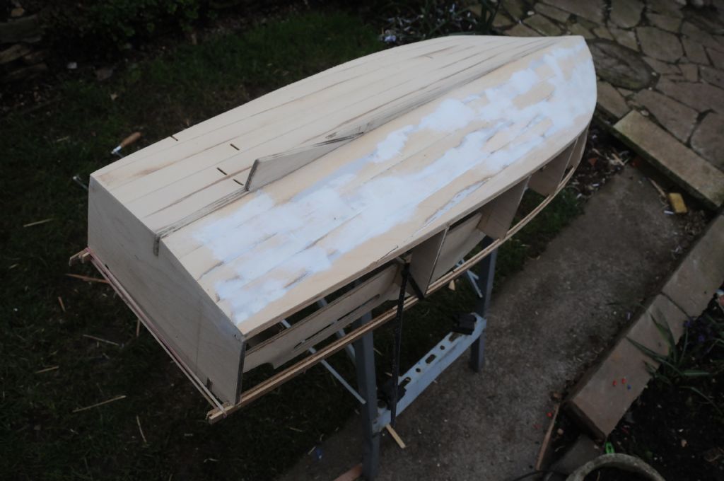

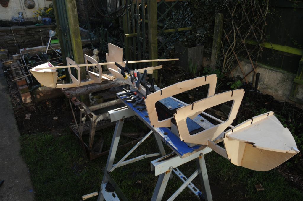

                I can find your pictures to view the state of Sea Queen ,
                if the skins are allin place , try a running a coat of polester resin round in side hull
                just poure it in and then move the hull to get in all the nooks and crannies use a pait brush to coat remaining , also poly varish can be used. i do this on all my hulls plugs any small defects and gaps, here is exsample of a sea queen i am building at the moment using plank on frame using Ikea blind slats se pics ….larry …..sea queen

                        I am currently sanding the hull down, and cleaning her up, the hull paint is actually quite bright and in good condition once the grease and dirt had been removed. I checked the hull for leaks and she seems to float without any water intrusions so thats good.
                        Thinking of fitting the inside with some plyboard for mounting points using the side ridges (running from the bow to the stern) as the existing points in the middle are in bad condition. The R/C motor and Servo is from a Tamiya Fighter Buggy RX, which shouold be okay in my estimation.
                        Any ideas on what to replace the window glass with and where to find any accessories? As there is only one segment of the glass remaining, looks like quite thick glass tbh so I am assuming that the model is actually quite old.
                        Cheers in advance,
                        Ed
