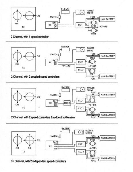

                      I am building the Slipway Range Safety Craft. It also is to be powered by 2 Graupner Speed 600 ECO motors. I was going to follow the wring up instructions given by Slipway which show the motors being powered by 1 battery. Your plan to use a battery for each motor is what I would love to do but dont know how. Would it be possible to somehow see a wiring diagram.

                        http://www.modelboats.co.uk/wp-content/uploads/sites/5/images/member_albums/2522/NewWire2_1.jpg
                        Hi Geoff, Wiring diagram of the 4 most common set ups – hope its of some help – regards Ken
