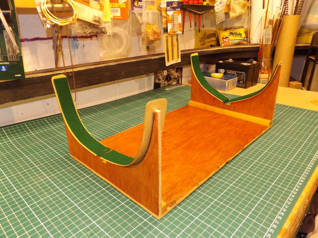

          I would say that a cradle is essential – not only to support it while building but mainly to support it at the poolside when you are performing final checks.
          It should be big enough to support the prop and rudder off the ground. Depending on the design, you might also use it for carrying the boat to the pond.
          There are many different designs – most of which require you to know the angle of the hull at a couple of positions. This is the sort of cradle I typically use:

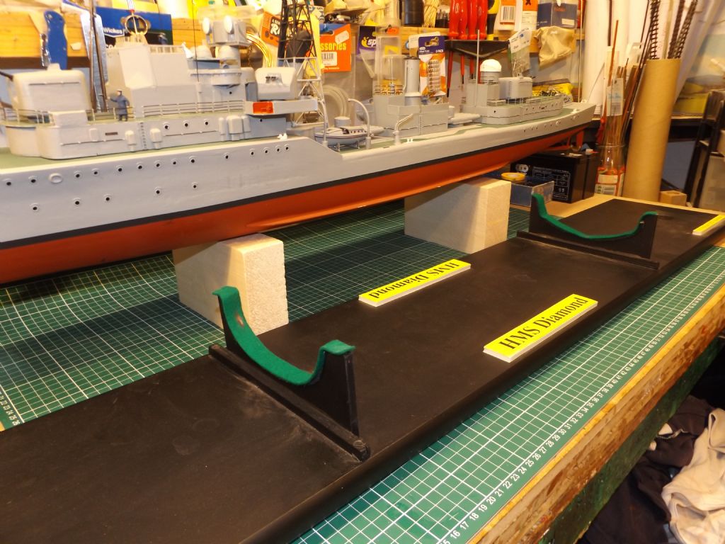

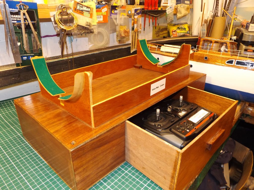

              stands 101017 002.jpgstands 101017 001.jpgHi David
              Here's a selection of stands for some of my round bilge boats & ships, I find it really beneficial to have the boat set at the right level for drawing on the waterline from a fixed datum. The Silvermist stand got carried away and ended up with a box & draw for the transmitter under the stand, Also the HMS Diamond and Silvermist base boards are slightly longer than the model and gives some protection to the bows and sterns when in the back of the car, where I find most damage occurs. If you don't have the drawn sections of the hull, I use cereal packet card to make a template. I'm using felt under the model, have tried rubber tape but it seems to end up sticking to the hull.stands 101017 003.jpg
