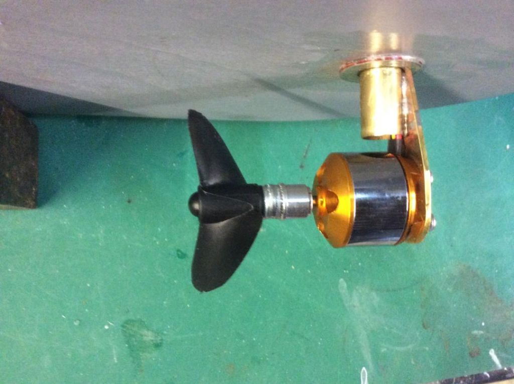

          Good question. I can guess but as far as I can see there hasn't been a picture of the underside. It also looks like the prop was spaced as far from the motor as possible to reduce shadow effects.
          #103429
            Mike. The props started largest/most pitchy first, as I was unsure as to how much power the motor would generate. As it happens, it was way too much. and prop sizes and pitches were reduced on an experimental incremental basis, arriving at an S35. There is no point in overpowering the bumper, it just makes it more difficult to control.
            Difference between X and S, like wot Chris says.
            The motor is mounted behind the pivot tube, and I will stick a picture up after typing this.
            Et voila!    in the snap, the front of the bumper is to the right and I think thats an X50 on there.

              Thanks Ashley, the drawing in the mag shows the prop on the left as above but the front of the bumper is also on the left so I felt a need to ask. Surprised no-one else asked, or maybe it's just me missing something obvious.
              I didn't want to get to the water and find Barbie was steering not me!
              Already ordered S35 and X35 to try both.

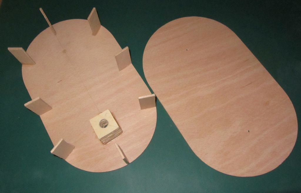

                      Started but not quite finished yet…..
                      Splash of paint and it'll be fine smiley
                      #105071
                        Good man! Any issues, and there are not likely to be, just ask.
                        Just as an aside, as the top is 4mm ply, to cut out the access hole you can safely drill holes in the corners or your shape and use a jigsaw. Any splintering is not an issue as the combing reinforces the hole and in any case it’s well hidden under the top.
                        i used my small bandsaw and just cut through one end and then twiddled round to get the opening. A sliver of very thin ply and glue fills the outer cut easily. Make the sliver of ply stand proud of the surface and simply sand flat, no filler required and in any case only a tiny bit of this will be seen past the top. (but don’t squeeze the cut bits together as this may distort the top).

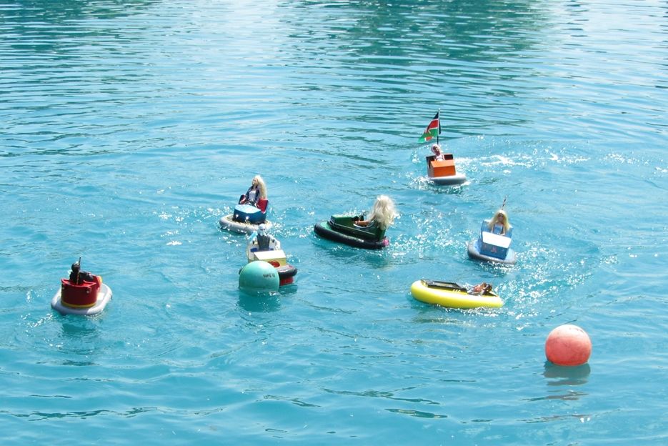

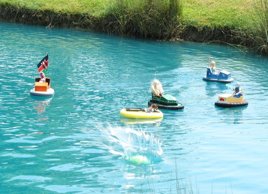

                                It was Open Day at our club Knightcote and there was 8 bumper boats including a Harry Smith design one? All having great fun pushing a bouy from one end of the lake to the other (not very far!) and into the goal or dock by the winner.
                                Some boats had nice paint jobs, and one had flashing lights and played fairground music, as there was a best boat competition. Piloted by Barbies and other figures.

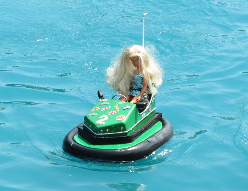

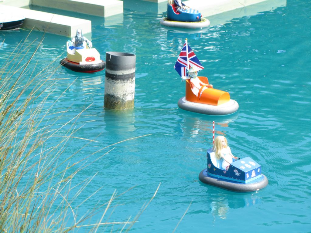

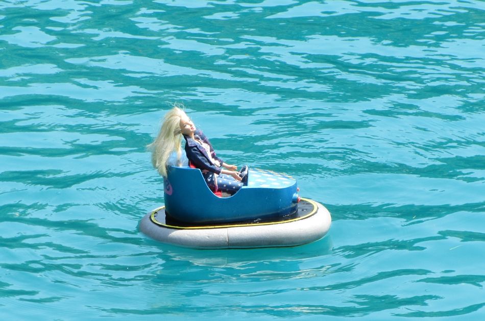

                                    The yellow one is the Harry based design. Not sure about "Barbie" in the No. 2 boat!
                                    Edited By Chris Fellows on 12/06/2023 19:30:06

                                        Wow…that looks like a psychopath Barbie in no2!
                                        Its very gratifying to see the mass production of (the only plan I have ever submitted) my bumper boat, I must say. The tops are all good and great to see that the ‘plan’ top has not been slavishly followed, but bods have done their own, which is to be expected.
                                        Although driven by a killer Barbie, the No2 top is very reminiscent of a more modern bumper top. Like the blue one with a chequered bonnet..harks back to the first dodgem cars.
                                        I always wonder how many craft have been built from the free plans, well, there’s 6 (?) Just there, and I know of 3 more, plus our 6.
                                        Well done chaps. Round of applause.

                                          Thought you'd be pleased Ashley. It was the chairman's challenge for the open day to build the boats and score a goal with the buoy. No doubt the boats will be used on our Thursday morning get togethers for more fun!
                                          There was a competition for best boat which is why they went above the quick and simple with first class paint jobs, flashing lights and sound boards! But good that it focussed minds and great models were produced. There were actually 7 of your design but one had problems during the first foray!
