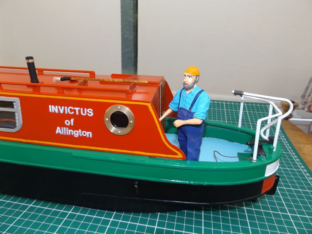

                  invictus of allington oct 15 005.jpgHi Mike
                  Thanks for the info I wondered when my narrow boat design was being published

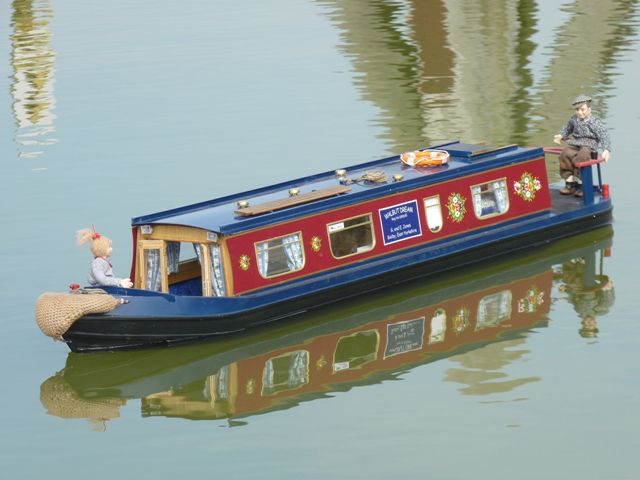

                      Deans Marine do a fibreglass narrowboat hull, about 1100 mm long which is effectively 1:12 scale. There are lots of dolls house accessories available at that scale if you decide to design your own layout. I built a model using this hull about 5 years ago and there was an article covering the model published in Model Boats magazine in August 2012. There is a link to some photographs of it here **LINK** and a picture of the model below.
                      The model was fitted with a bow thruster which was quite effective but since the model was quite manoeuvrable anyway it was not really needed. It had the disadvantage of making a very loud high pitched whine every time it was used which was quite out of character and drowned out the gentle put-put of the Action Electronics sound unit.

                        Ray – Invictus looks a very interesting project and a well built model. One of my current projects is a 1:16 scale narrowboat tug i.e. depicting a narrowboat which gained a second life being used for canal maintenance purposes. These were typically shortened by cutting into three sections and then re-joining the bow and stern. I used a set of original boatbuilders drawings which are available for purchase. Model is of all ply construction. I thought the construction of the bow would be a problem but it has turned out very well.

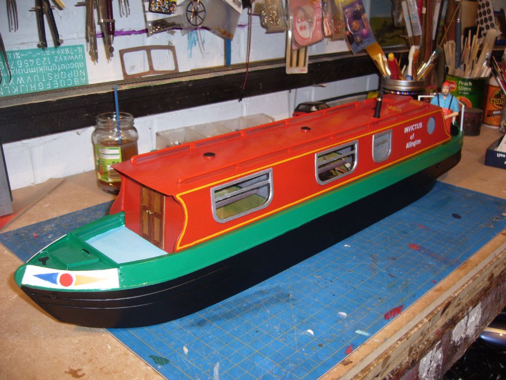

                            Hi Mike
                            Much more rewarding to scratch build the complete model I think, Invictus is cheap to build all ply construction to copy the correct bow & stern swim shapes is a challenge.

                              The bow and stern shapes are no more difficult than a modern steel boat would require, being made from flat steel sheet. On an old wooden boat the planks are an essential part of the lovely shape and have to be copied on a model.
                              Anyone who knows how to steer a narrowboat needs no bow thruster. I never hit anyone I didn't want to in our 1937 wooden full length historic boat.
                              The front well is way too high on that boat above!
