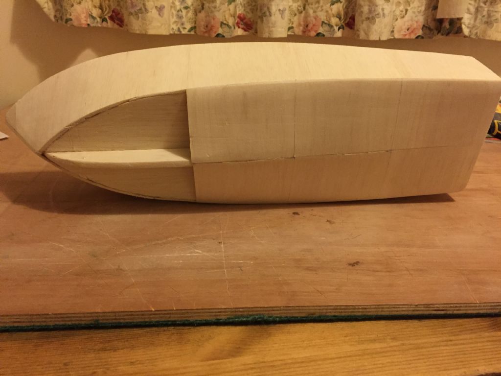

                                        Hi Matt
                                        How is the Twinkler build coming on?
                                        #64560
                                        Associated
                                          @associated
                                          Had a bit of a break other things came priority . But yes just finishing off painting etc , even daughter taken a interest with it but keeping an eye as she only 7 and has a habit to break things .
                                          #64562
                                            The build is looking very business like and judging from your photos you haven't encountered many problems.
                                            #64567
                                            Associated
                                              @associated
                                              Not too many issues just the filler didn't try at one point
                                              #64568
                                                We have all suffered from non setting filler at some point, its one of those times when you grit your teeth, kick the cat (not the dog as they bite back) and start again.
