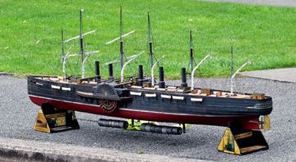

                This was my method of stabilising my 7`- 0" Great Eastern model
                I used a length of 10mm screwed rod, bolted under the keel with lead weights to suit
                The idea behind this was that the weights could be fitted and slid anywhere along the bar to adjust the sit on the water
                It worked very well too and can`t be seen, once in the water

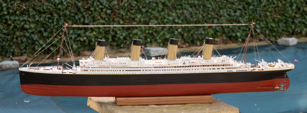

                    My Titanic (4 foot long) has no bilge keels and sails ok, the weight and depth of hull providing sufficient stability.
                    ​Bobs GE has a very shallow draught, thus the weights??

                      I can confirm that Ashley's Titanic sails beautifully.
