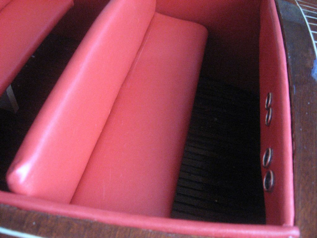

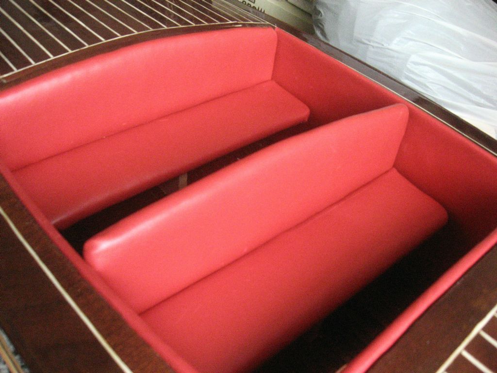

                    Those seats look good enough to sit in Paul lovely job. I should have a shed full of bits of boat frame to photograph by the end of this coming weekend fingers crossed
                    #20509
                      Thanks Phil
                      Believe it or not they are the product of 6 weeks work and countless cockups. At one point I threw them away and started to build a varnished wooden set but Jane would not let me give up.
                      The seats have a mdf core and wadding as padding below the red so they do perform just like a real bench seat.
                      #20510
                        Very nice, Paul
                        With the soft underlay…………….they`re crying out for a few red buttons???……….If you`re brave enough!
                        #20514
                          Hello Uncle Bob
                          The buttoned seats were version 14 they looked nice but the seat covering kept splitting so I binned the idea.
                          I bought 2sq m of material to make these seats and wasted most of it…I dont envy the people that make chairs for a living.

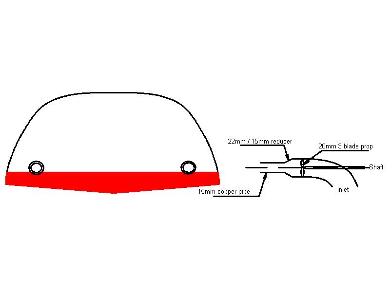

                                  In answer to your question I have got an engine for the barrel back, I am sticking with the Ripmax IC starter motor and using 2:1 gearing to up the revs.
                                  However I am also thinking about adding a couple of scratch built waterjets to increase the speed.
                                  I am sat looking at the stern of the boat which has two 1/2 inch exhausts just above the water line these could be used as jet pipes (no good for turning but faster on the straight)
                                  I will let you know how the thought process pans out.
                                  #20596
                                    Water jets ABOVE the waterline…………………..eh?
                                    Bob……………Confused
                                    #20597
                                      As the pipes exit the transom I would angle them slightly downwards.
                                      Dont forget that they are on the waterline when the boat is at rest but when the boat is moving forward the stern will settle and the pipes will be submerged.
                                      The engineering to produce the jet units is basic and if they are powered by a pair of 600s I should get a reasonable turn of speed the only problem will be turning the beast as the single rudder might not cope.
                                      But I am still thinking
                                      #20598
                                        You may find, the jets will be squirting into the stern cavity?………………..But a good squirt coming out back will look impressive anyway!
                                        #20599
                                          You could be right Bob but it won’t matter as the jets don’t have to be under water for them to work.
                                          This is a quich sketch of what I am thinking of…using some basic plumbing fittings, cheap plastic props and a short shafts.
                                          Sorry for the poor image (its slightly better if you expand it)…..the CAD doesn’t like saving to jpeg but you get the idea.
                                          Edited By The Fat Controller on 03/05/2009 08:10:01
                                          #20601
                                            This is a better image when viewed on the album section.
                                            #20602
                                              Not thrilled with your jet positions, Paul……………better underneath?…….or not at all, Paul!
                                              How about a Cort nozzle in place of a rudder?
                                              #20603
                                                I am thinking that  retrofitting waterjets in their normally accepted positions would be difficult as the hull has been almost finished? and so the tube exits, which would look impressive but possibly a bit out of character? A better bet might be to stick simply two more wing shafts as per normal on the boat or is that also too difficult? ashley
                                                Or, the really fast boys use those flexible shafts, and using them might give you more choice on where to fit the motors?
                                                Or a forwards facing prop at the front !!!!!!
                                                #20604
                                                  Bob & Ashley
                                                  I am trying to work around the 1940s design of a single prop and rudder, I could fit a pair of wing engines with props but it would look to much like a MTB setup.
                                                  For the same reason I dont like the idea of forward facing props and fancy rudders as they are not in keeping with the design.
                                                  There is plenty of space to retro fit the jet system and whilst out of character it would not spoil the outward look of the model as even when under full speed it would be very hard to spot as the jet wash would be lost in the wake.
                                                  But I am still thinking.

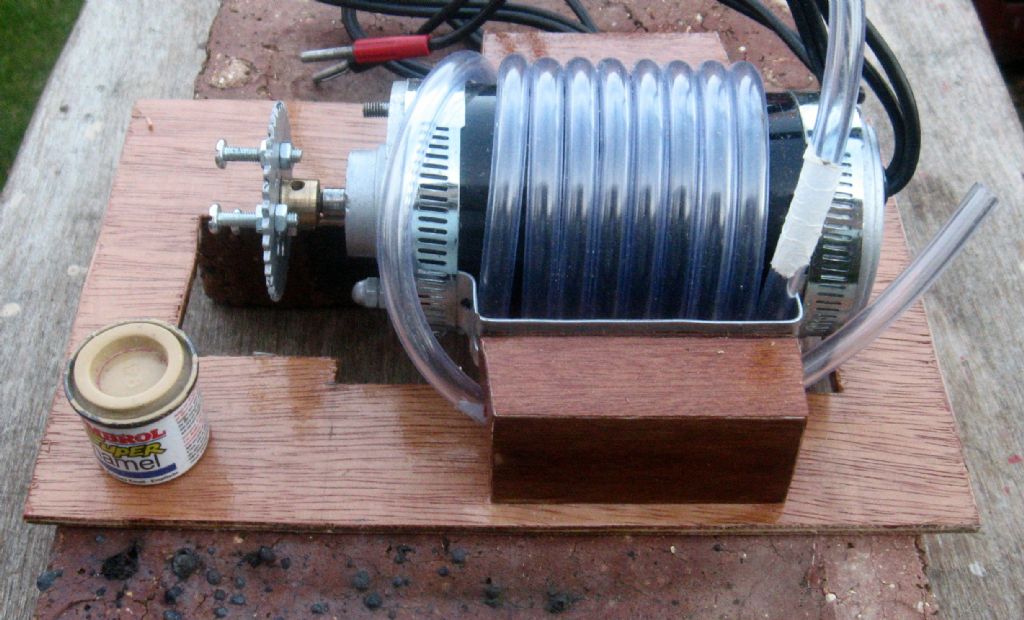

                                                  #20838
                                                    Here is a photo of the 12v motor and primary gear…..the paint tin gives you an idea of size.
                                                    Still not 100% happy with fitting electric but needs must etc….
