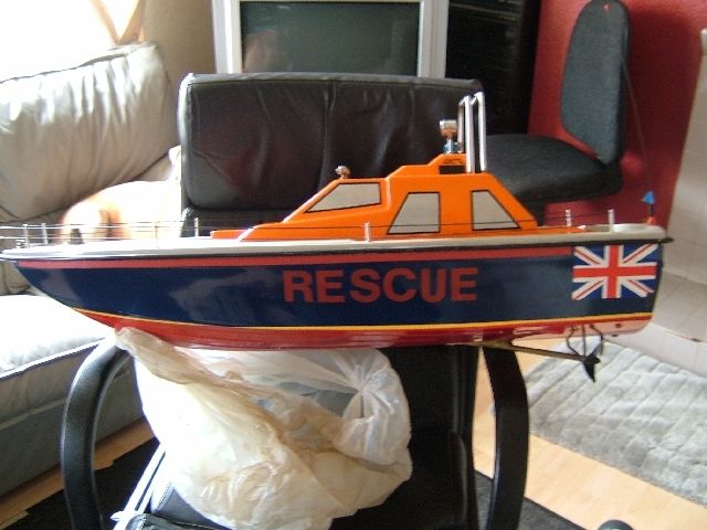

The shaft is definitely not binding, and the motor and shaft are in perfect alingment.
when i check it no load at all its 1/2 amp, and the same with shaft connected.
I can that running in the bath would cause a power loss etc as the boat is not moving through free water and being more under load.
I have since tried it with a 50mm prop that is 70mm pitch and it stays coller than before.
With this prop it runs flat out at 3 to 3.5 amps.
The motor is a lot cooler with the smaller prop, but i think it will be far too slow with this prop.
I will try and test it down the canal today and see what results i get from that.
something tells me im going to be getting a different motor for the boat.
I do have a mfa barracuda, but the problem is weight of those, as they are a big lump,and this boat is not realy big enough or designed for this sort of weight.
If it turns out to be 6 volt, then it wont be any good at all for me as on 6 volts it definitely would be far too slow.
