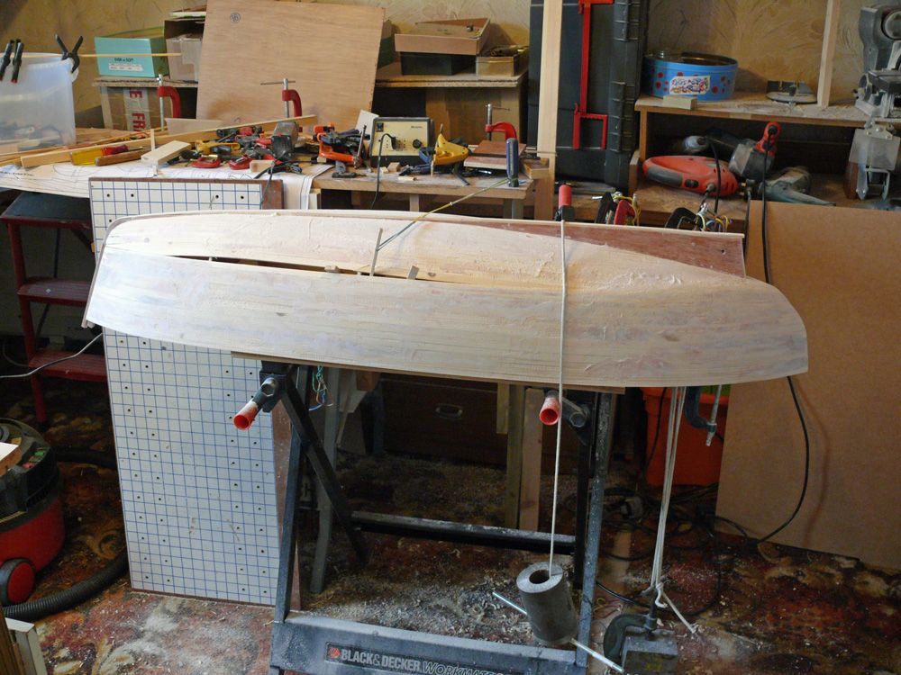

      Stern post mod done
      Planking is continuing at a leisurely pace,,,,,,Nothing to worry about at the moment

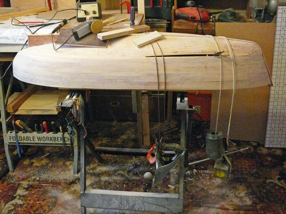

              Latest state of play
              Still planking………..Thinking about tidying the run of the planks now
              We don`t want an higglie pigglie appearance creeping in………BTW …..Banjo that is Northern slang for a Pig`s Ear!
              The last plank shown is loosely fitted and suitabelly wetted
              The other picture shows the tail end area reaching fruition

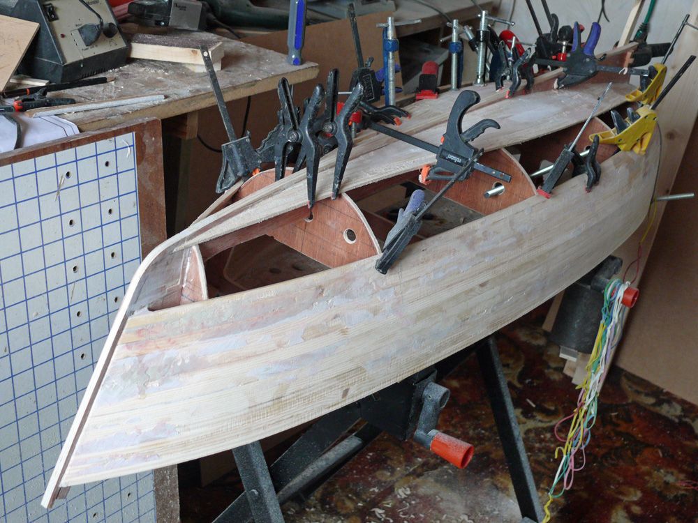

                The last plank for the time being at least
                Had to use the weights, to retain the last plank………Crude, but effective

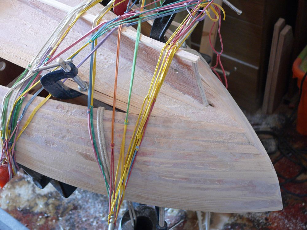

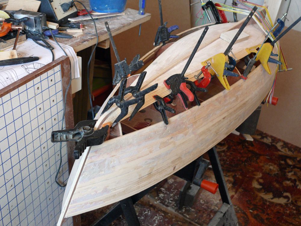

                                  Special work in progress picture for a dear friend of ours, just out of hospital and also brother Geoff……Same
                                  The picture shows the final plank is about to be installed…………WHOOPEEEEE!!!!!!!
                                  Note the method of clamping the final planks…….Chunks of metal, draped over the hull, to captivate the plank, as there is no further room for clamps……An idea borrowed from Heath Robinson and Fred Flintstone!
                                  Then we have the mammoth task of finish shaping and filling
                                  I`ve decided to proceed with the main build now and let the hull finishing come later

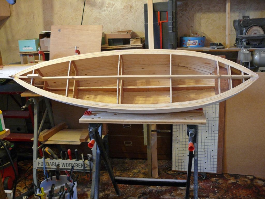

                                      #65527
                                        Finally we can see what she looks like on the inside!
                                        Not bad?
                                        #65529
                                        Banjoman
                                          @banjoman
                                          Not bad at all, Bob! She's a very good-looking lass, indeed!
                                          /Mattias
                                          #65530
                                            Thank you, Banjo
                                            Now I can study the plan more closely and decide on the next move
