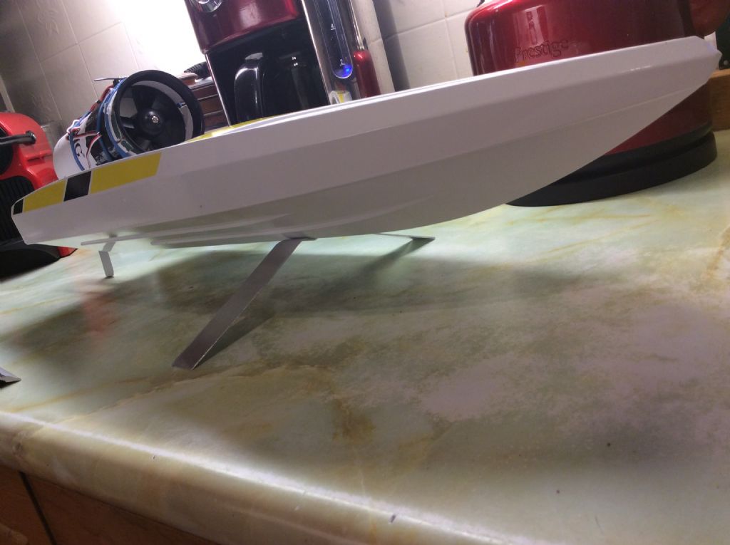

                                                Noel
                                                  @noel26080
                                                  It was a nice morning at Bushey yes.
                                                  The children did not crash their speedboats into anything that was not either each other, or my craft – and they sorted out a stranding with a big stick.
                                                  The only negative was the weird steering on the destroyer, and that was explained when the rudder blade dropped off as soon as I touched it back at home. solder failure!
                                                  Now, as the EDF boat went so well again, I thought about this:
                                                  Terrible idea, wrong shape? too big? or worth a try?
                                                  The foil shown would be supported with some sort out outrigger at each end, and also there'd be a foil on the bottom of the rudder too. I spent a lot of time filing the edges during "The Voice (UK)" on Saturday night……
                                                  #75001

                                                      Noel. Wont know until you get it in the water. An aluminium foil is unlikely to stick that well to the thin rudder. Make a new temporary rudder from ply, well varnished. If the dangly bits are foil shaped then they could be bent up at the end to form a "V". You don't want them to be too deep or the thing might take off. I wouldn't have thought any more support would be needed (depending on the gauge of ally used).
                                                      Cheers DM….look forward to seeing it!!
