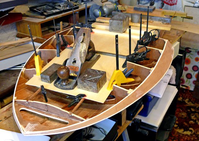

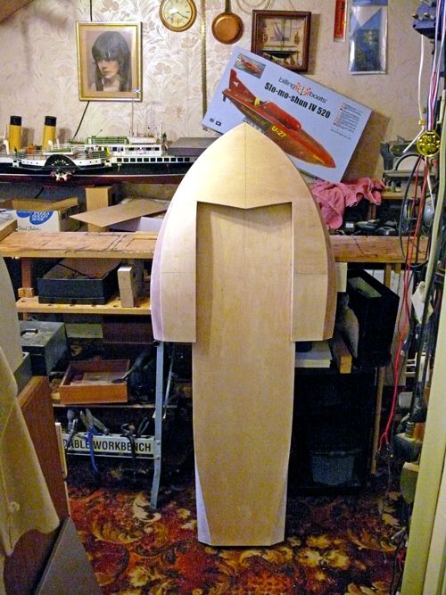

                            Finally got back on the hull construction, using 1/16″ ply for flexibility and lightness
                            #23426
                              Morning Bob
                              Plenty of room where the plane is to fit a nice smelly petrol engine and then you could put those exhausts to proper use.

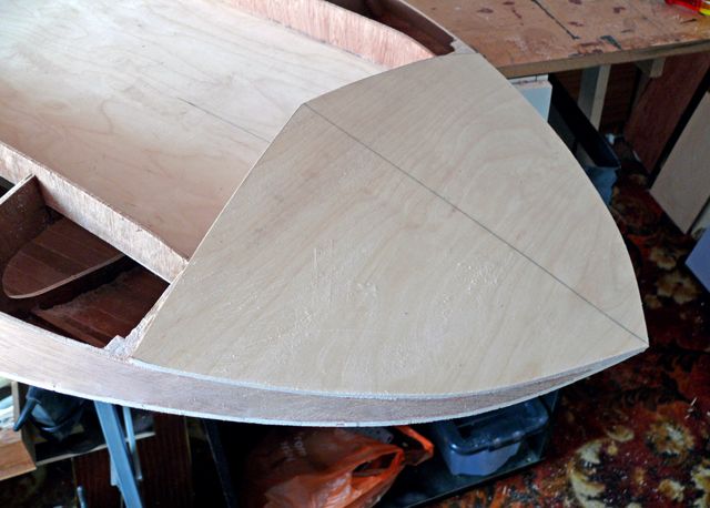

                                        Hull nearly complete…….Now for the filling and sanding!

                                          Awesome Bob simply awesome. and so big to you can really appreciate its size stood like that
                                          #23500
                                            How heavy is it Bob?
                                            #23501
                                              Morning Paul
                                              The weight of what you see on the last picture is a remarkable…7lb!
                                              Plus batteries and gear….veneer and superstructure….20lb max?
                                              Over to you Mr Starter!…………….Bob
