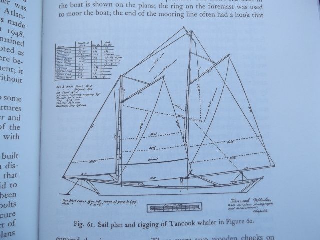

            Hello again. Here are some photos of a Tancook Whaler. My memory tripped me up, Tancook Island is off the coast of Nova Scotia, S.W. of Halifax, not off the coast of Maine as stated in my last post. Information from Howard Chapple's American Small Sailing Craft.
            This example is about 40'x 10'. I will build her on a 1" to 1' scale. She'll need a fair few modifications to translate into a model, but I'll worry about that later.

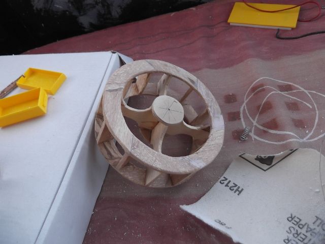

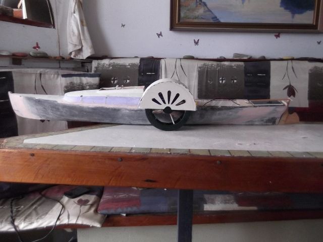

            The paddle wheels are made, ready for final sanding and painting. They were a pain to make, mainly due to the wood I used. It was a drift wood log that I put to the saw. Other than being a semi tropical hard wood I cant tell you what it is. I used it because it is very light, but it is also rather brittle, and I broke the wheels on more than one occasion whilst building them.

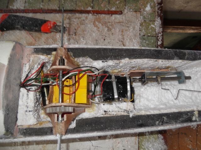

            The mechanicals and radio installed

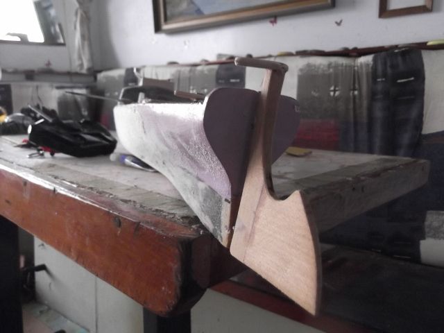

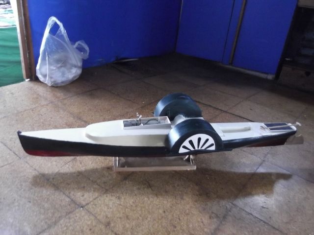

            At this point I ran into a snag. I decided to put her in the briney, just to see. She floated to her lines ok, but stability was indeed inadaquate.I mulled it over for a while, and decided rather than adding a ballest keel I would remodel her hull some what. My logic(?) for doing this was, due to fact that she would spend most of her time on a large estuary, which (from the models point of veiw), almost always has a short steep chop, a ballest keel would cause her to develop a pendulum roll. I cant imagine a side wheeler much liking that! So polystyrene was glued to the hull and re shaped. She now has another 1/4" over all beam, 3/4" more waterline beam, flatter floors and a harder bilge and a few more onces of displacement. Should result in a much stiffer hull, with very little drag penality. A lead deadwood will take care of the extra displacement.

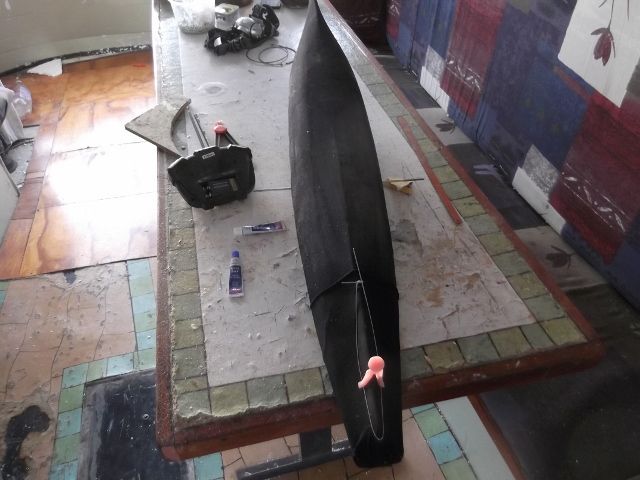

            This is the modified hull, with a bit of stocking stretched over, ready for a coat of epoxy.
            Rudder sorted.

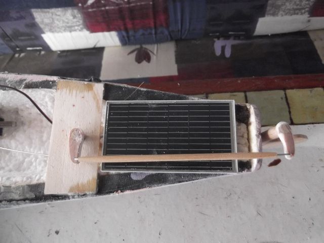

                  Well, scant progress,I'm afraid. Not much free time this week. Still, got a coat of epoxy on the remodeled hull, faired up and sanded down. One paddle box built. I have decided to stick with the aft of amidships location for the paddles. If it doesnt work out ,Bob, I'll eat humble pie and take to the cabin with the hack saw!
                  The solar panel in place and the rudder linkage conected.

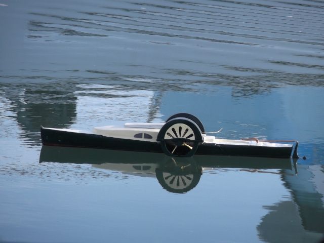

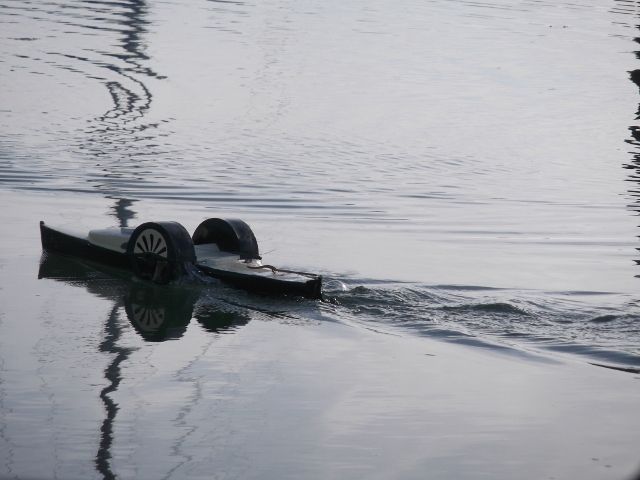

                                Well, she's finnished.
                                ..and she's been tried, and she works. A beautifull sunny morn, flat calm, so in she went. Fairly slow,a scale speed of about four knots, judging from the wake. But she trundled along happily, responding to the helm just fine. Should do a little better mid day, with the sun higher and stronger. I shall get some photos next time, and see how she goes.

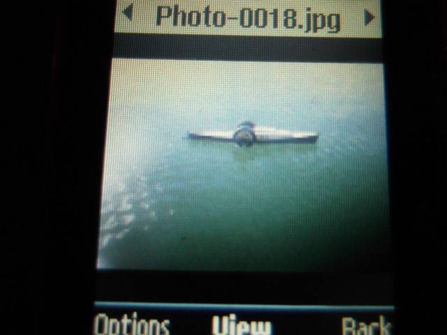

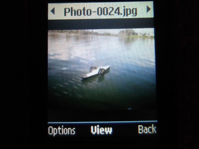

                                          Here are some photos. I'm sorry about the poor quality, I found my self with out my camera, so resorted to my phone. I then had to photograph my phone to get them on the computer….crook any way, you get the idea…

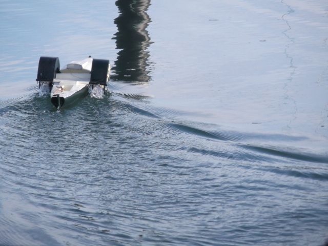

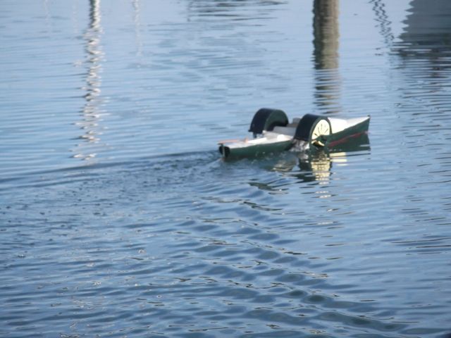

                                              Well the model has undergone a wee bit of a transformation. As it turned out, getting the right combination of calm, slack water and sun proved too difficult, so I repowered her with a toy car motor and gear box and batteries. I geared the car gear box down a further 3:1, but even so she took off like a scalded cat, so I ended up dropping a cell out of the battery pack. (now five cell ni cad). photos soon.
                                              #43185
                                              Amy jane September
                                                @amyjaneseptember49770
                                                One of the side effects of the increased power was the appearance of side wheelers delightful habit of one wheel grabbing and rolling the boat down hard on one side . I got around this by pulsing the motor on and off (the car radio dosn't have a progresive throttle, just on and off), untill the boat got up to speed, then she is fine.
