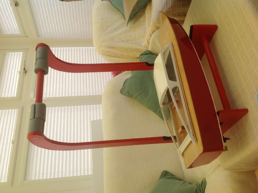

                      image.jpgMy Launching Cradle similar to Ian's but again without hand warmers !
                      #45621
                      Ian Gardner
                        @iangardner62867
                        Thanks John- yours looks as though it does have hand warmers! I'm going to put a bell on mine.
                        Ian
                        #45622
                          John appears to have gone one better with the cradle by colour co-ordinating it!!
