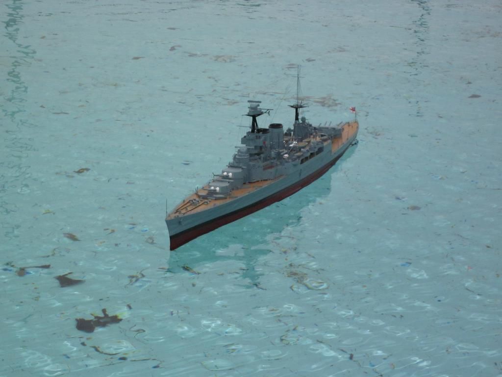

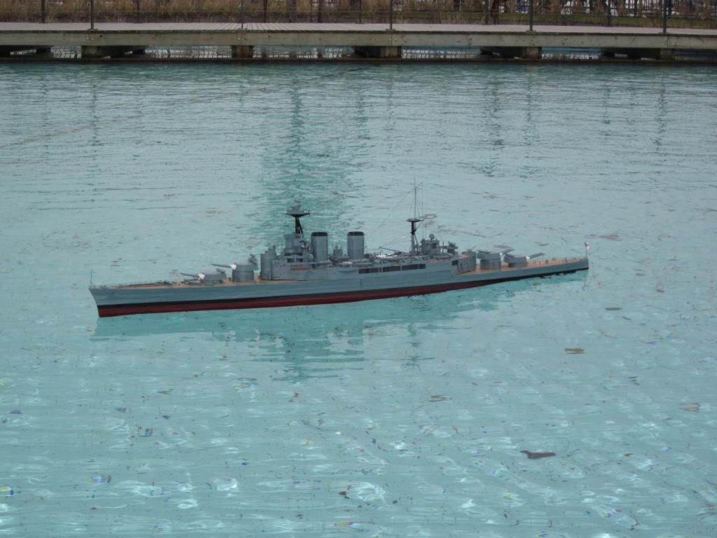

            Well the HMS Hood had her maiden voyage on Sunday 2nd March with great presence in the pond.
            All was running well until after 5 mins a brand new 5100Mah Mnh battery diedangryso 4500Mah 11.1v 3s Li-Po's on order.
            There still appeared to be slight binding in the shafts but I am putting this down to the model having been sitting on display for years, despite my having soaked the shafts with WD40 and lubricating them with 3-in-1 oil. Before the next outing, I shall clean the shafts with pipe cleaners and lubricate with flake graphite.
            She was slightly out of balance with a little to much ballast in the rear but this is something that cannot be checked in the bath at homeface 9
            So come on all you owners of these great looking but flawed Graupner models, put your modelling skills to the test and get your models running and in the water, it really is not to difficult.

              She's looking good Eric, a little low astern but ballast just forward of midships may bring it about right. I have been to Oxford today (second time) to retrieve the hull, they have removed and refitted the 'A' frames, also bored them out a little oversize, if nothing else the shafts now run free. there is minor damage…not spotted in the shop… that I will have to repair. Just the radio etc. to fit and she should be ready to run.
              Thanks to all who took the trouble to put forward ideas.
