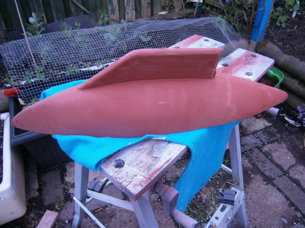

            jenny narrow race 007.jpgRich
            More info ,.. if its to fair in skeg , use p38 if coating F/G use tile and grout …..
            what is the build are you starting..?……..cheers Larry………….
