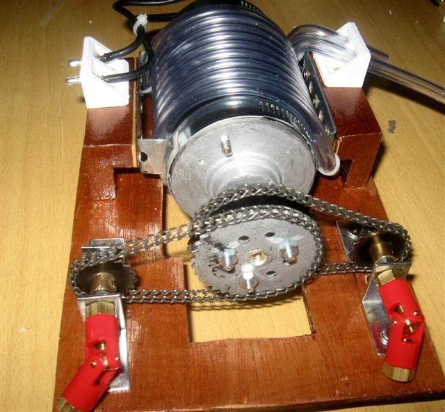

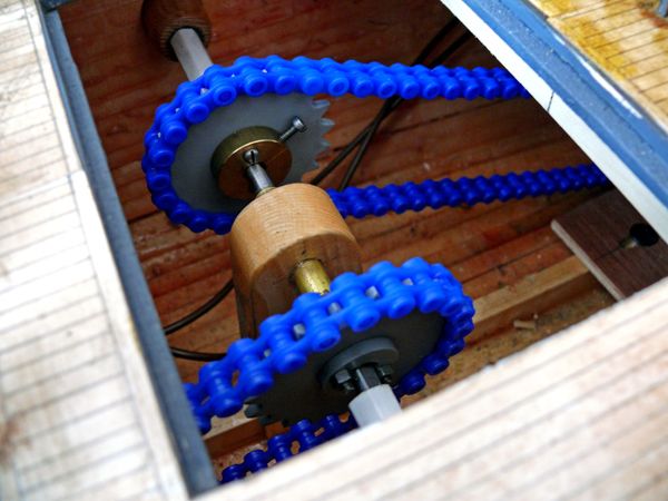

      Hello Paul
      Thanks for the special photo……..quite a chunky motor!
      I`ve been using HOBBY`S chain………see photo…………….and you could fit double sprockets and chain if necessary………….would look the bizz then!
      I would still think about omitting the stub shaft………………put the sprockets on the prop shafts…………..and split the chain?
      Just another free of charge super suggestion……………….Bob

        Thanks Bob
        I will have a look at the Hobby’s site.

        Phil Winks 1
          @philwinks1
          That really is a chunky piece of motor Paul! glad to see your at least well enough to do a bit of fiddling mate. One point I have with this style of drive from a single motor to twin props is “no counter rotating props”. does this not cause a largish element of (for want of a better expression) tourque steer requiring large amounts of Rudder trim and so reducing your left turning ability or do you put trim tabs (I guess like fixed rudders) on to allow the rudder to be central when going straight? We do have a similar prob with twin engined aircraft but that has more to do with gyroscopic precession not something that would effect the relitively small props of a boat I guess. On a plus note the finish on my barrelbacks latest coat of varnish has me thinking that I’m very close to the top of that particular hill

            Phil
            I have built twin engined models and have fitted both contra and same rotation props and the only model that showed any kind of “crabbing” when fitted with same rotation props was my Trent.
            The Trent is by no means a heavyweight and is fitted with two geared 650s so it is capable of quite a turn of speed, It only “crabbed” at speed when the hull was high in the water so I fitted contra rotating props which solved the problem.
            This is my first single engine / twin prop build so I am not sure how it will respond on the water but I don’t think that it will go fast enough to cause me any problems….the engine might look meaty but it has to shove a lot of boat along.
            Still it will be fun finding out when I finally get to sail it at Runcorn and as long as it dosen’t go round in decreasing ovals I shall be happy.

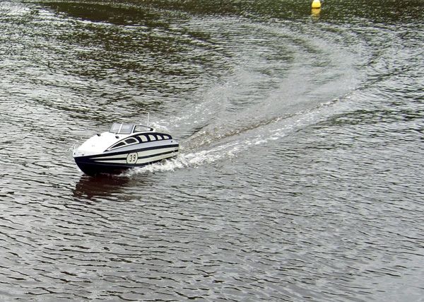

                                            Paul and Phil
                                            Seen at the regatta today, in between rain showers…………..Heavy speedboat, plywood construction, powered by a Graupner 900 series motor, running at 7000 rpm, powered by 30 volts, and water cooling
                                            Just thought this may be useful info for your Barrel Backs
                                            Not a bad day today….good turn out…..and the Blind Dogs came indoors

                                              Looks like a Sea Commander thats had a face lift

                                              Phil Winks 1
                                                @philwinks1
                                                Thanks for that bob looks pretty convincing

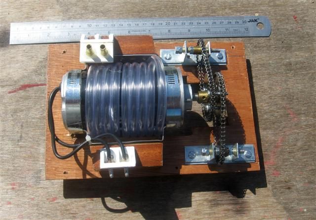

                                                  An update on the motor situation.
                                                  After a prolonged workbench test run yesterday I have made changes to the motor setup.
                                                  I have ditched the gears and twin drive and now decided on a single direct drive with the motor running at 24v.
                                                  The motor is very powerful but slow when running at 12v so an increase in voltage will give me the extra “oomph” without having to worry about the drive chain failing.
                                                  However the can gets quite warm so I will fit a pump to the cooling system to maintain a constant water flow.
                                                  I am planning to make the shaft today, health and grandson permitting.
                                                  nb: I will certainly be fitting this type of motor in the TID (when I get around to it) as it has amazing grunt and has no loss of power or revs even when under huge load.

                                                  #21341
                                                    Paul. Simplest is best, I don’t think you will have cause to regret not fitting all those gears and things, provided you get the motor/prop combination right. Ashley
                                                    #21343
                                                      If you`ve got plenty of grunt at lowish revs……………….then a coarse prop would make up for it.
                                                      The boat I posted yesterday, had water jackets soldered to the motor casing and also a syphon type pipe which automatically emptied any surplus water from inside the hull
