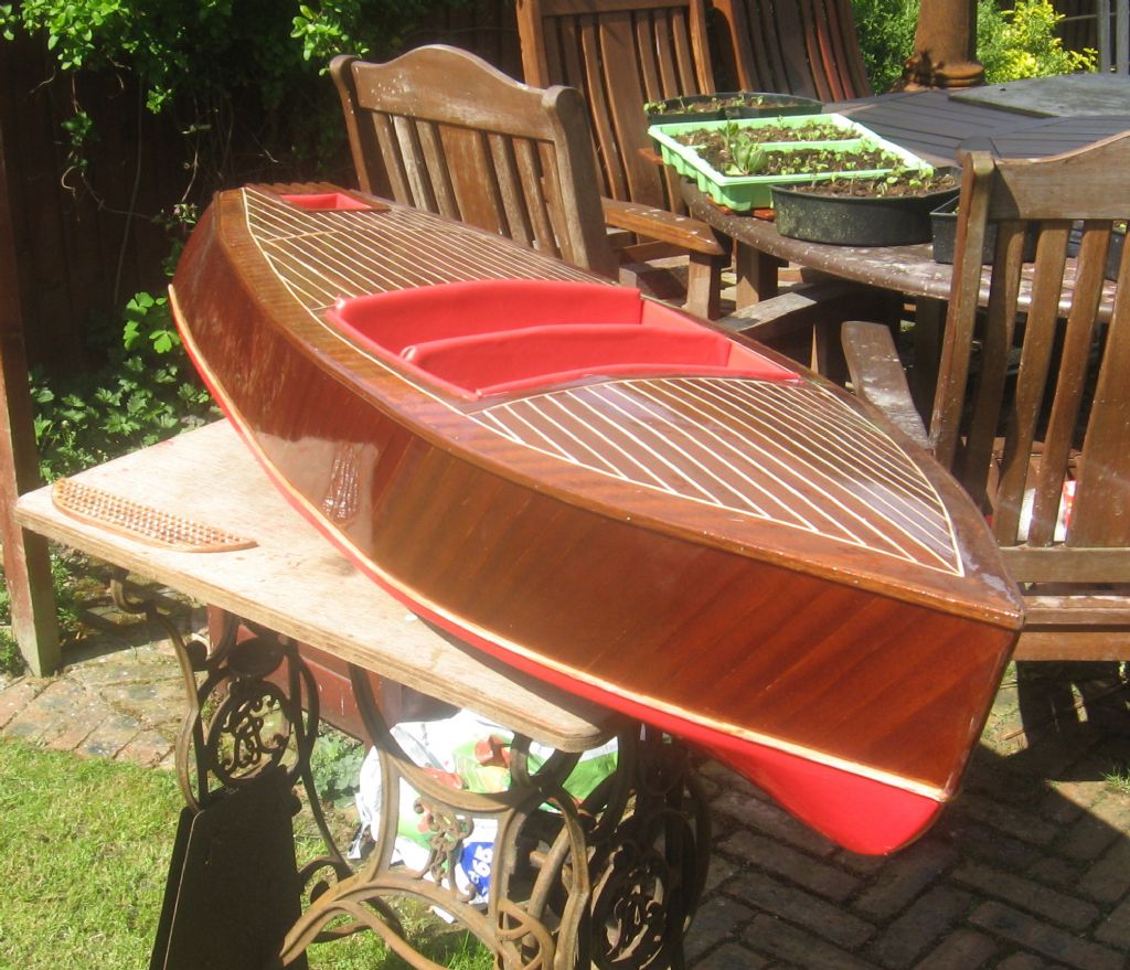

      The wood is mahogany and has been cut from a single plank to ensure colour consistency.
      I used my bench saw fitted with a veneer blade to slice along the grain to cut identical 3mm thick planks.
      I chose the diagonal planking method to show the mahogany to its best effect as I like the feather appearance.
      Yes you can buy ready cut veneer but this has the problem of colour consistency and has ready fitted heat activated glue which is not waterproof and is difficult to remove from the veneer.
      The varnish is the standard yacht type (B&Q) which I shall use to build up the 40 coats but the final 2 coats will be International yacht varnish.

                                #20360
                                  Latest photos
                                  Seats 1st fix and ski seat 1st fix
                                  The varnish is not quite there yet.

                                        The seats have an mdf frame and are covered with leatherette these are my 4th attempt as I am no good at upholstery.
                                        I have a chunky ripmax 12v motor and 2:1 chain driven gears but I’ve not started the installation yet.
