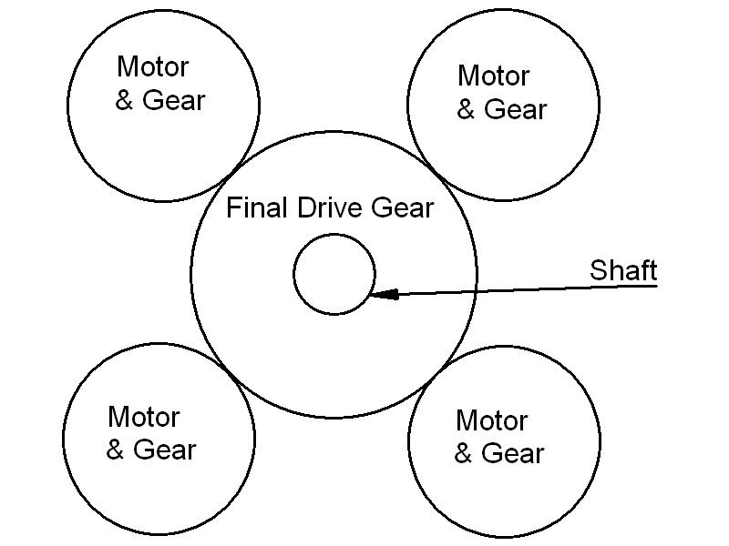

                                      You have set me thinking about a multi engine setup, but I don’t think that having them all “in line” would work without a series of clutches.
                                      I also think that Colin is right about idling motors acting as brakes and generating power that might just upset the esc.
                                      But I have come up with a solution that might work.
                                      If I position the motors at equidistant points around the shaft i.e. north, south, east, west and then connect them via gears to the shaft then it might just work.
                                      What do you think?
                                      This is a basic end on sketch of what I’m thinking about

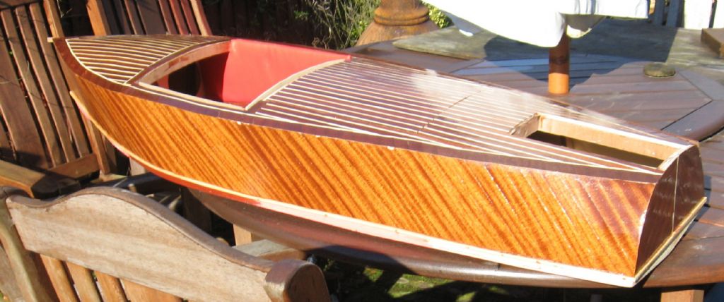

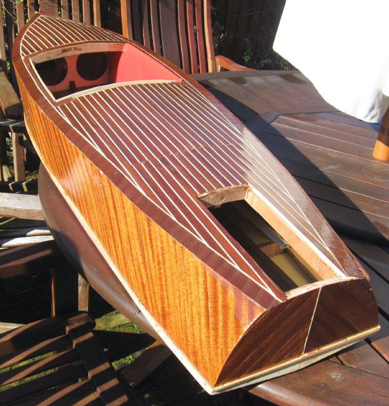

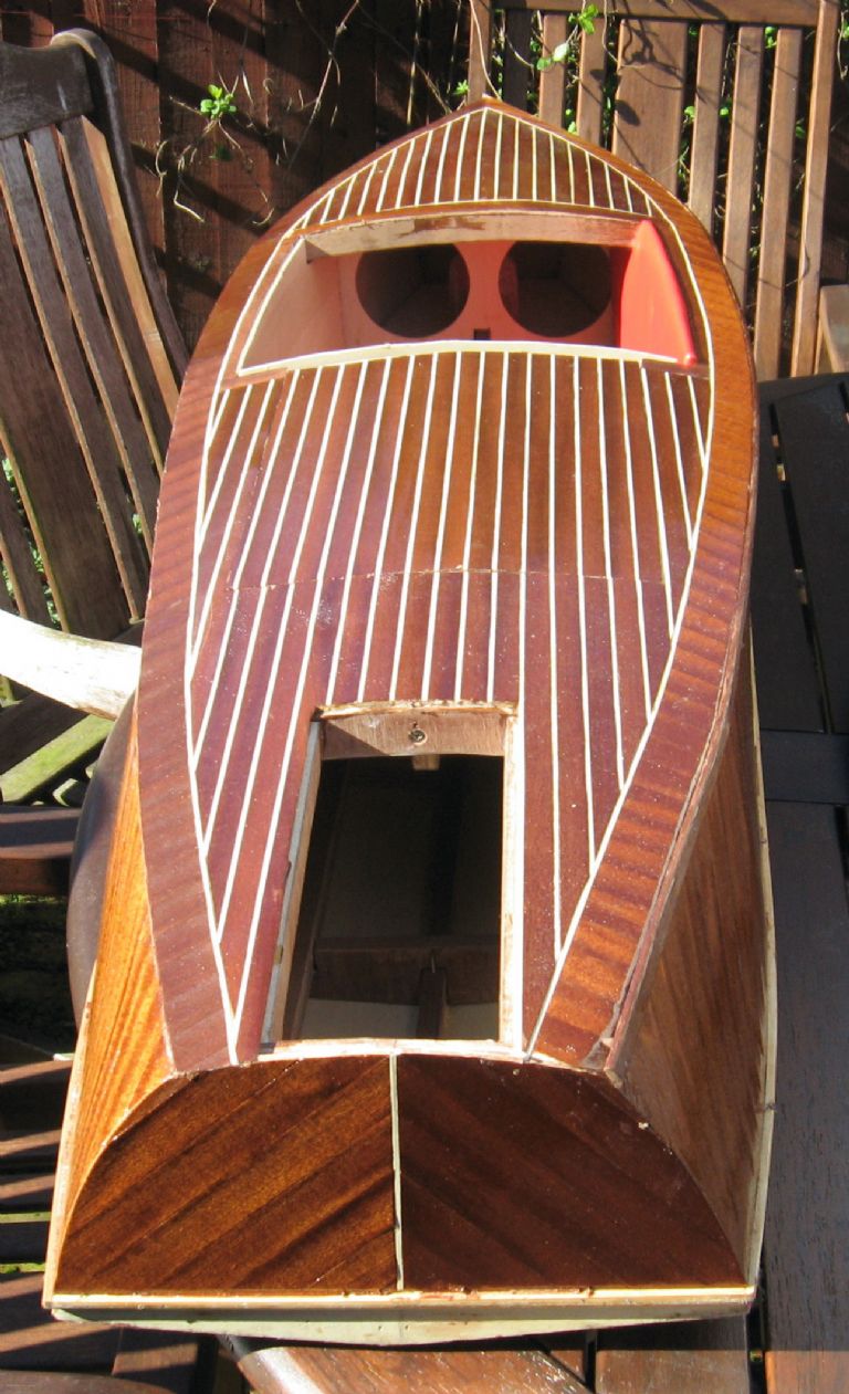

                                              Some more progress photos
                                              I’ve still not finished the rear hatch cover
                                              Stern view: still lots of work to do on the woodwork
                                              This view shows the diagonal planking and the start of the leather interior.
                                              Long shot of the planking

                                                That is looking really nice Paul.
                                                Are you allowed to go near it yet?
                                                #19251
                                                  Looking good Paul
                                                  How will you make the shiny metal fittings?
                                                  You could cast your own?……………..There used to be a firm that produced lead type soldiers from latex rubber moulds at a very low temperature. It was called…Prince August” or something like that………………..worth a look?
