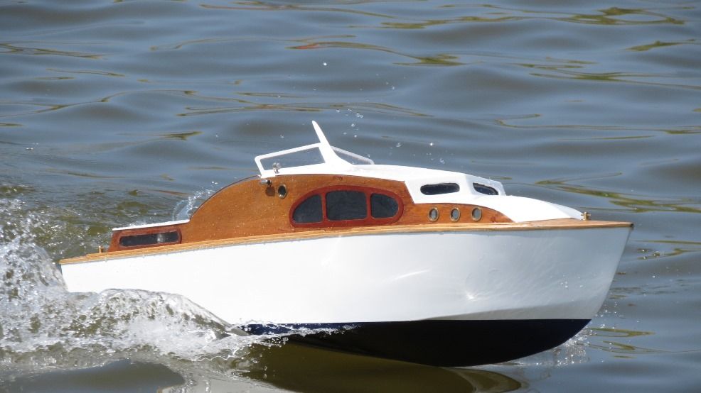

    David Wooley
      @davidwooley82563
      I Attended the Vintage model boat event at Fleetwood , a superb day with real chance to see again after many years modellers and boats from period of our hobby that i thought I would never see again. WellIi was wrong , I have never seen so many vintage kits and designs put through their paces Fleetwood was a major power boat venue in the 50 s and 60s and being there brought back a few memories . One of many Sea Queens present at Fleetwood , One Swordsman enlarged from an MAP design has its original petrol engine and was going strong after 60 years !.
      img_0855.jpgDave Wooley

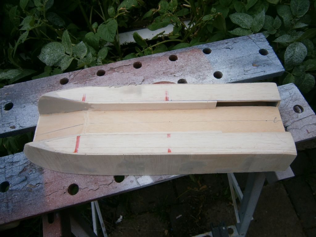

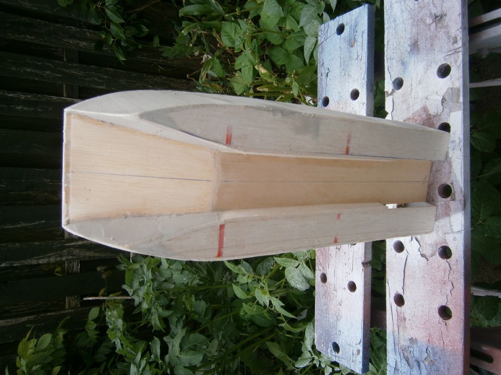

                    Thanks to Dave , i have started a TOM TOM a classic build of Vic Smeed,
                    twin hulls a bit of challenge , bow noses tricky but so far so good, pictures so far
                    balsa build , 540 power 7.5 volt power,
                    cheers Larry…

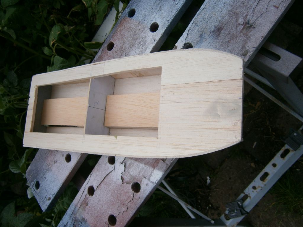

                          tom tom skin 002.jpgHello ,
                          Latest on Tom Tom, hull complete , balsa build with a .72 skin of styrene stuck on with double side sticky tapr with solvent glue at the joins , nice strong hull with a finish to take paint job,
                          cabin structure next , mixture of Ikea blind and balsa, with dummy windows , pictures to follow ,

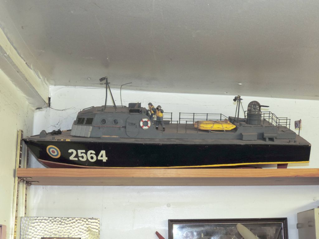

                                        Thanks for a fascinating list, but I have built a Vic Smeed model which does not seem to be there.
                                        Back in the late seventies I started work on a semi-scale air-sea rescue launch from a pull out plan in a Model Boats special. Vic's wonderful design was loosely based on a British Power Boat Whaleback – 'the Spitfire of the sea'. Powered by a brand new monoperm performance was, shall we say, limp?
                                        I did little things to in, ended up losing the superstructure. I built a new freelance one and added a 540 motor and lots of fat nicad cells. In 1998 it finally achieved its full potential. I was little cruel, literally running rings around a chap's brand new electric R/C speedboat which he had flat out. The little ASRL had a rooster tail about three feet high behind it!
                                        I would early love to track down the plan and put Vic's superstructure back on the model.
                                        I have a scratchbuilt 1/16 close scale model of a whaleback that is nearly complete, which will be powered by three Buhler motors. All down to Vic, it looks like it may take about 20 years to complete too…
                                        Neil

                                            That's the one! Actually, after a frantic hour's search through all sorts of stuff (mostly old Aeromodellers and reports from my old jobs!) I found it – it was a 'special' about radio control.
                                            Looking at the plan, it seems I extended the superstructure to include the 'optional hatch' at the back, so the original design will require some butchery. I think I might just spruce it up.
                                            I really must finish the Whaleback, too.
                                            Neil
                                            Vic Smeed design with different superstructure:
                                            Whaleback:
