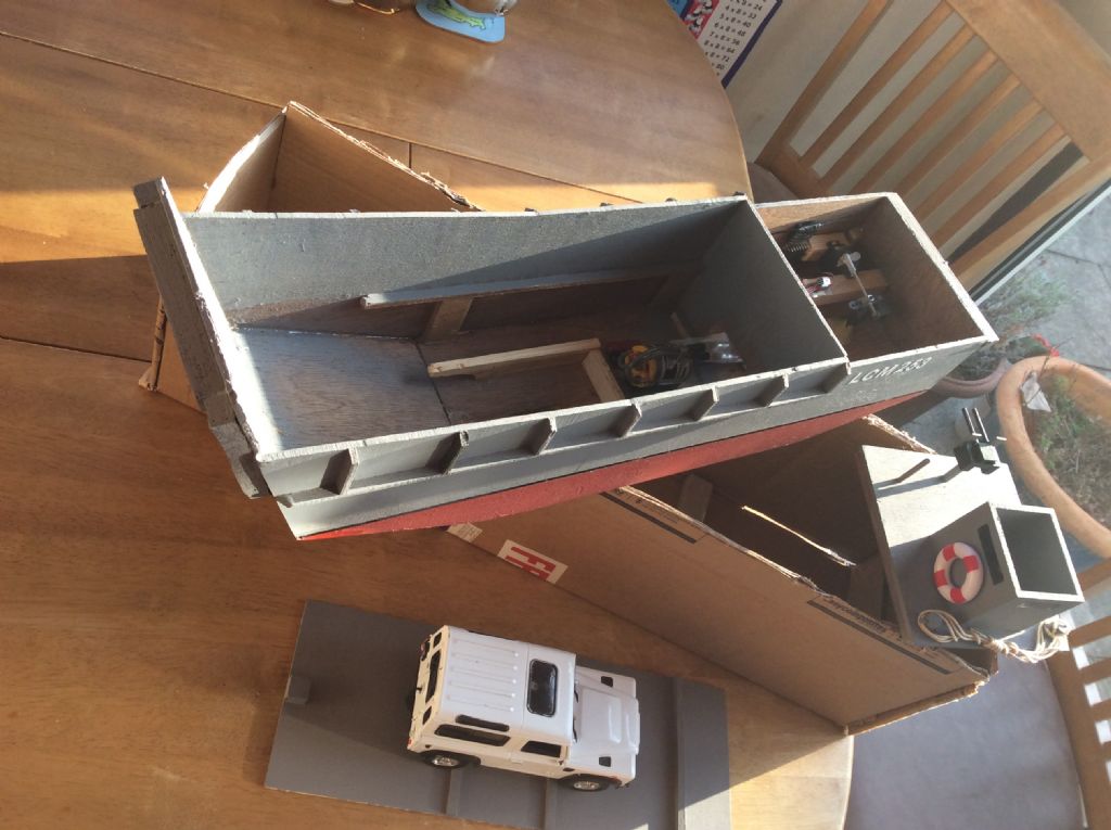

                  Not sure am going to be down pond for another week or two, but have been able to finish off the donated landing craft. It now has a battery holder, a little corrective lead in the stern as it was still a bit bow heavy, and some foam rubber bumper strips fore and aft. These strips don't look bad when painted grey and should provide good protection for other objects the lander comes into contact with – be they static, or indeed, other water craft.
                  The 1/24 Defender looks great in it, but being die-cast it does raise the centre of gravity rather alarmingly.

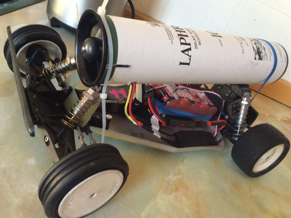

                  The cheapo brushless EDF turned up in the post too, so this has been mounted to a temporary jet pipe and fitted to my Schumacher Cougar r/c car in order to generally test it out before it goes on the speedboat hull.
                  It looks quite exciting standing still, and accelerates rapidly down the kitchen on a 3S or 12v battery!

                          The exhaust path from an EDF should be very free, and although the car looks racy like you have mounted it, it would go a bit better if the motor was simply mounted on a ring at the rear…ie no jet pipe.
                          I would not like to give any sort of percentage drop associated with a long or rough/narrowing jet pipe but when on a boat it may well be the difference between flying and pootling.

                            The jet pipe length was based on ease of mounting across the cars shock towers, so in use it can be cut down a lot I was thinking of about 4" or just enough to pipe it out the back of the boat and make it look jet-like.

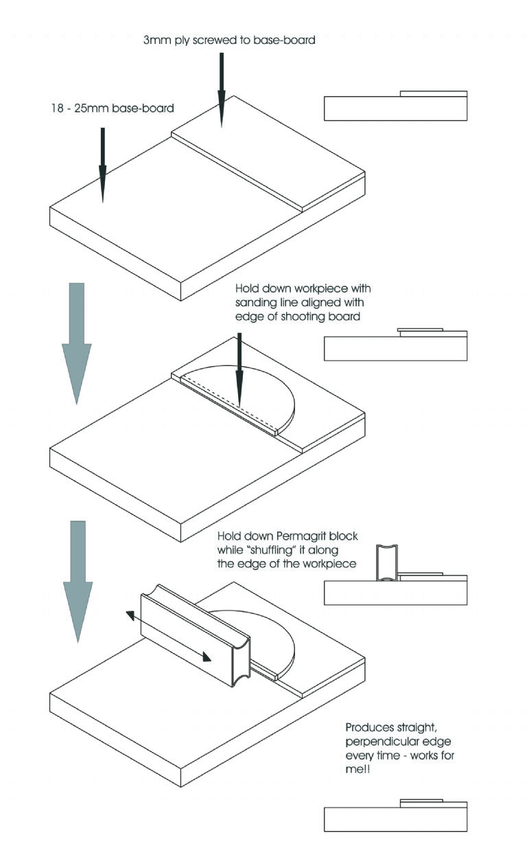

                              Ah! So the word is finally out on Permagrit! I buy a new one for a Christmas present to myself just about every year. This is one of its most frequent uses:

                                That's the best reason I've ever seen for drinking the scotch !! I think I may have a go at a twin tube version
                                Liking the sanding board idea Dave, I have no finger tips left !

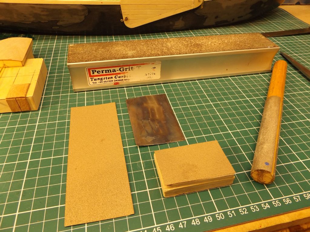

                                          Hi All
                                          My contribution to the Permagrit appreciation society is a photo of my 20 year old, long block which has a rough and smooth sides and is the most often used tool I have, which is cleaned with a wire brush. They also do the sheet with the tungsten carbide welded to it which you can cut with scissors to make custom sanding blocks, also for small brass work I use it instead of a file. So well worth the money

                                                  I picked up one of the large sanding blocks as per Ray's photos yesterday at the show and baulked at the cost of the files also! Wished I'd known about the sanding blocks years ago as I've spent a fortune on sand paper for jobs around the house and garden over the years which would have paid for Permagrit tools over and over again.
                                                  I baulked partly because I'd already spent quite a bit on materials and other bits and pieces and still had some things to get.
                                                  Not really essential for me at the moment and I have been guilty on many occasions of buying "expensive" tools for DIY and the garage. Some I've never used!
