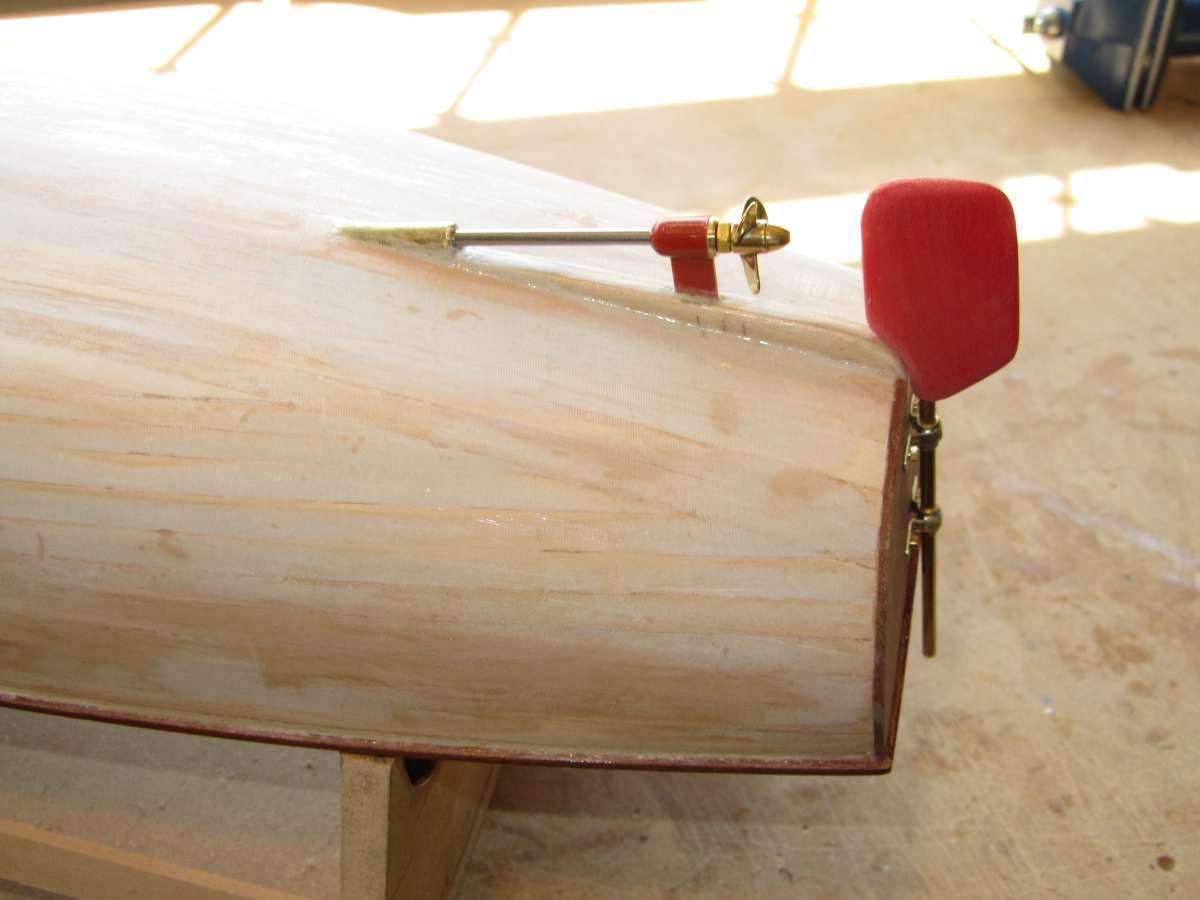

                                                    Still awaiting plan. In the meantime I have been doing a bit of online research. Silver Vanity was a 65 foot boat with two substantial diesels for propulsion. There were other ‘Silver’ designs in the pre war and immediate post war period and I have managed to find some illustrations of how the twin shafts were typically arranged. They all seem to have single rudders though.
                                                    The shafts appear to have been partially exposed with a short length of tube emerging from the hull with the propeller end supported by an A frame. It is completely understandable why Vic Smeed chose a single shaft for his Silver Mist  but I am still very much tempted to go for a twin screw version to give me a near scale model using the limit switch method described in my last post to improve the steering. It would be an interesting enhancement to the basic plan to which I intend to add more detail anyway.
                                                    If nothing else it will give me a unique model!
                                                    Twin Screw arrangement on similar vessel
                                                    #126066
                                                      Yeah, go for the twin screws Colin, it’s so much part of the design. It certainly is a lovely looking boat in my favourite colour-scheme of white and mahogany.
                                                      Use one of the engine noise devices that Richard reviewed in the last mag. as well. I’m thinking of using one in the Swordsman for starters. Wished I’d built that as twin screw now!
                                                      The prop shafts for your Silver xxxx are similar to as I’ve done with Faun. I have bought some collars to transfer the load to the end of the prop tube though the force will be pretty low as it’s only a slow craft.
