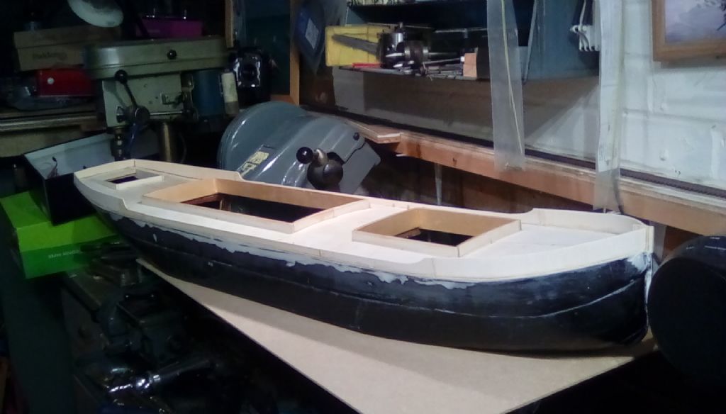

            Some progress today with the main and fore hatch frameworks, ready for the deck now 😀
            My lovely wife has mentioned decorating 😯 I knew it was to good to last !! Where is the paint 😈

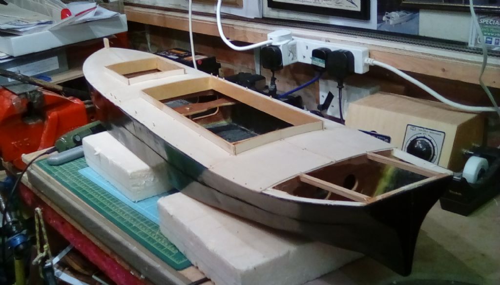

              The stern is in sight, all the deck panels of 1/16" ply have been cut to shape from card templates to get the joints right, the next functional part of the barge will be the rudder & steering servo.

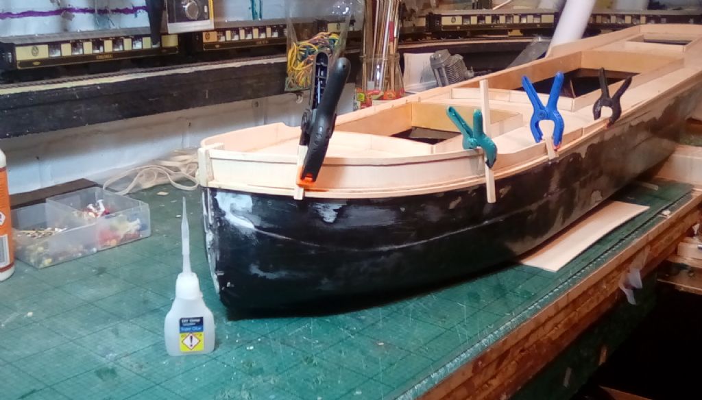

                  Today is do a bit on the Portlight day, and I have discovered an amazing advantage of Liteply 😄
                  Once the shape for the rear bulwarks has been templated in card and the shape cut out of 2mm and glued in position, it is possible to trim to the final required shape with scissors 😎 with the grain vertical very easy ✔✔✔,

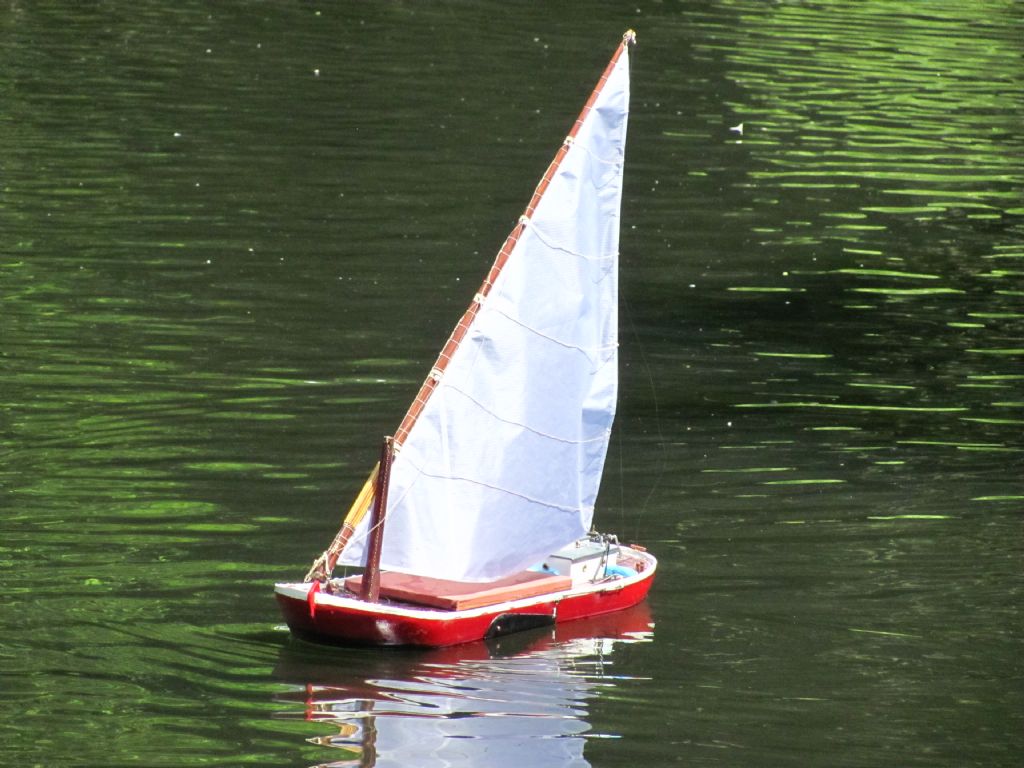

                              tomarack
                                @tomarack
                                Hi,
                                There is finally enough water in the lake in the park, but I have to wait again.

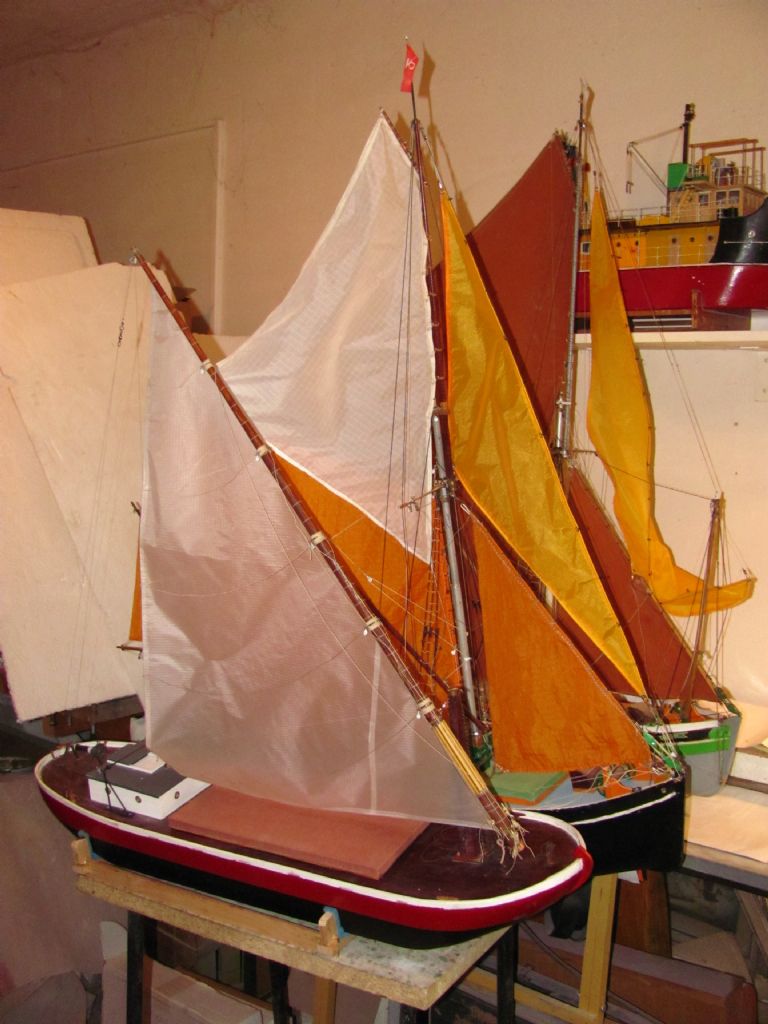

                                Yesterday I was preparing my model Caprice (Piscataqua river gundalow) for her first maiden voyage, but I have to wait. It's raining and the weather is damned cold, almost like March, not the end of May.
                                Nicer weather should appear hopefully next week. I'm quite curious how the model will behave on the water.
                                Pictured all my models – Caprice, tsb Gusty Cat and tsb Capricorn (all in scale 1:24)
                                Greetings
                                Tom

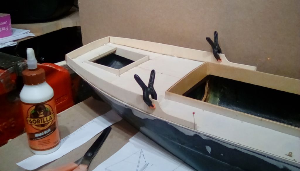

                                          Back on Portlight for a weekend break 😄 wooden building is my normal modus operandi, but a grp hull throws up strange challenges ! Fixing the 1/8" X 1 /8" obechi rubbing strip is one of those 😯 ended up with 5 minute epoxy to the bow, dampening the wood then clamped on then when dry superglue & 1 /32" brass rivets in pre- drilled holes.
                                          what a carry on ! Back to the wooden construction for the next one ⛵⛵⛵

                                              5 minute epoxy is good for fixing prop shaft tubes in place where they pass through a hull, but for actually holding in place anything that can try to unhitch itself, real epoxy (traditional, slow setting) is better. Thats assuming proper surface preparation.
                                              The rivets should make up for the basic weakness of the 5 minute epoxy and any ageing of the superglue should the obechi try to regain its original shape.

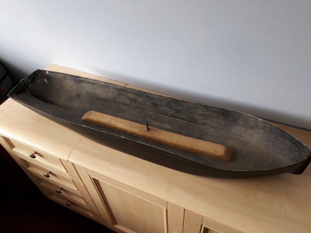

                                                    Dave Sansom
                                                      @davesansom26019
                                                      Hi Ray
                                                      In the front room, I don't think so

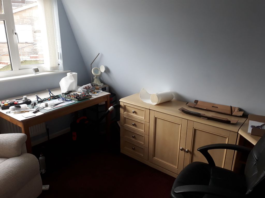

                                                      This is my play area upstairs
