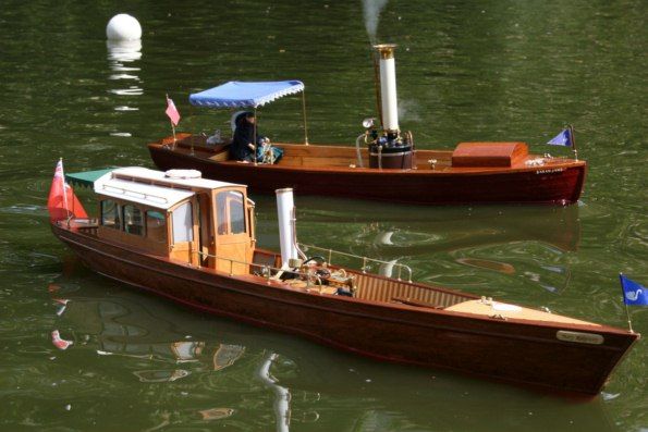

Testing shouldn’t be shied away from and there is no reason to be scared of a steam plant, so we can all continue to enjoy watching steam models on the pond and pass down this fascinating part of our hobby to future generations. Here are two steam powered launches to demonstrate just what makes it all worthwhile.
