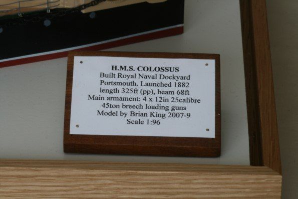

Traditionally these were always engraved brass, but apart from the expense, these plates are notoriously difficult to read, so I now produce my legend plates on the computer, print it on high quality paper and glue to a suitably shaped wood block, Photo 1.
You can experiment with the shape, size and material of the block, but the main point is it should be readable, but not over-intrusive. What information you put on it is up to you, but it must include the full name of the vessel and the scale of the model. It is also usual to give the main dimensions of the vessel. The length is often given as pp (between perpendiculars), which is the horizontal length between the after side of the rudder shaft and the point where the bow cuts the waterline at summer load line. The width is the widest point of the hull and the draught is defined as the vertical depth from waterline to the lowest point of the keel, or propellers if lower. Usually on a warship the details of armament are included. I always limit the amount of information so as not to make the plate too large, but do tend to include my name and the year(s) during which the model was built.

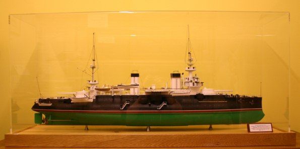

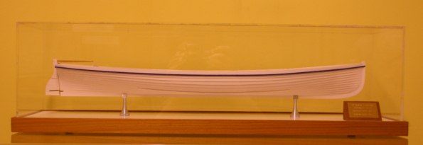

I would never consider entering a complicated model without a case, Photos 2 and 3.
Apart from protecting against the grubby index finger of urchins who persist in the idea that they have an eye in the end of the said digit, they protect against dust. Three day events are not too bad, but the dust accumulation over the nine day exhibitions we used to have was considerable. Whilst talking about cases, it is a good idea to remove static electricity from plastic cases by wiping over with a cloth dampened with clean water with a few drops of detergent added. Avoid any dry wiping as this will increase static and the amount of dust attracted. When building or ordering an exhibition case, do not ‘case’ the model too closely; always leave space around the model. This is a common fault amongst newcomers which results in the model looking like a trapped animal.
