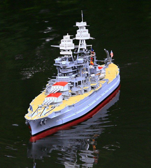

How best to join these? This is virtually the last task apart from the rudder tube installation as mentioned earlier. Well, in the end it was quite easy as the Revell plastic glue applied to the lip stayed liquid long enough for the two sections to be correctly located to each other and left to dry. Rather handily, the join is bang on the waterline, so black model aircraft trim tape provided the boot topping, hid the join and after three thin coats of clear matt varnish it would all seem to be waterproof with no leaks at the time of writing in July 2011. Photo 25 is of the completed model.
On the water
A small amount of lead ballast was fitted between the four propshafts in a domestic flotation test and that was it. The model is very stable, majestic and controllable, with the small propellers giving a surprisingly good turn of speed. She looks really good on the water, but is not a model for rough conditions. However it is perfectly safe on a model boat pond in normal average operating conditions. USS Arizona is noticeably quite stable in these conditions, Photo 26, in part due to the wide beam and deep underwater cross-section.
