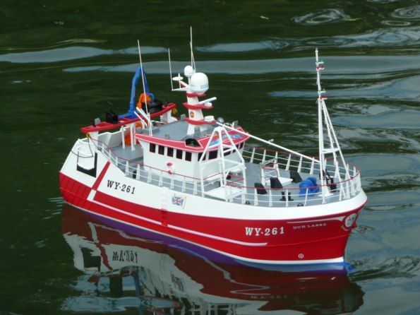

A calm day beckoned, the battery was charged and a range check performed before placing it on the water and with the sound system working, off she went, Photo 17. The propeller certainly ‘gripped’ the water very well driving the model forwards and astern very easily and with minimum revs, thus indicating that the motor and esc combination was about right. The rudder motion was positive, both forward and unusually for a single screw model, not at all bad when going astern either. The displacement of the model made it very stable. The motor was well up to the task with approx. 25mins on the water from the 6 volt 4 amp battery. Once retrieved, the model proved to be bone-dry inside.
