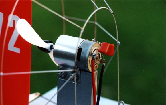

This ended up being the simplest possible design I could achieve. A balsa pylon was glued to the deck with some triangular reinforcement at the base. It is important that the pylon is tall enough to allow clearance for the propeller. The pylon was then given a couple of coats of dope to seal its surfaces.
The motor was secured to the top of the pylon using a thin aluminium strap held in place by two bolts. The strap ought not to cover the cooling slots in the side of the motor case. If the motor appears to be loose within the strap then some tape can be stuck around the motor case to produce a firm grip. A loose motor can be pushed forward by the motor thrust and result in the propeller fouling the mount.

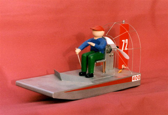

Full size airboats have prominent guards around their propellers for obvious reasons. Whilst not essential in a model, guards can save the fingers of inquisitive spectators and forgetful modellers. In this model, the guard also acts as the upper support for the air﷓rudder.
The prototype’s guard was made from three arches using soft steel wire. The first arch was made smaller than the other two arches. Bending the wires around suitable cylinders made the curved sections, I raided the kitchen cupboards for cans and containers. The ends of the wires were bent into a ‘Z’ shape before epoxying into holes in the deck.
Five lengths of wire were cut and bent to join the three arches. Epoxy could be used but I found soldering to be more convenient. The guard seemed to be a little too flexible at this point so two diagonal braces were fitted between the first and second arches. Two small wire hooks were soldered to the bottom of the first arch. As designed, this guard gives reasonable protection but more wires could be added if desired. Even more protection could be achieved by covering the guard with an open plastic mesh. It’s up to you to assess the risk involved in where and how you plan to sail this model.

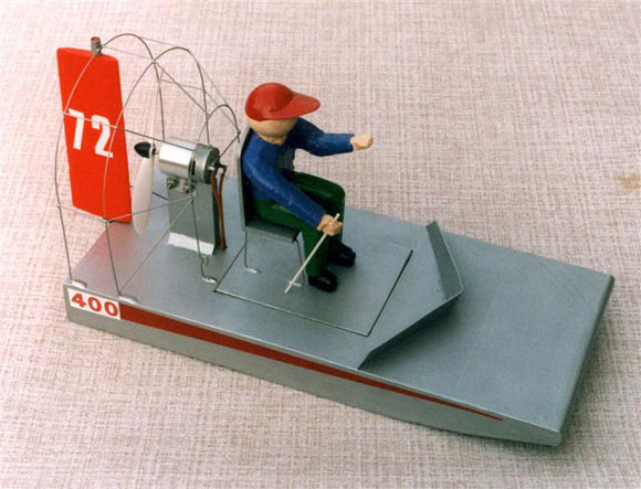

A simple seat was made from balsa sheet and wire, then glued to the removable hatch. The idea of using a commercial ‘toy’ figure to man this model was quickly discarded due to excessive weight. This lead me to make my own driver from scraps of expanded polystyrene. The torso, legs and arms were cut, carved and glued together to create a reasonable sitting posture. The head was made from a table tennis ball with no attempts at facial features although I did add a card visor to suggest a baseball type of cap. The figure was sealed with a couple of coats of domestic emulsion paint, which luckily suggested a flesh tone for the bare hands and head. The clothing was painted on. The result might not be anatomically perfect, but it weighs and costs next to nothing.
The final item added was a card spray deflector to the deck just ahead of the access hatch and sealed with a couple of coats of dope. This should avoid any water thrown over the bows from reaching the hatch.

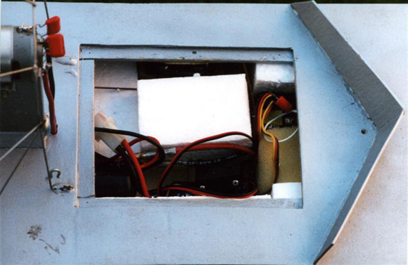

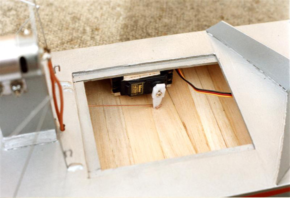

The plans show a suggested layout of the internal items. There is no reason why you have to follow this exactly, the only essentials are that the R/C equipment can function reliably and the model balances correctly. To keep the wire linking the rudder and servo arms as straight as possible I fitted the servo on its side. It was secured using packing pieces between the servo case and the hull deck/bottom sheets with spots of a latex based adhesive. This might sound odd but gives you a simple and secure mounting which can still be cut away if you ever need to remove the servo. The model currently has a small Hitec HS﷓80 servo but a standard servo has been used successfully in earlier testing. The wire linkage runs through a hole made in the deck. To achieve some water resistance a length of plastic tube was fitted into this hole. The rudder movement required is about 20 degrees either way, a movement of about 1/2in (13mm) either way at the rudder trailing edge.
The receiver, speed controller and battery pack were secured into the hull using blocks of expanded polystyrene foam. This is a very lightweight method and provides some buoyancy in the event of any accidents. The installation of these items should be such that they are secure as any movement whilst running could seriously affect the model’s handling. Likewise, it is important to be able to easily remove and replace the battery pack. In early testing a standard speed controller was used, this featured reverse, which was found to be of little use. The model now uses a lighter ‘forwards only’ speed controller of the type used in model aircraft. Whatever type you use it must be capable of handling a continuous current of at least 10 Amps and have a BEC feature to avoid the extra mass of a receiver battery pack. The receiver aerial wire was run through a small hole in the deck just behind the spray deflector. Using a small elastic band, it can be attached to the top of the prop guard. This should give you adequate radio range provided the aerial cannot foul the propeller of course!
The best propeller to use on this model could need a little experimentation. Model shops stocked for the electric flyer should be able to offer a small two bladed Gunther plastic prop, which is perfect for Speed 400 motors. Failing that I would recommend a 5 to 6in (125 to 150mm) diameter by 3in (77mm) pitch plastic propeller. This will need a suitable prop adaptor to fit the motor shaft, the Gunther props being supplied with a neat push﷓fit spinner. By the way, do fit the propeller the right way around as the motor is used in pusher not tractor mode.
The hatch should still fit securely into the hull opening. To avoid it departing the model in high﷓speed manoeuvres I suggest using an elastic band as a ‘seatbelt’ around the driver figure. This band can be run between the two hooks shown on the front arch of the propeller guard. The model ought to run with the decks reasonably dry but for the first runs some self﷓adhesive tape over the deck/hatch joint might also be a good idea.

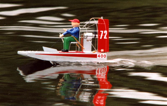

Do not let the small size of this model fool you, it needs a lot of space to operate safely at full speed. It take both time and distance to turn this model and something like a 100 foot (30m) square water is a sensible minimum for the first runs.
Ideally, you should start with dead flat﷓water conditions, no wind or waves. In practice, you will probably have to settle for calm conditions with only gentle undulations moving across the surface. This model can cope with rougher conditions, but only after you have learnt to operate it first. The balance point needs checking first. The model ought to balance around the rear edge of the access opening so that it sits in the water with the stern lower than the bows. Every new model should be treated with care in its first run; to be honest we ought to start every sailing session the same way. Just advance the throttle stick half way and check the rudder response. It should do what you want but will almost certainly appear to be sluggish as it wallows around. If everything is OK, then aim it towards the middle of the water, away from other models, and hit full power. It might take a little time as the model accelerates through the ‘hump﷓speed’ and the hull lifts onto the plane, after which the resistance falls and speed dramatically increases.
The next thing to do is to check out the rudder control. Only apply about half rudder movement and note that the model yaws or slews in the desired direction but appears to keep travelling along the original path. The flat hull bottom has no keel with which to ‘grip’ the water and prevent this sideways motion, the model should however start a flat gentle turn. Experiment with turns in both directions and this characteristic of sliding around ought to become more comfortable. If too much rudder is applied for too long then the lower edge of the hull can ‘dig in’ to bring the model to a sudden stop in a shower of spray. So far, this has always been spectacular rather than dangerous.
The model will probably need some trimming to get the best handling. With the model running straight, it should be slightly bow high with perhaps a light slapping sound as the flat bottom hits any wave crests. If the model oscillates longitudinally (proposing), that is the bows noticeably rise and fall, then some internal weight must be moved forwards as the centre of gravity is too rearwards. If the model runs with the bows low, thus risking diving underwater, then some weight must be moved aft. Any list to the side at speed, probably due to torque reaction from the propeller, can be countered by moving the battery pack slightly towards the opposite side. If your controller has reverse then never use more than a fraction of full power. Moving astern to fast will push water over the transom and swamp the model. Steering astern is virtually impossible so reverse power is something best left for emergencies only.

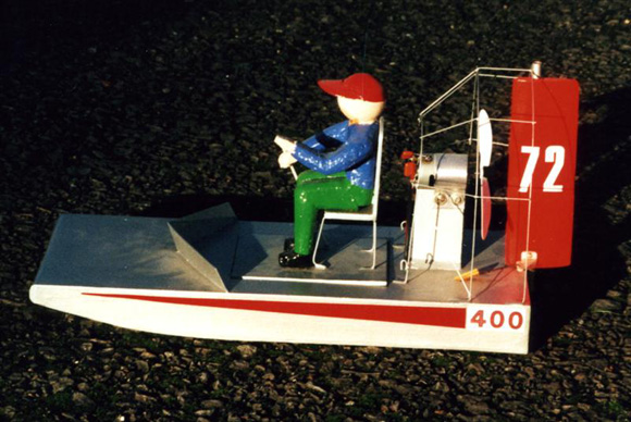

Like many models built for some quick and cheap fun, Skimmer has proven to be far more successful than it deserves to be. The handling is different from the usual R/C model boat, no tight turns but lots of graceful wide sweeps across the water. If you were thinking of trying a hovercraft, this model would give you some handling experience.
One point to take note of is that if the motor is opened up whilst the model is on any smooth flat surface, it will try to move. It has tried to leap off my workbench and scoot across the carpet but so far with no damage. Which makes me think about trying it on some smooth snow? A final idea might be to try some club airboat racing. Several airboats tearing around a simple course ought to be exciting for the competitors and quite a spectacle for the general public.
