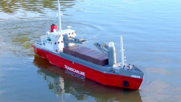

Finally, on the 7th Nov 2010, after 195 hours of construction work, the Beer Can Boat was finished, Photos 10 and 11, its all up weight now being approx 8.5kg. including drive batteries etc. However, a further bath test revealed that the higher centre of gravity and weight increase from the deck containers and cranes, required a 0.25kg lead keel to be fitted externally to ensure a balanced floating model.
On the water
The only remaining task was to test the sea keeping capabilities of this somewhat modified version of Glynn Guest’s Emily May. This was finally achieved at our Solent RCMBC sailing venue of Setley pond in the New Forest on the 8th November 2010 and the result can be seen in Photo 12.
